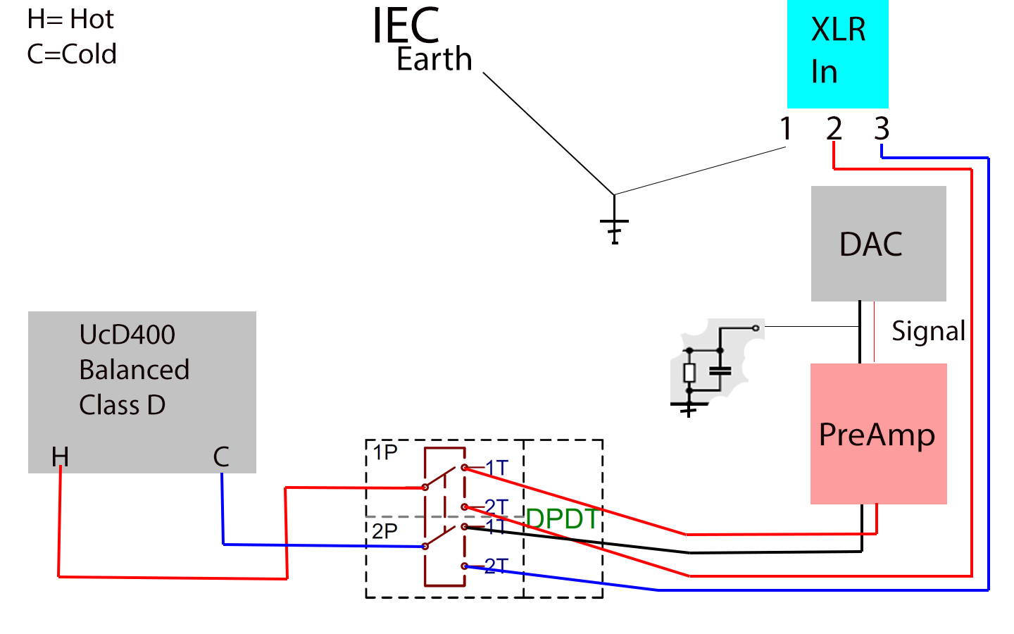

Have been reading up for days but feel I would need much more electronics knowledge than I do. It seems to be a popular subject ... grounding!

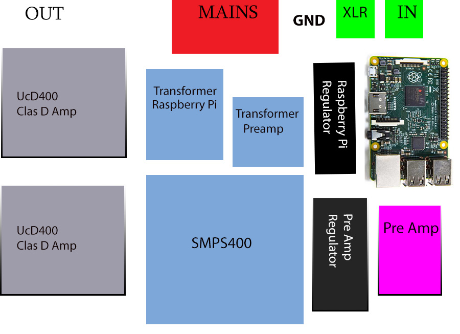

Attached is an amp I am building. I have two transformers and an SMPS supply. I will be source selcting via switch between auxiallry XLR input and an internal raspberry pi hifiberry - unbalanced.
My first question is whether the UcD module needs an earth ground connection to signal ground when using RCA? Or will it just amplify the difference between signal ground and signal?
I ask this because Hypex have instructions on the design of the switch between XLR and unbalanced - have attached my understanding of this switch and it explicitly states to connect RCA signal ground to chassis.
I get more confused when it comes to the regulators for the raspberry pi and pre amp. If I connect the negative output of the Pi regulator board to chassis then I have referenced signal ground of the Pi hifiberry to earth? is this true?
There then seems little point in referencing the hifiberry output gnd to the chassis as this will already be at chassis ground? Is this true?
When the hifiberry signal passes to the preamp (Simple NE5534 buffer) - does it matter if the NE5534 supply is floating? I think it does... So would this mean I need to tie the NE5534 regulator to chassis also?
And then (you can see my confusion) Does the SMPS400 need grounding too? I undertstand that I can float this also as I have spacers bewteen the SMPS and chassis - BUT - apparently the UCD Modules are grounded through the heatsinks?
Which leads me back to my first point - should I be floating the entire unbalanced signal - Pi Hifiberry - Preamp....
Sorry for the mess I've just dumped into the forum but any answers to any of the above will help enormously as my electronics education is not keeping pace with this amp build!

The chassis has three purposes and none of them affect the audio operation.
a.) the chassis holds the electronics.
b.) the chassis/enclosure screens the electronics from external interference
c.) the chassis takes fault current via PE to Earth and blows the mains fuse.
Pin1 is a screening part and goes direct to chassis at the connector. It allows the cable screen/shield to become an extension of the enclosure.
For Safety the exposed conductive parts should be connected to the protected chassis. This is not an audio performance requirement. It generally makes audio performance worse. It is a safety requirement.
The chassis should not be used as an Audio ground.

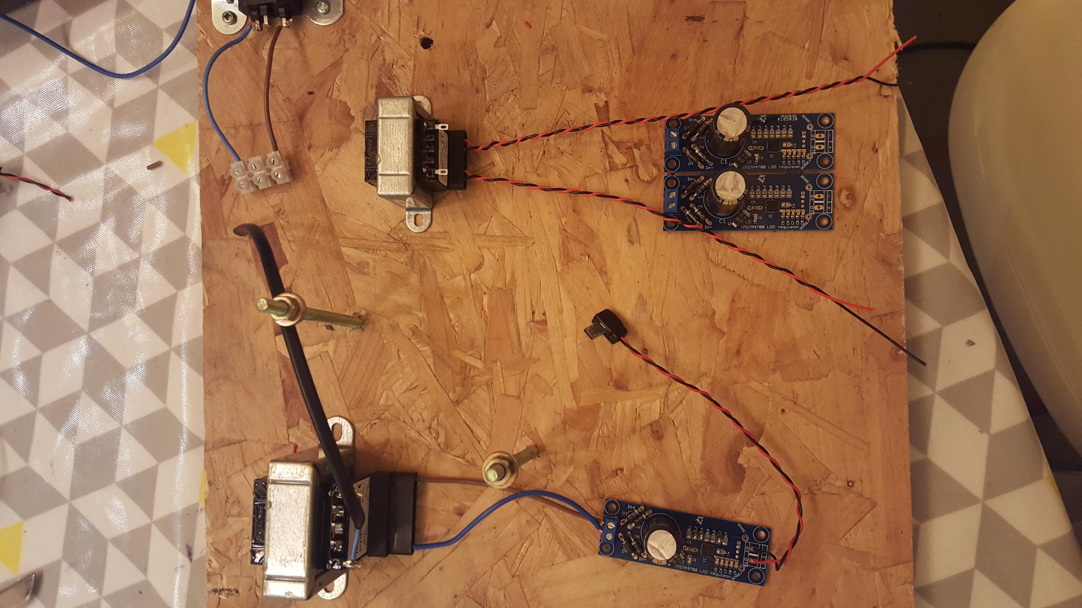

BUT I am still unsure of my separate internal Pi (DAC and preamp) source signal. This is unbalanced and one transformer powers the Pi (DAC) and another tansformer powers the preamp (Simple ne5534 buffer)
I have attached a pic (probably unnecessary) of the separate supplies for this audio circuit, you can see the two regulator boards, one giving +/- 5V for the Pi and DAC and the other is dual rail running from two separate secondaries as both regulator boards are positive. I intend to tie these two boards in the middle to give me my common gnd.
My question is.... if I tie these supplies to the the chassis after regulation then doesn't this mean that my audio signal is referenced to chassis ground?
If I don't tie them to chassis and leave them floating then does it matter that both the Pi (Dac) and the preamp will be at different potentials?

No.
The power supply voltage is referenced to the power supply Zero Volts.
That PSU Zero Volts goes to the client circuit. It does not go to the chassis/enclosure.
Remember that the single connection from PE to your exposed conductive parts is a SAFETY requirement.
This Safety connection has NOTHING to do with circuit operation.
The circuit will work without an enclosure. It only need an enclosure for those three reasons I listed in post3.

This is from the Hypex website:
Install a DPDT switch to connect the hot/cold inputs of the UcD module to either pins 2/3 of the XLR connector or to the signal and shell contacts of the RCA connector. Note that pin 1 of the XLR connector is not switched, but remains hardwired to chassis. The RCA shell contact also remains hardwired to the chassis. This means that when the DPDT switch is set to RCA, the cold input of the UcD module is grounded via the RCA connector.
Is it not necessary to connect the RCA shell (audio ground / common) to chassis so that the cold input of the UcD module is grounded via the RCA connector?

Thanks Andrew and Dimdim, and Phew! I am enlightened by the doc:
http://www.hypex.nl/docs/appnotes/pin1_appnote.pdf
I will follow AES48 rules. My limited understanding of electronics was not enough to see how I could float my entire Raspberry Pi and Dac and Preamp source that is contained within the amp enclosure. Of course I will just treat it look an RCA input and I will follow the digram in 4.5 of the pin1_appnote.pdf.
So, I have two transformers supplying my TPS7A4700 regulator boards, the common outputs 0V of these will be connected together so that both supplies for the Pi Dac and Premamp are at the same common voltage.
And then the only connection made to chassis by this audio ground is through a resistor capacitor network as shown in my updated diagram below. And this is to ensure that the common ground is at least somewhere near the operating range of the Amplifier for differential amplification.
Can someone confirm this? And would it be an idea just to make this RC connection to chassis at the common point where I am joining the two regulator OV's to? Then there is no need to make this connection from the signaling cable that I use to connect the signals up internally?
And can I just check my parts bin for values close to 100nf and 100 ohms for the RC connection to chassis?

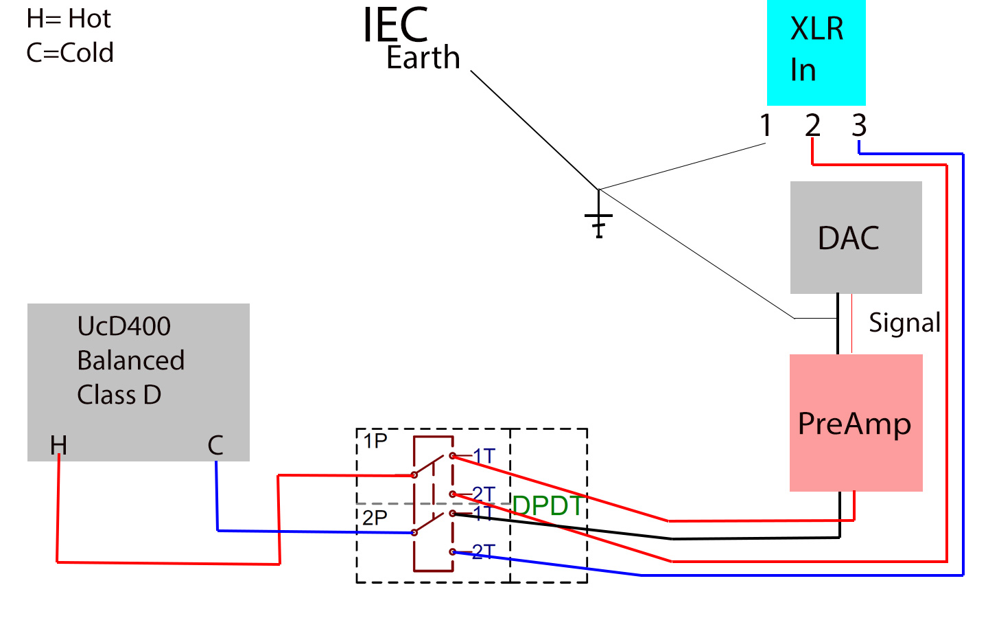

Still no.
Connect the Mains PE direct to chassis permanently and near the IEC input socket.
Connect the XLR Pin1 direct to chassis at the socket. Hypex correctly says
The best solution of course would be to open the faulty box, disconnect pin 1 from the circuit
board and connect it to the chassis with the shortest possible wire.
That fixes the problem at its root.
Follow that, The important part is shortest possible wire. It MUST be very low impedance and that is particularly referring to inductance.
If you want/need to make a safety connection from Audio ground to Chassis to comply with
"all exposed conductive parts should be connected to the PE protected chassis".
then that route MUST be able to pass Fault Current to PE.
That fault Current can exceed kA (>1000Apk).
Any resistor in that path will blow up and break the safety connection.
You must use either a direct wire connection, or use a Disconnecting Network that you know can safely pass that Fault Current.
