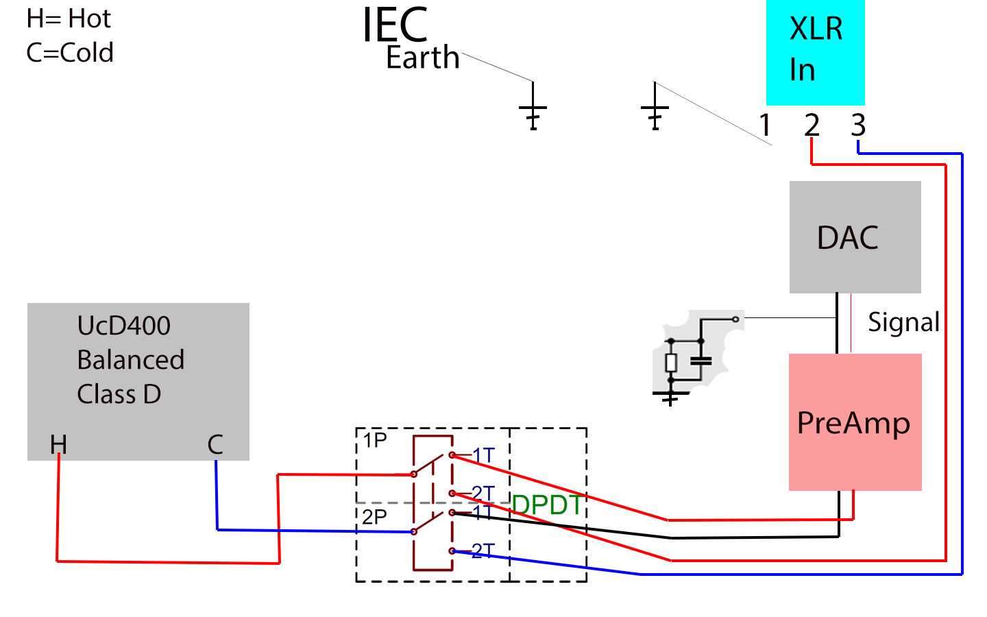

Sorry, I am still unclear now, thought I had it. I have made the distinction between where IEC and Pin1 connect to chassis and separated them as per the new diagram and your advice.
I don't need the safety connection from audio ground to chassis that you describe. I DO need to know how to reference the audio ground to allow my switch to work as per HYpex instructions. I thought we were there and agreed that a simple RC to chassis will help this as per dimdims post.
And my question is where to make this conection, I always thought that the 0V of my supplies will become the audio ground?

That is how I read Dimdims post too, but he tied the audio ground to chassis through a simple parallel RC network!
My questions are still:
1. I am tying two supply Ov's together so that the DAC on the Pi and the preamp share a common ground? This seems necessary and logical to me... correct?
2. I am tying the shell (audio ground) to chassis via a simple RC network as per hypex instructions - this is not entirely for safety but also to keep the reference voltage within the amplifier range, is this correct and do I need to strictly adhere to 100nf and 100ohm?
3. Still trying to figure this out.... audio ground for the Pi DAC combo will be the same as OV supply, therefore if I tie the regulated Ov outputs together as per question 1, then I can presumably tie this point to chassis through the RC network and only do this once as the audio signal will now have that connection to chassis as per question2?
sorry for so many questions but I feel I am getting there slowly,
stu

And then the only connection made to chassis by this audio ground is through a resistor capacitor network as shown in my updated diagram below. And this is to ensure that the common ground is at least somewhere near the operating range of the Amplifier for differential amplification.
No. Any connection to chassis should be for safety reasons only. You don't want the chassis to be part of the audio circuit. You need to be clear in your mind: 'audio ground' is the voltage reference point for audio signals (including unbalanced inputs), 'safety ground' keeps you alive. The only thing they have in common is the misleading word 'ground'.
A 100 ohm resistor has nothing to do with safety, as it won't pass a fault current. It appears that the Hypex instructions are based on the false idea that chassis should be the signal reference point. What you should do is connect the DAC and preamp signal ground to the power amp signal ground. Then, as a quite separate issue, you should connect the signal ground for the entire circuit to the safety ground, possibly via a loop breaker.
Ok, can I tie the common 0V from my two regulated supplies (one 5V for Pi Dac and the other dual +/-15V for preamp) all onto the UcD400 ground?
I read somewhere that the UcD modules are grounded to chassis anyway by way of their heatsinks?
Maybe this is why Dimdim achieved no Hum issues by referencing his unbalanced circuit to the chassis via the RC network

Not necessarily, since the module has balanced inputs which go into an instrumentation amplifier. As drawn, the signal ground of the preamp goes to the cold input, not to the ground of the ucd module which is left unconnected.
Unless of course, he tied the OV of the preamp and DAC to the OV of the UCD PS.
If the balanced inputs are implemented via a transformer then the various '0V' do not need to be connected. If via an instrumentation amplifier then some connection will be needed to keep within the valid input range. This connection has nothing to do with the chassis.

Thanks DF96, am getting there on answering my own questions but lots of conflicting info, and I'm sure its all mostly correct but my confidence is not quite there yet!

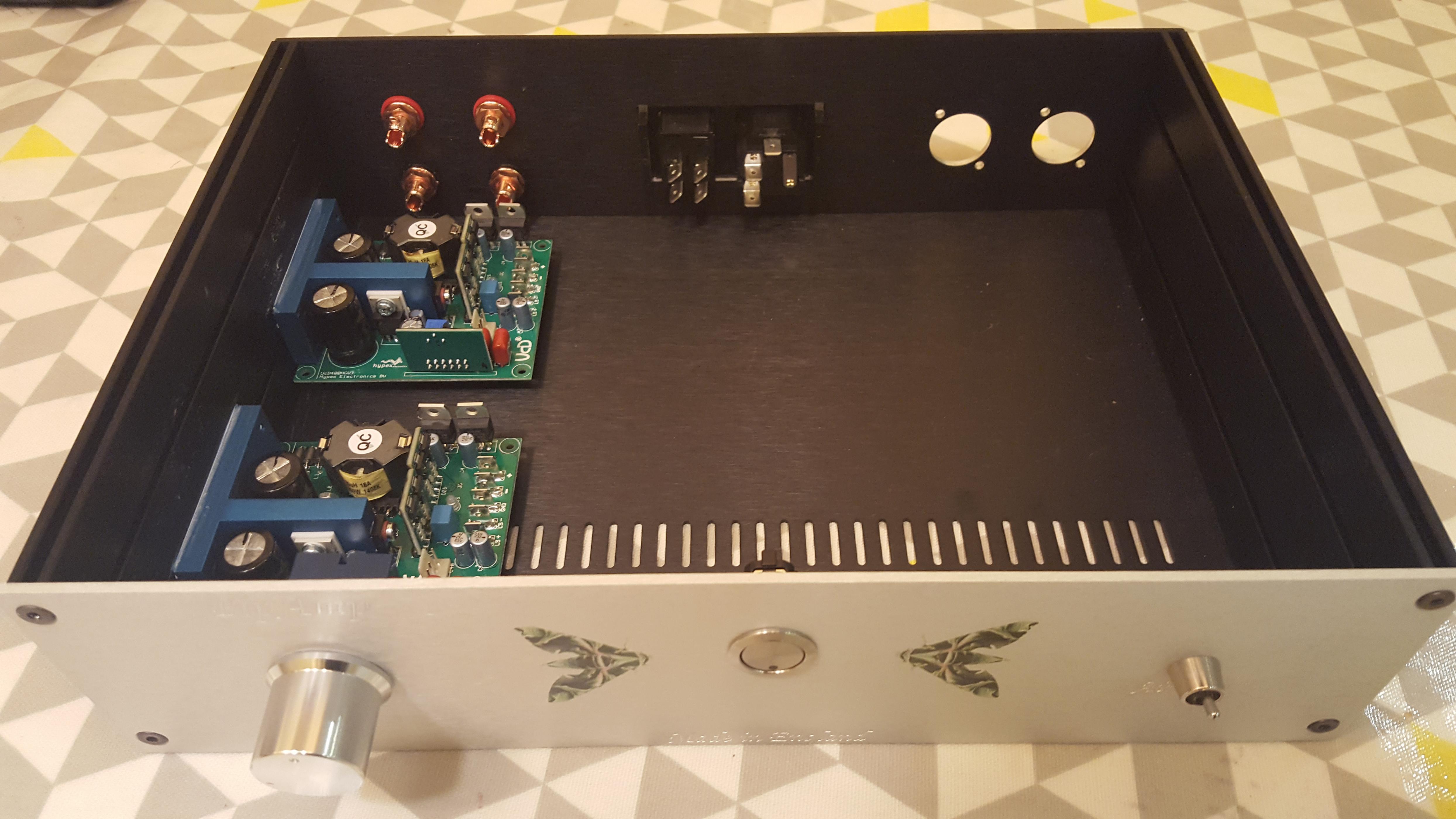

I'm going to connect XLR pin 1 to chassis very near XLR
I'm going to connect IEC PE to chassis at another point near IEC as I am a noob and have no chance of achieving class II safety regs
I'm going to connect 0V output of regulator boards to 0V of SMPS400 supply
I will not connect my internal RCA circuit to chassis as per HYpex recommendations ( I think they recommend this only if designing class II insulation which is where some of my confusion has originated)
My 4pDT switch will switch between either 'hot and cold from XLR' or 'RCA Signal and RCA Ground' into the Hot and Cold inputs of the UcD400
Just read Your post 00940, Hypex gave me enough plastic spacers to mount the SMPS400. I have read that some people use one metal spacer to provide connection to chassis, I have also read that the UcD400 achieve chassis connection via their heatsinks, will ping it out with DVM to see if the modules are grounded to chassis. In which case I will just tie the 0V regulators output to chassis with 100ohm and small cap in parrallel
