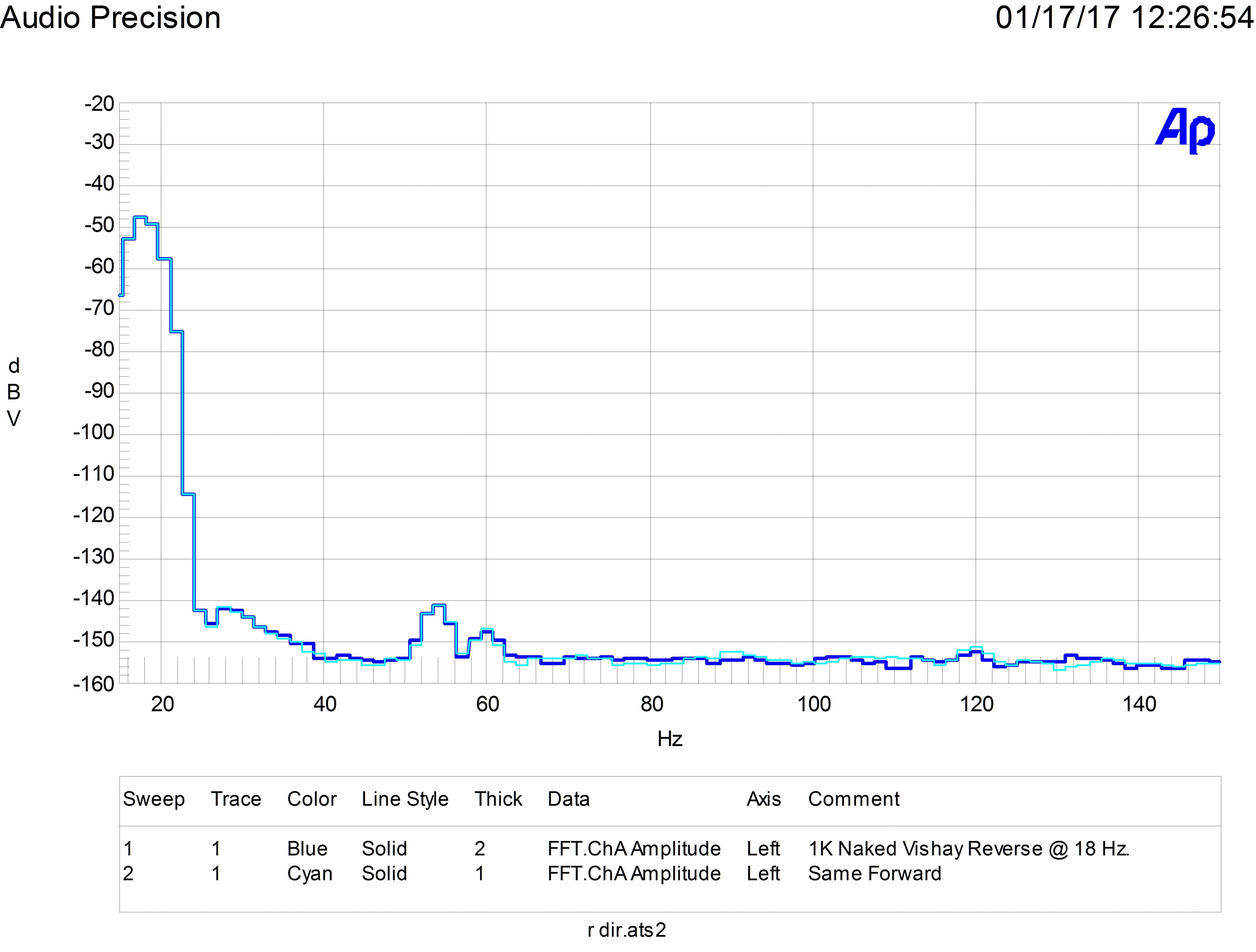

Attached are my best shots showing the forward and reverse THD of naked Vishay bulk metal 1,000 ohm resistors. 0 dB is 5 volts across the resistor under test. Using matching resistors in a bridge cancels the common mode signal and only puts under 7 mV into the AP system 2.

Those two graphs look remarkably similar. Obviously your experimental setup is not sufficiently sensitive to show such a gross difference, which is obvious by ear to any true audiophile - and his wife in the kitchen.
I would have started by doing two measurements, 5 minutes apart, with the same orientation.

You are welcome to try it. I did quite a number of runs under different conditions, this is the set that shows the most difference.
Please describe your test setup in full. Its very interesting. A picture would be nice.

No Sir, YOU should have done that. Your shown curve is meaningless without baseline measurements with the same DUT orientation.

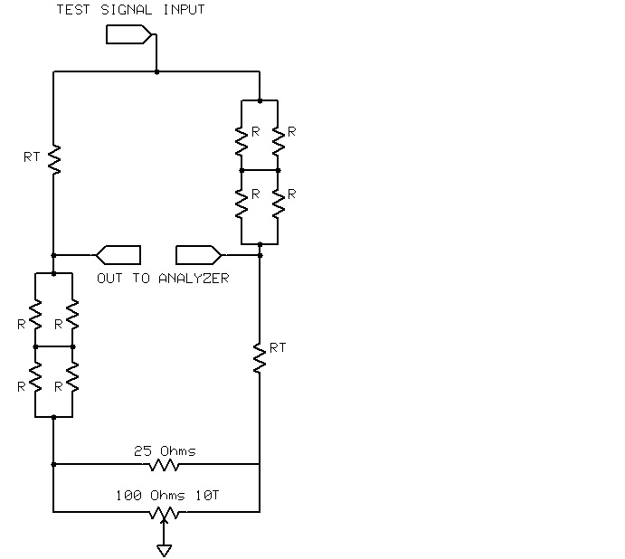

Attached is the basic resistor test. For normal testing ten resistors are used in a bridge. If the resistors are very similar, then two parts of the bridge have only half the voltage across their resistors, thus lower distortion.This process uses reciprocity to determine the distortion.
In this test only four resistors were used. The only before and after change was the direction of only one resistor.

When the source of distortion is the temperature coefficient, then all resistors have increasing distortion with lower frequency. The bulk metal resistors are even worse for this. As only four resistors were used for this test, if they all had the same increase in distortion this would have cancelled. It did not showing the resistors are a bit worse for that than many others.

If you look at the test shown note the excitation frequency of 18 hertz for both forward and reverse. It is the same level. As it starts at 5 volts and is down by almost 50 dB this indicates resistors all matched to within .5%
Now all the resistors are 1,000 ohms. So on the left of the metering point you have 1,000 ohms going to the generator "High" send and the same to the "Low" send allowing for the generators source resistance and the same resistances on the other side there is an effective resistance of around 1,050 ohms. This should produce a thermal noise level of around 4 nV per root hertz. This would be around -160 dB per root hertz re the 5 volt 0 dB reference. As the plot is not averaged for infinite time the noise base line is a bit higher and varies a bit. Throw in the limits of the AP System 2 and that is why the lower thermal noise limit is only around -155 dB.
Now look at the third harmonic distortion at 54 hertz. The peak levels are exactly the same. There is a slight difference at the 60 hertz line noise frequency. That is most likely due to the floor noise, as it is not likely to have any other source.
Now look at the line width spreading, some of that is the FFT limit and a bit would be to low frequency noise modulation. There doesn't seem to be much effect from the 1/F noise.
As the input signal is just under 7 mV and the useful range of the FFT system is better than 125 dB all of the data is quite reasonable.
IT SHOWS NO DIFFERENCES other than from noise. Apparently you missed DF's joke.

The trim is for nulling the excitation frequency when using lower precision resistors. It was used to test 1,000 ohm samples.
For testing resistor directivity you only need 4 resistors as well matched as possible. You must solder the resistors. I use an aluminum enclosure that has XLR connectors for inputs and outputs.
You use 10 resistors to measure the absolute distortion. Here you are looking for the relative distortion.
Using a breadboard for this test would be a good way of testing the distortion caused by the breadboard contacts. To measure something requires a bit more than hooking up a few components and reading a number off a meter. I suspect Simon spent a long time optimising his technique before he could get reliable measurements.
