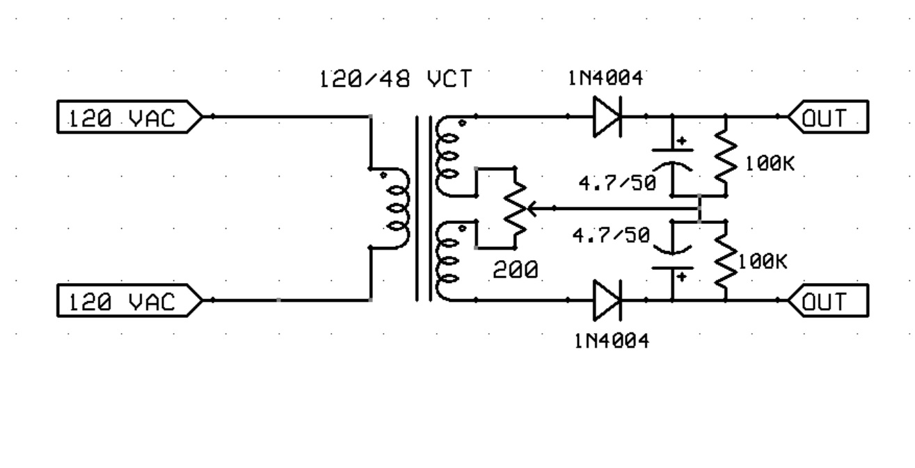

As to symmetrical analysis you just might be shocked to find out that using a discriminator detector with a transformer you can measure asymmetry on many power lines. Attached is a sample circuit. Plug it in one way and it may read a positive value, reverse the AC line connection and the value switches polarity.
