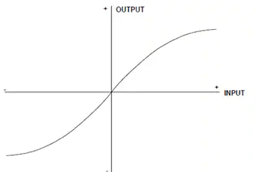

Yes, op-amps are extremely versatile, and can do everything from precisely calculating definite integrals of mathematical functions, to providing precise signal conditioning inside medical electronics. They are an absolutely amazing invention, and have reached a level of perfection that makes them one of the huge shining stars of contemporary analogue electronics. They have thousands of applications where they are the perfect solution to a engineering problem. No sane and well-informed person would say otherwise.
But if you simply whack a couple of feedback resistors around an op-amp, set it for even a relatively small voltage gain (+20 dB), power it from 9V, and feed it a raw e-guitar signal, it will clip harshly for a big part of each note.
Raising the power supply voltage to +/- 15V may keep that first stage from clipping harshly, but it only transfers the problem on to subsequent stages of the amplification chain. If one or more of those stages is a tube amp that overloads gracefully, you can end up with good sound. If those later stages are just bigger and badder op-amps (all modern solid-state audio amps are just bigger op-amps), then the harsh clipping problem will simply occur in the power amp instead of the preamp.
I proved, quite clearly, in a recent thread, that this problem exists. I've been hearing ugly gritty harsh clipping from solid-state guitar amps for decades, though I didn't know exactly what I was hearing, or why it occurred. Only recently, I finally figured out exactly what I was hearing. Now I've provided the explanation, along with objective evidence. There is no longer reasonable room for doubt.
For some of us, that sort of harsh op-amp clipping is a very unpleasant sound.
Musical tastes vary widely, and I'm sure that somewhere, there is a guitarist who loves the sound of harsh clipping, and she/he may even have an audience that enjoys that sound. All good wishes to them, but it is not a sound I ever want to hear.
Are there ways to tame the harsh clipping inherent to high-NFB amplifier stages? That is a perfectly valid question, and well worth exploring. It is already being explored on other current threads on this forum.
But simply whacking standard high-NFB non-inverting or inverting op-amp preamp blocks, followed by a high-NFB power amplifier, will produce the sort of gritty clipping sounds that sound so very unpleasant to me (and to many, many other guitarists).
To avoid that, you need stages that overload gracefully, without harsh clipping, somewhere in the chain between guitar pickup and speaker. Doesn't matter how you accomplish that - whether you use tubes, JFETs, BJTs, or eye-of-newt-and-toe-of-frog. As long as you find a way to create graceful, gradual, progressive, soft clipping, there is a good chance at success.

I have no idea. But I can hear that it does.How does a tube amp removes nastiness?
It's not a subtle effect, either. Stevie Ray Vaughn and other many other blues guitarists of his time could have run their Tube Screamer straight into a solid-stage rack-mount transistor guitar amplifier if they wanted. None of them ever did, because that combination sounds absolutely disgusting.
Same story with delay. How does delay after a Tube Screamer or, even worse, a Fuzz-Face, remove that horrible harshness? No idea, but it is very easy to hear that it does. There is probably a complicated mathematical convolution function that would explain why.
Same story with reverb after clipping, either alone, or in conjunction with delay. Reverb removes the harshness. Is this an actual electrical effect in the signal? Or does it happen in the listeners ear/brain? I have no idea. But there's no doubt that reverb after distortion reduces audible harshness.
