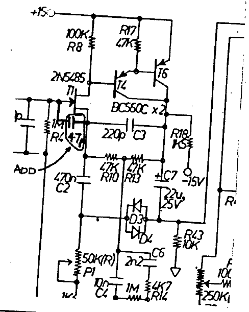

Here we have the all-FET Randall Guitar Preamp from their famous RG100
index.php
Funny thing is that clipping on the Dirty channel is made from back to back Zeners or Diodes!!!!, which is an oxymoron 😱
FWIW distortion is buzzy, the trademark sound of Thrash Guitar players, notably Pantera´s Dimebag Darrel, who famously said "I had been using Tube amps, but was instantly fascinated by its buzzsaw sound" 😱
It also uses a constant current Power Amp which enhances the effect.

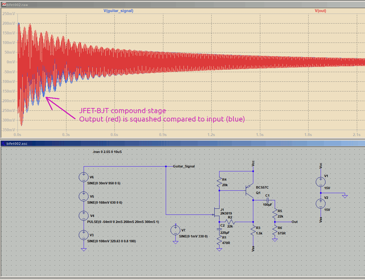

As some of you know, I recently developed an LTSpice circuit that delivers a simulated guitar signal, closely matching one of the real guitar captures on Rod Elliott's website. Details are in another thread ("Unwanted clipping in solid-state e-guitar preamps", here: https://www.diyaudio.com/community/...pping-in-solid-state-e-guitar-preamps.391513/ )
The reason I developed that simulated guitar signal, and posted details and a working LTSpice simulation, was to allow all of us to get better, more realistic results from LTSpice simulations of guitar amplifiers and preamplifiers. Instead of testing with a simulated sine wave, we can test with a signal that reveals how the circuit will behave with an actual guitar plugged in.
Here's an example. The attached screenshot shows the result of connecting that simulated guitar signal to a simulated JFET-BJT compound stage (straight from the Traynor Bloc 100G schematic that Shanx posted earlier in this thread).
I've scaled the red trace (using R5/R6) so that it exactly overlays the blue trace if you feed the JFET/BJT pair a very small signal, such as 1mV peak. As the signal amplitude gets better, the JFET "squashes" the signal, so for big input signals, the output no longer exactly overlays the input.
Overlaying the red and blue traces allow us to see exactly what's happening in the JFET/BJT compound gain stage.
As we suspected, we can now see that the output signal from the JFET-BJT pair (red trace) is slightly squashed compared to the input signal (blue trace), for about 500 mS at the start of the note.
While running the simulation, I zoomed into the graph, and you can see that the negative peaks of the red signal show no signs of hard clipping at all. In fact I can't really see any change in the shape of the waveform peaks when comparing the red and blue traces. The only obvious difference is that the peaks of the red signal have been gently squashed, i.e. amplitude is slightly reduced.
This is the effect of only one single JFET-BJT stage. In a guitar amplifier, the signal would go through several such stages, and each one would add a little more gentle peak squashing.
This (Traynor Bloc 100G) is also just about the first time I've seen an intelligently designed JFET bias scheme used in a guitar amplifier. The use of a negative supply rail, along with negative DC feedback from the BJT collector, makes the circuit forgiving of JFET parameter variations.
Back in the early 1980s, I came up with almost this exact idea in my very first JFET guitar onboard preamp. It used a single supply rather than +/- 15V, but it used the same type of DC feedback from the collector of the PNP transistor to the source of the N-channel JFET.
I haven't seen this circuit used elsewhere until now.
Unlike most of the JFET guitar circuits on the 'Web, this one (Bloc 100G) will actually bias itself reasonably, and work properly, if you plug in any reasonable JFET.
The Randall R100 schematic Fahey posted shows the more typical approach. The circuit will only work if you use JFETS selected to have a very narrow spread of characteristics. A big manufacturer like Randall might have been able to order pre-sorted JFETs straight from the manufacturer. But a DIY electronics enthusiast using store-bought JFETs would probably find that the circuit would not work properly.
All in all, I definitely give the JFET-BJT compound stage a thumbs-up. It's definitely worth investigating more closely.

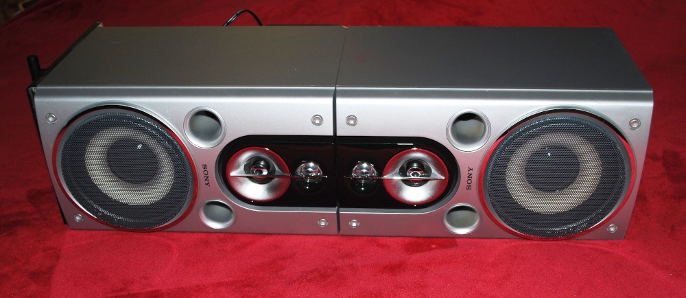

Currently most of my free time is going into building a little P.A. powered speaker for use at our weekly music jams.

At a jam this summer, one musician showed up with one of these: https://yorkville.com/loudspeakers/excursion/product/exm-mobile/

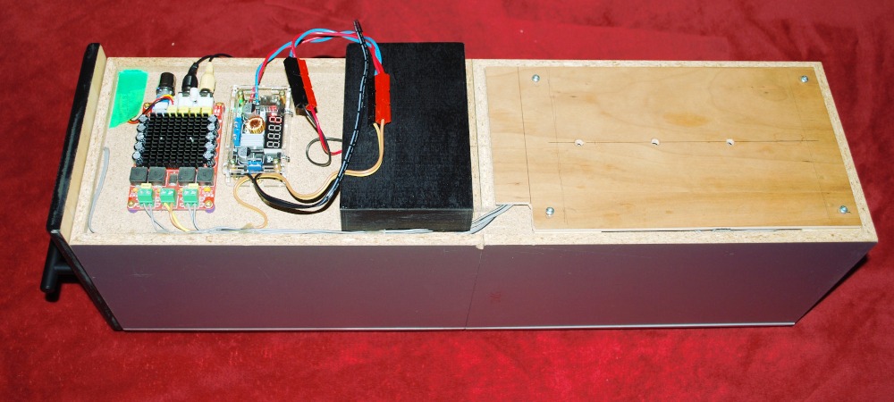

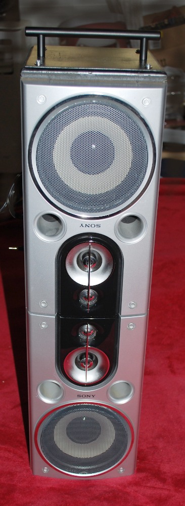

This is something I've been wanting for years - a battery operated, compact P.A. speaker with really good audio quality, capable of enough SPL for use at a typical small jam, using good-quality drivers. No nasty-sounding piezo horn tweeters, no nasty-sounding compression drivers. Compromised on maximum SPL capability, rather than on sound quality.
I liked the sound quality of the little Yorkville immediately, but not the price: https://www.long-mcquade.com/97309/...e-Sound/Excursion-Mini-Battery-Powered-PA.htm
I've been trying to "roll my own" version of something rather similar for a while. My first attempt used a pair of thrift-store-refugee Sony loudspeakers from a long-ago Sony "mini component Hi-Fi" system. Unfortunately audio quality of the Sony speakers turned out to be sub-par, and I'm now trying to build something better.
But that's another story altogether, for another thread, once I get the thing finished!
