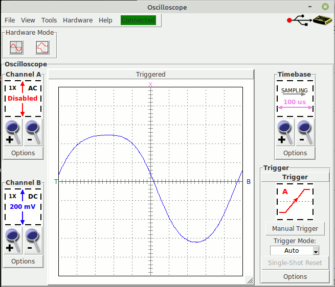

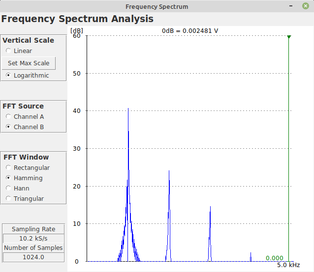

I built a simple JFET stage for a guitar cab simulator I designed and built a couple of years ago. It was designed to run on 18V. I used a J112 because I had a few, and the datasheet promised some intriguing results.
That particular J112 biased up nicely with an 8.2k source resistor at a Vgs which I thought was a good value to cope with a guitar signal without clipping (I don't recall the actual value, and forgot to write it down).
The source resistor was fully bypassed with a cap (10 uF, IIRC).
With a signal generator connected to the input, I found that a 22k drain resistor produced maximum ouput headroom before clipping. (The waveform was significantly distorted long before clipping, so I couldn't calculate this - the device isn't even close to linear.)
I also forget the measured drain current, but I think it was around 250 - 400 uA. Quite small.
(Centre-biasing was not the way to get maximum output headroom, because of the significant nonlinearity).
One noticeably big difference from more traditional JFETs was that the J112 stage had far more voltage gain. I got a voltage gain of x35 times (+31 dB) from that one single stage! That's at least triple what one would expect from older JFET devices.
The datasheet I found didn't even list the transconductance, but one can work that out from the slope of the curves. Transconductance remains high even at low drain currents. IIRC it was around 1.5 mA/V even at the small drain current at which the stage was operating.
With a 22k drain load, theoretical voltage gain (Av = gm Rd) is x33. No wonder I measured a small-signal voltage gain of x35!
The second big difference from all other JFETs I'd used in the past, was the surprisingly large amount of nonlinearity. The attached image came from a USB oscilloscope I was using at the time (it's measured data, not a simulation).
These J11x FETs were designed for switching, not for linear amplification, which probably explains why they distort so much when you try to build a linear amplifier with one.
(Which, of course, might be a good thing for use with e-guitar!)
The attached 'scope capture was taken with the output signal just short of clipping - all that nonlinear distortion came from the JFET transfer function, not because of any actual clipping caused by running out of voltage.
There's lots of distortion, but no sharp corners or flat-topped waveforms to be seen. This should produce pleasant-sounding, low-order harmonic distortion, exactly what we want with e-guitar.
I was using a 10x 'scope probe, so the approximately 1.2V peak-to-peak signal in the image translates to about 12 volts peak to peak at the drain of the J112.
Power supply was 18 V, so this is reasonable, given the need for some voltage across the source resistor, and some across the JFET channel itself.
-Gnobuddy
Edit: I remembered taking an FFT of the JFET output waveform, so I'm attaching that as well. Lots of 2nd harmonic, a splash of 3rd harmonic, very little 4th harmonic...just the sort of thing that should suit e-guitar very well!

Essentially the same as the textbook non-inverting op-amp stage, except for having much less open-loop gain. And therefore, we hope, much less rude clipping behaviour. 🙂

Interesting data on the J11x series, that is some large voltage gain you got there! You probably would have more than enough with just a couple of those and not need the Jfet-PNP.
That's the theory, and if you have a lower gm JFet, the PNP following should give a good gain boost..if the rail voltage is high enough it should stay away from clipping hard.
Not really.
The Op Amp has infinite gain and is reduced to the actual one by NFB, meaning it always has huge feedback for any reasonable gain.
Which means it will be very linear (it is being forced to by NFB) and will brutally clip because with no output voltage variation (hitting a rail) there is no NFB possible, so it becomes open loop and it hits those rails with a fury.
While the FET has NO NFB loop, all nonlinearities appear unhindered, and when it´s running out of stamina near each rail will simply curve waveform.
Completely different mechanism, clearly shown by scoping.
That in both cases resistors set gain, does not mean they work the same way, at all.
Test it yourself: build a, say, 20X gain FET stage and a 20X gain Op Amp one and drive both to clipping.
Compare waveforms, run FFT, the works.
