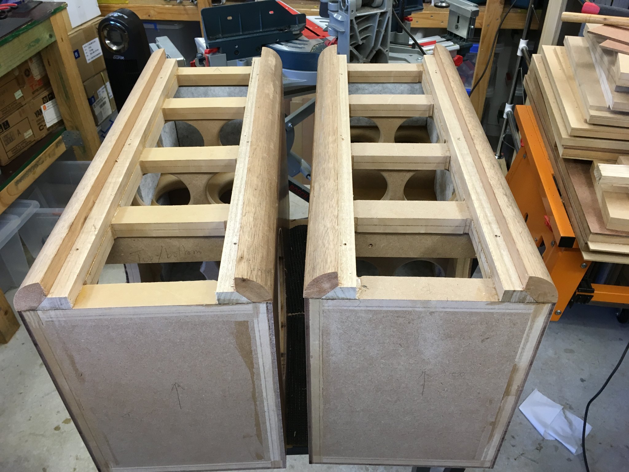

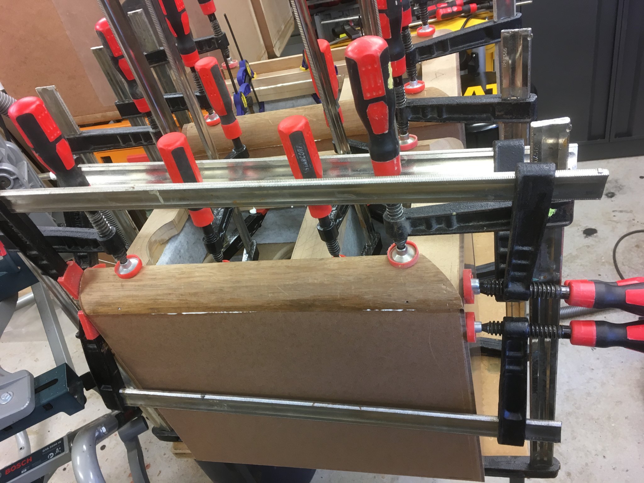

Yes, 2" (50mm) quarter round Tasmanian oak.
Very cool! Where can I get this product (or larger) here in Oz?
The 2" quarter round is not that common in hardware suppliers like Bunnings. I had to obtain from a specialist timber merchant and it may even require a special order. Hardwood is much preferred to softwood like pine, for painting/staining and especially since the edges will be more resistant to occasional knocks. Larger radius may be available but will be expensive.

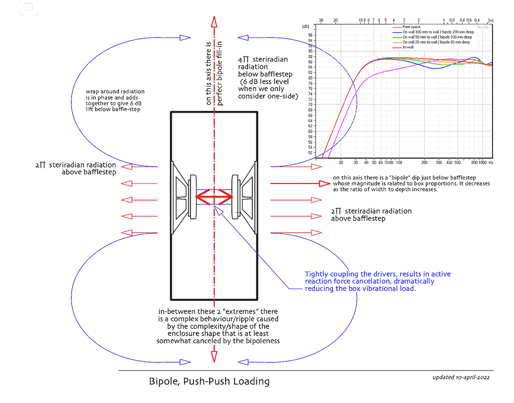

Like STV i'm sceptic about Dave's explanation. Don't take me wrong, i experimented with push/push thanks to him and i'm convinced by the outcome but simulation doesn't track his explanation ( or i don't get them):
https://www.diyaudio.com/community/threads/tachi-coaxial-point-source-bem-modelling.386711/

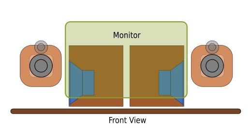

After some thought, I suspect there may be a way to 'partially' cheat the dual opposing/force-cancelling thing in my situation, even with single woofers per side. I reasoned that:
  1. The woofer cabinets are quite close together, within the width of a desk,
  2. I'm already intending the drivers to be side-firing, and facing in opposite directions,
  3. In many cases the lowest frequencies (where excursion is greatest) will likely be common to both stereo channels.
This is one type of configuration I was already considering, which would particularly lend itself to the idea:
(monitor shown as if translucent, above, to help illustrate)
Looking at the top drawing (front view) it wouldn't take much to couple the two opposing woofer cabinets, either directly or through a shared stand.
Admittedly, my third assumption might be a bit shaky; I think most realistically recorded music will follow along with the lack of directivity that low frequencies posses, and so reproduce them in common on both left and right channels. Electronic and highly produced types may not, necessarily, but obviously a great many speakers have just a single big woofer and it isn't the end of the world. These things are only small in my case, so if they want to move I'll just screw them to a rigid stand or bracket.
Reactions: stv

  1. In many cases the lowest frequencies (where excursion is greatest) will likely be common to both stereo channels.
Force cancelling requires both drivers to share the same enclosure and have identical signal. It was common practice to "mono" low bass in the pre-digital era. A single mono bass enclosure would work. I have built many force cancelling subs like this.
So you would need to L+R your bass signal.

I wonder if some spl cancelation occurs between the two cabinets in the axis of the listener, because of two wwoffers looking at each others and playing the same materialfirering in phase opposition ? Should this frequency cancellation occurs at the wave length given by the cabinets spacing ? ... or is it ok and stilll 4 Pi so that doesn't matter ?
off topic : the barefoot micro 26 looks very nice but I wonder about th MTM layout while it's 1.5 filter that is applied to the two 5.25 mid and at the same time playing relativly high (3 k khz) with such layout (honeycomb filtering behavior of the MTM when going high towards the treble range due to the spacing (center to center of the two drivers being far because of the in between tweeter). Anyway we see that the acoustic cut off is about 100 hz with the side woofers (which is meaning maybe a little higher electrical cut off I assume?).
Bon, the same signal is certainly true; my expectation is that many recordings might do this (to at least a useful degree) for lowest fequencies even if not formally made mono. Though I may well be wrong.
TBH I'm not 'massively' bothered if not, though. At the modest SPLs and driver size involved in my little application, it probably isn't the most pressing requirement within the bundle of compromises to be made. Compared to (e.g) having second drivers firing into small, boomy spaces. When a decently rigid bracket or stand would certainly work here. I do have a pretty weighty desk to serve as an anchor, or there might even be the masonry wall that it is located against.

Ok, STV got it, the little graph up right and Dave talking about bsc made it clearer to me, it's related to the highest freq usable with this config and location in room ( SBIR related notch).
Like i mentioned in thread linked i won't use this config higher than 200/300hz ( driver diameter -more precisely their depth- related ). I have something loosely inspired by Dave's Tysen v2 with a pair of 6'5" as force cancelling and the usable upper freq is circa 300hz, they are xover one octave lower at 24db/octave to a fullrange in sealed box. It mitigate issues as all drivers are well within 1/4 wavelength spacing ( so overall omni) and baffle width of 20cm makes the xover freq below the full bsc compensation ( iow at 150hz there is omni radiation for all drivers and no box shadowing effects anymore).
The issue Dave mention about loudspeaker's backwall ( frontwall when facing loudspeakers) is related to usable highest freq range too: too high and you have notch mentioned in Dave's explanation but if you cut lower it can play with you:
Last summer i experimented with 12" car sub in same config and figured the highest limit was circa 200hz ( with the driver and box i prototyped, it might be different with another one, idk?). In that case i would have x them no higher than circa 100hz with 4pole filter, maybe a bit higher with 8pole FIR xover but not much, and in that case would have made divers close to floor and backwall to gain +6db from boundary loading ( a plus for me as it lower requirements of eq ( or compromise on max SPL from required eq) as i almost always use Linkwitz Transform/sealed in small volume box to lower usable freq range and low final Qtc - 0,577).
Not really different from Roy F. Allisson approach.
The compromise being now in the midrange ( if the box is used as stand as in Bon's latest loudspeakers) as they'll suffer from close proximity of boundary ( loudspeaker's backwall/ listener's facing one). Answer being sattelite approach or directivity management for mids/high freq ( either by waveguide, meh or cardio ala D&D).
Compromise, compromise,... always compromise. The point being to find the right set for your goal.
I'm not sure the room loading is different in the lows wrt a single driver. At least it didn't show up with the test i made.
In the mid ( from 250hz up) the simulations i linked previously show clearly what happen and there yes i agree room loading is different.
