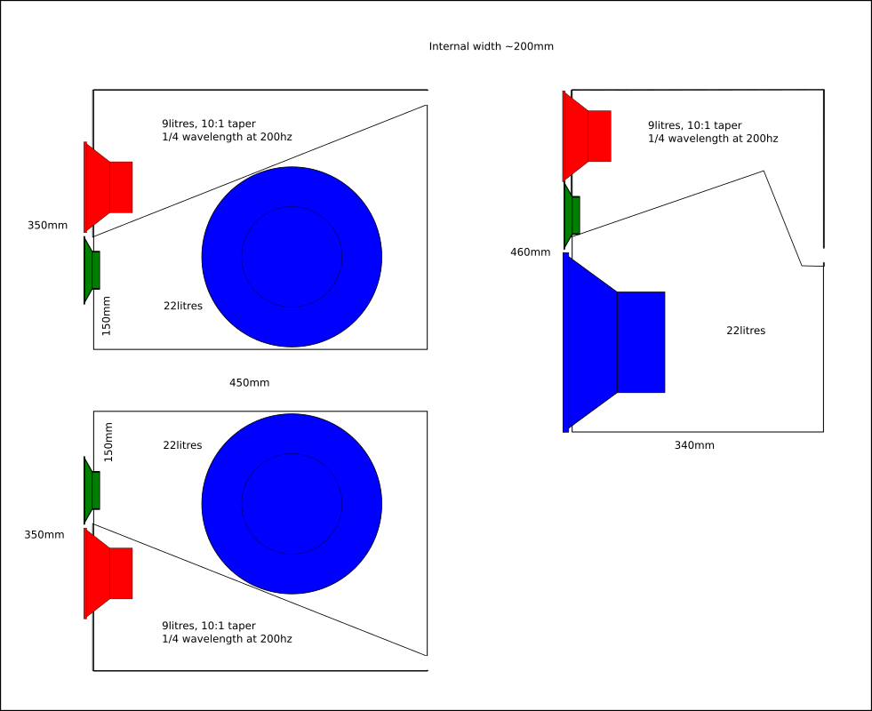

In the meantime I've done a couple of sketches for the kind of internal dimensions I would be looking at (assuming no EQ), and also how this might work with a deep tapering mid-range chamber - which isn't massively important but is something I would like to try. Nothing very accurate or specific, in fact the mid-range driver hasn't even been chosen yet (shown is for an alpair 7ms), it is just to get a feel for roughly what might be done:
Of course, just showing side views of the speakers. The traditional front-mounted woofer would make a more traditional ratio of height to depth (right hand image). However for desktop use I think the smaller height and deeper cabinet could be preferable, and is a bit easier to construct (the left hand images, either way up). It also isn't impossible that (with the woofer on the side) space could be left for a small midbass driver, should that be wished for in the future.
But there isn't a night-and-day difference in height between them, so it probably depends most on what clutter there is (or might be) to the sides of the speakers.

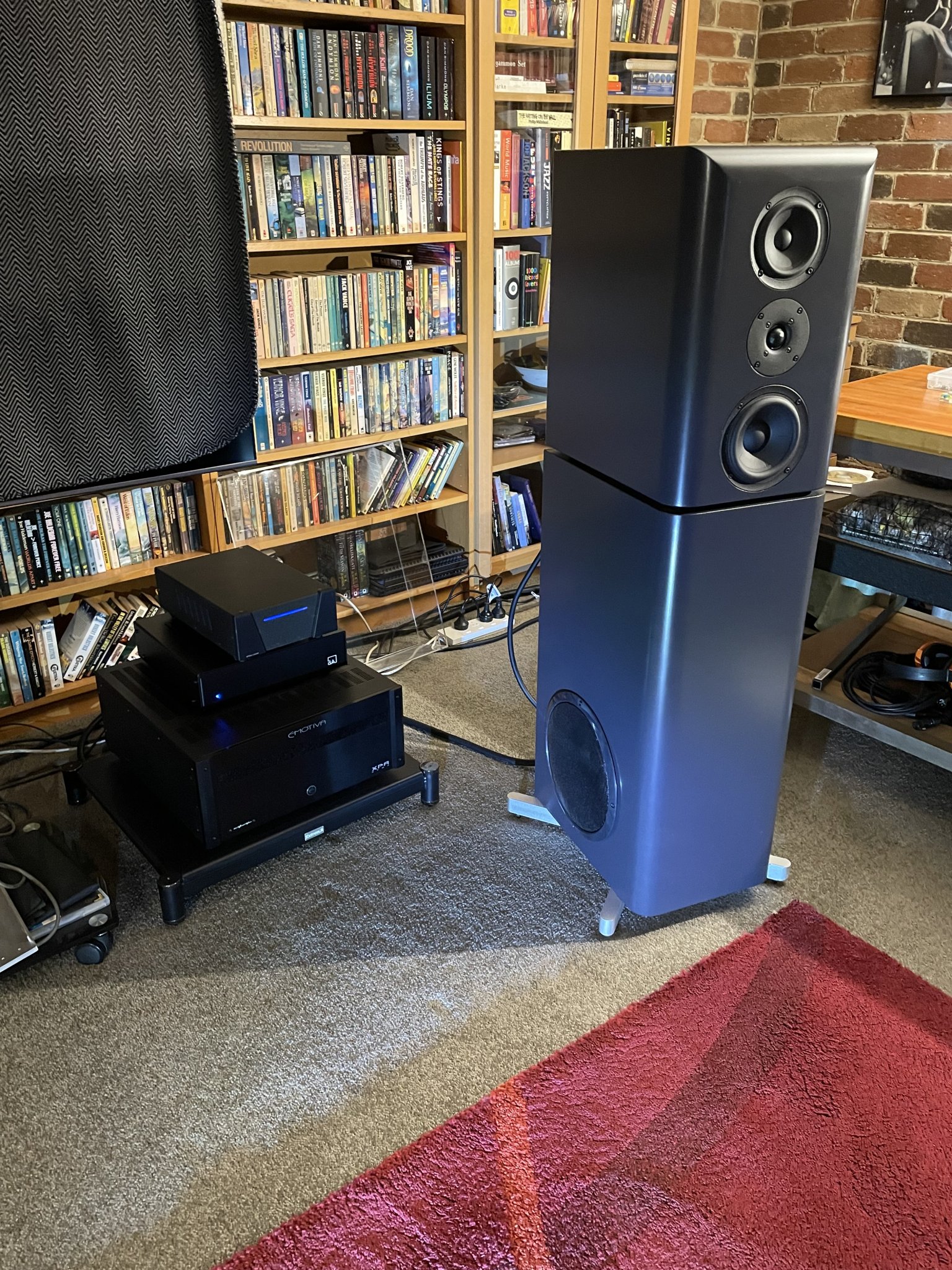

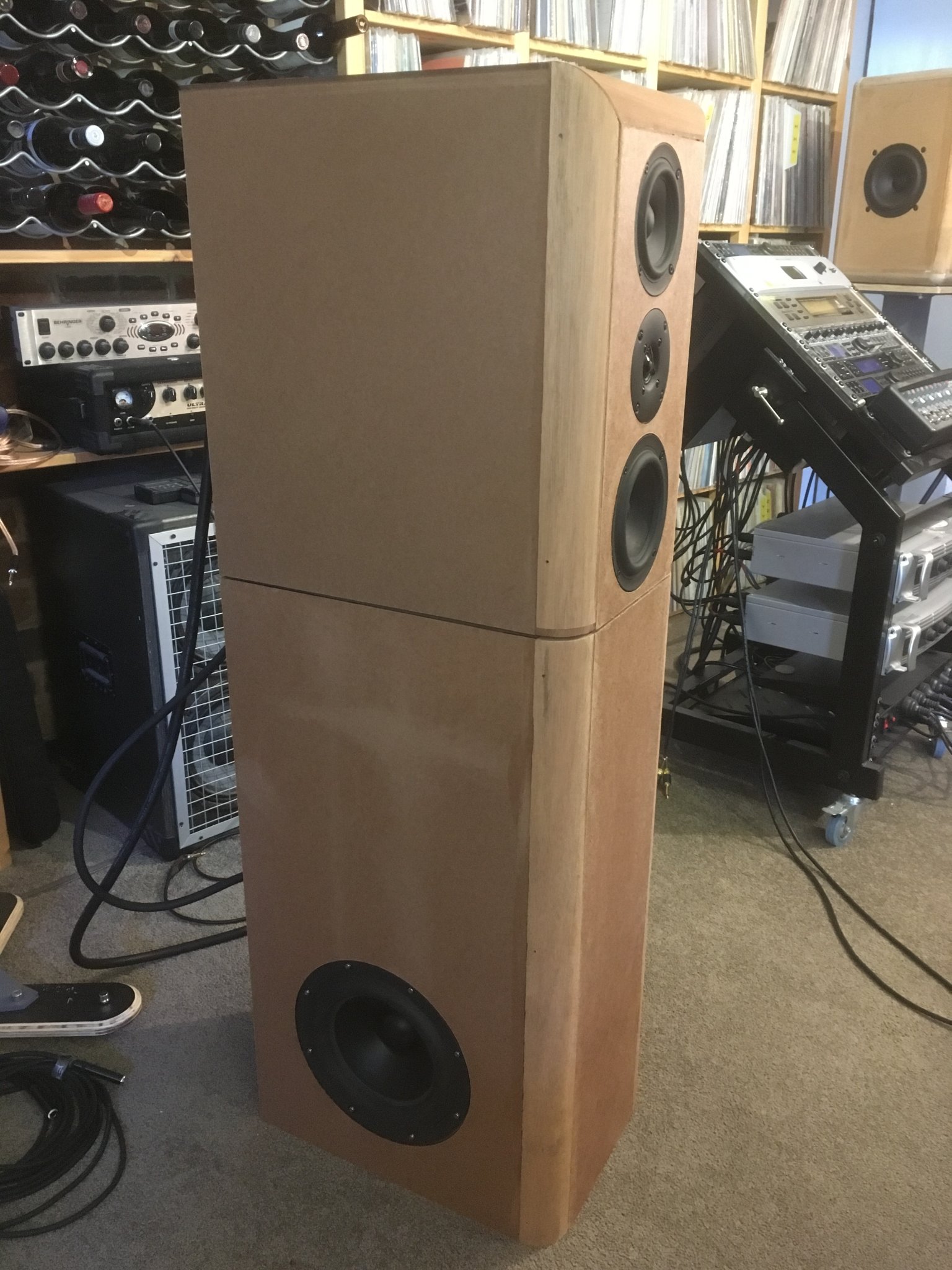

It is spooky how your thinking is converging towards my approach. I scaled up my original single box near-field monitors to a free standing 2-box 4-way loudspeaker, with the side-firing (sub) woofers in a separate sealed enclosure. In one of the images, the baby brother is seen in the background. The opposed reaction cancelling 8" subs are mounted low to take advantage of room boundary re-inforcement. Sealed box alignment for the subs reduce group delay and bass phase anomalies. I aimed for 20Hz in-room and achieved this. The sub frequency range is 20Hz-80 Hz with LR48 crossover alignment at 80Hz with the aim to keep the low-mid (80Hz-320Hz) driver excursion and distortion low. My approach requires a dsp active crossover. I don't know how compact separate enclosures can be made for desktop duty.

Thanks Bon. No worries about duplication; I'm taking so long that people forget - including me, so it is a useful reminder! I get little bits of time to think and question, yet enough time for making and testing (progressing) is frustratingly rare these days.
In retrospect I might have been better off getting smaller but dual woofers so that they could oppose each other. Though it is harder to get smaller drivers that go so low (in a small sealed box) and these were something of a bargain. Perhaps at the modest desktop SPLs needed here, single/unopposed need not be awful. But at least their small sub-like nature is turning out to be very suitable, given the low crossover that I'm aiming for.
Yes, fitting things on a desk is an added challenge, at least to do very optimally with clutter on all sides. So I'd been coming up with some weird and probably over-complicated cabinet shapes. But seeing your neat results again, reminds me how much an appealing design matters. Especially for something one lives with every day. So I'm increasingly tempted to avoid awkward shapes and instead try to rearrange the room.
