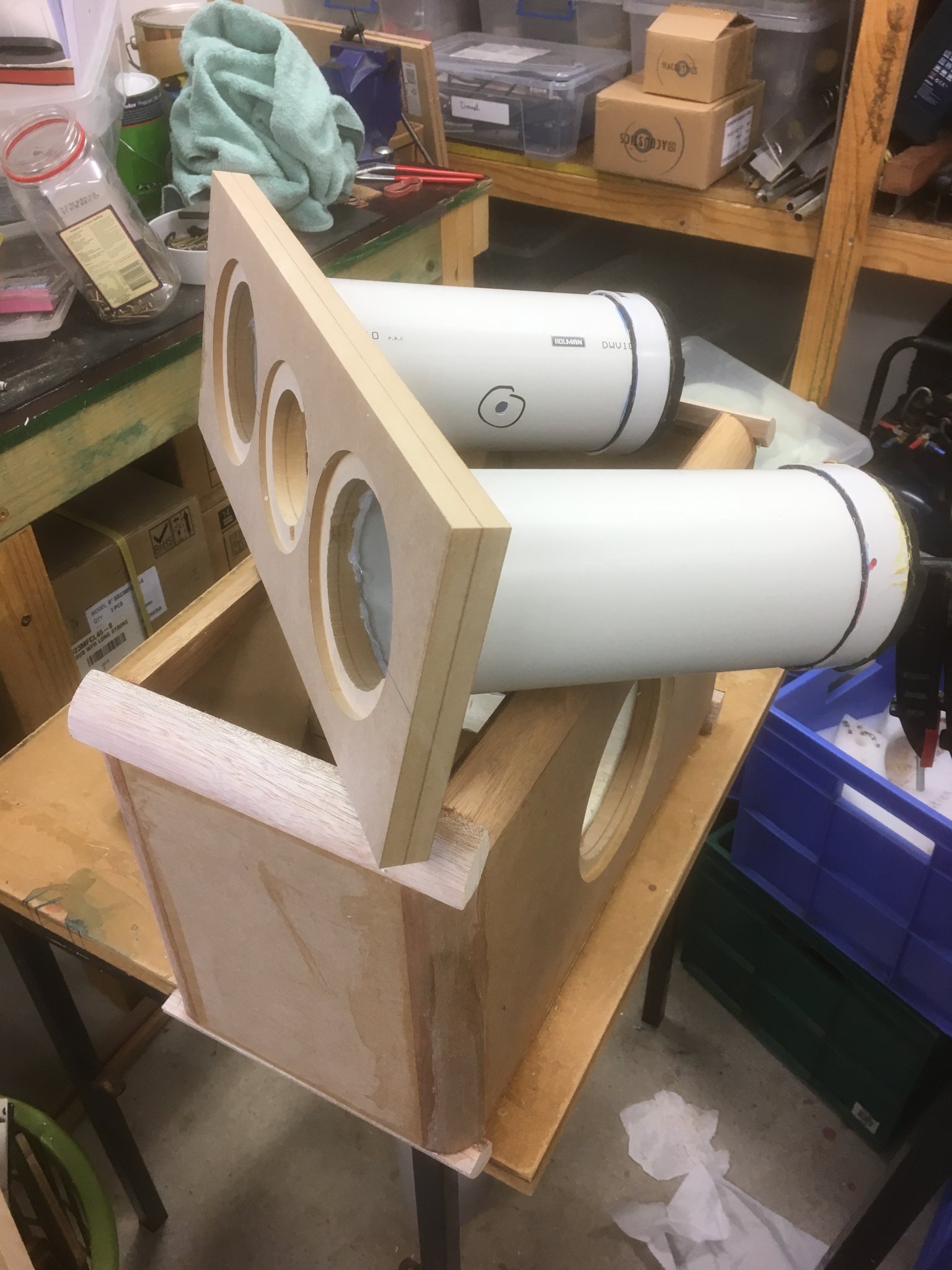

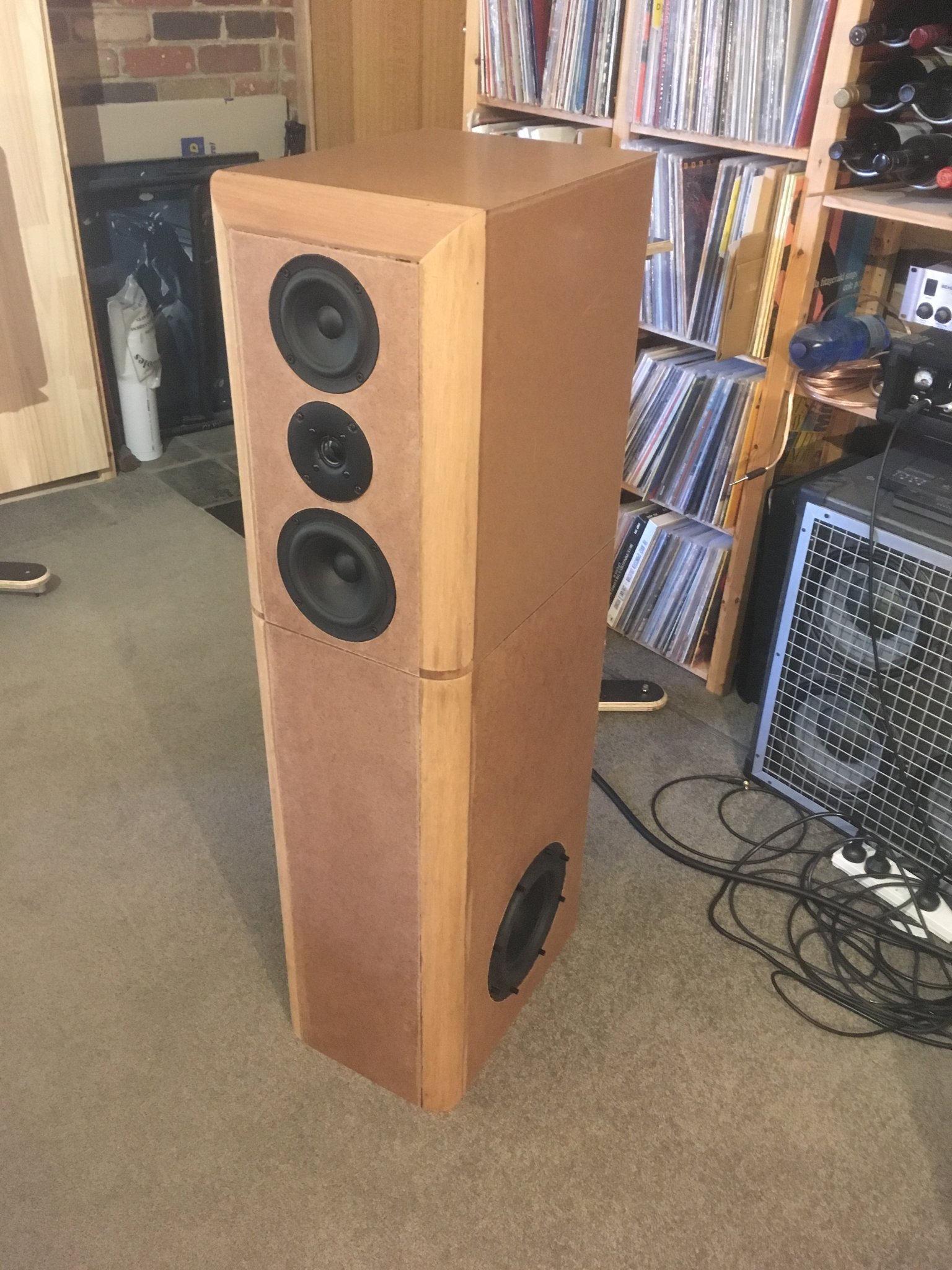

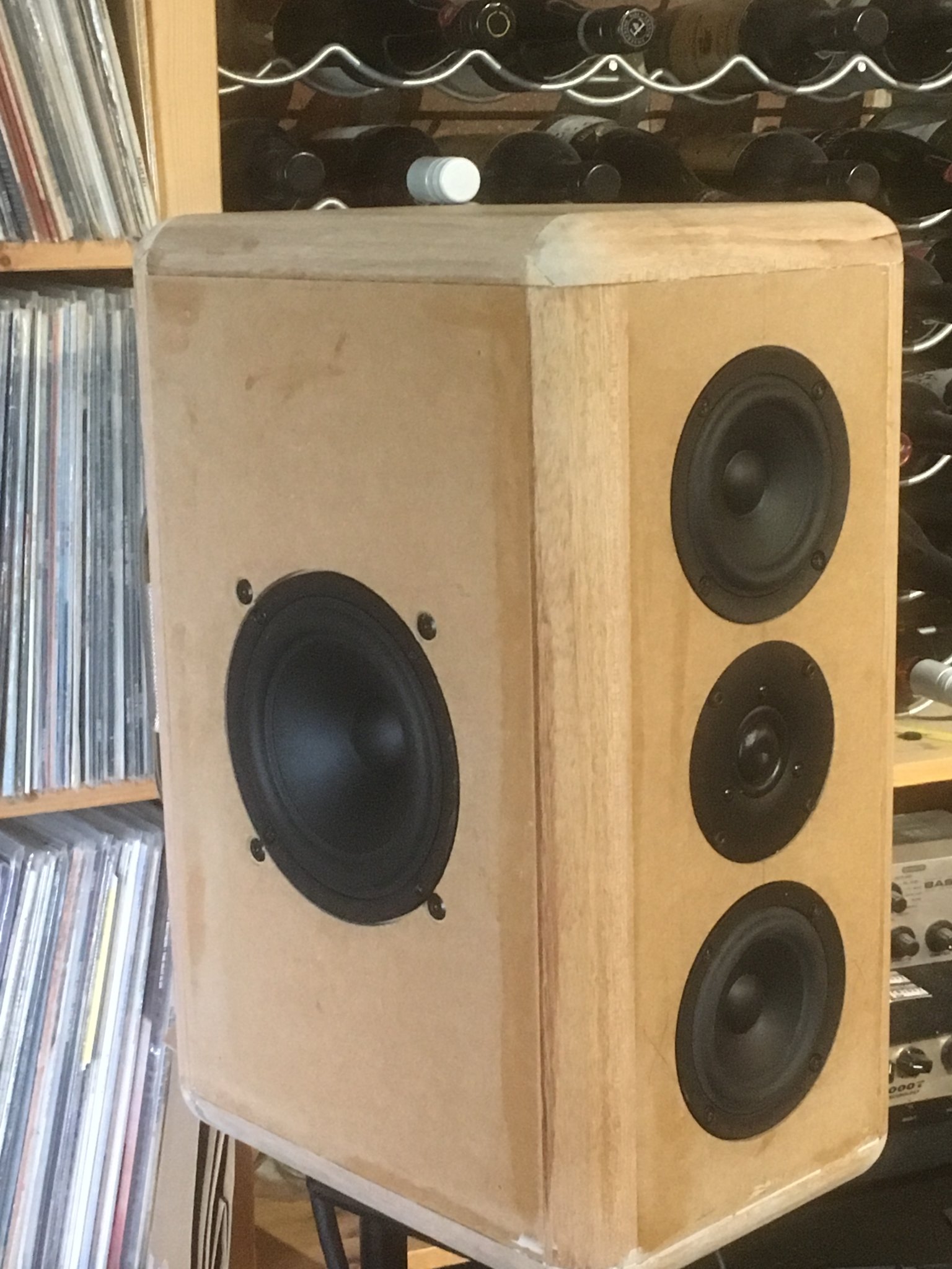

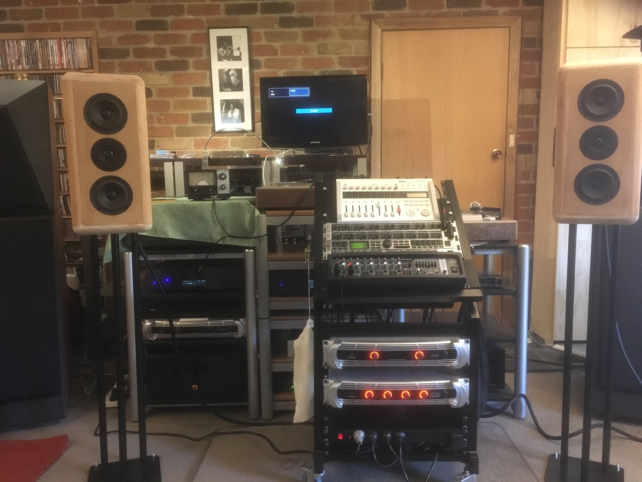

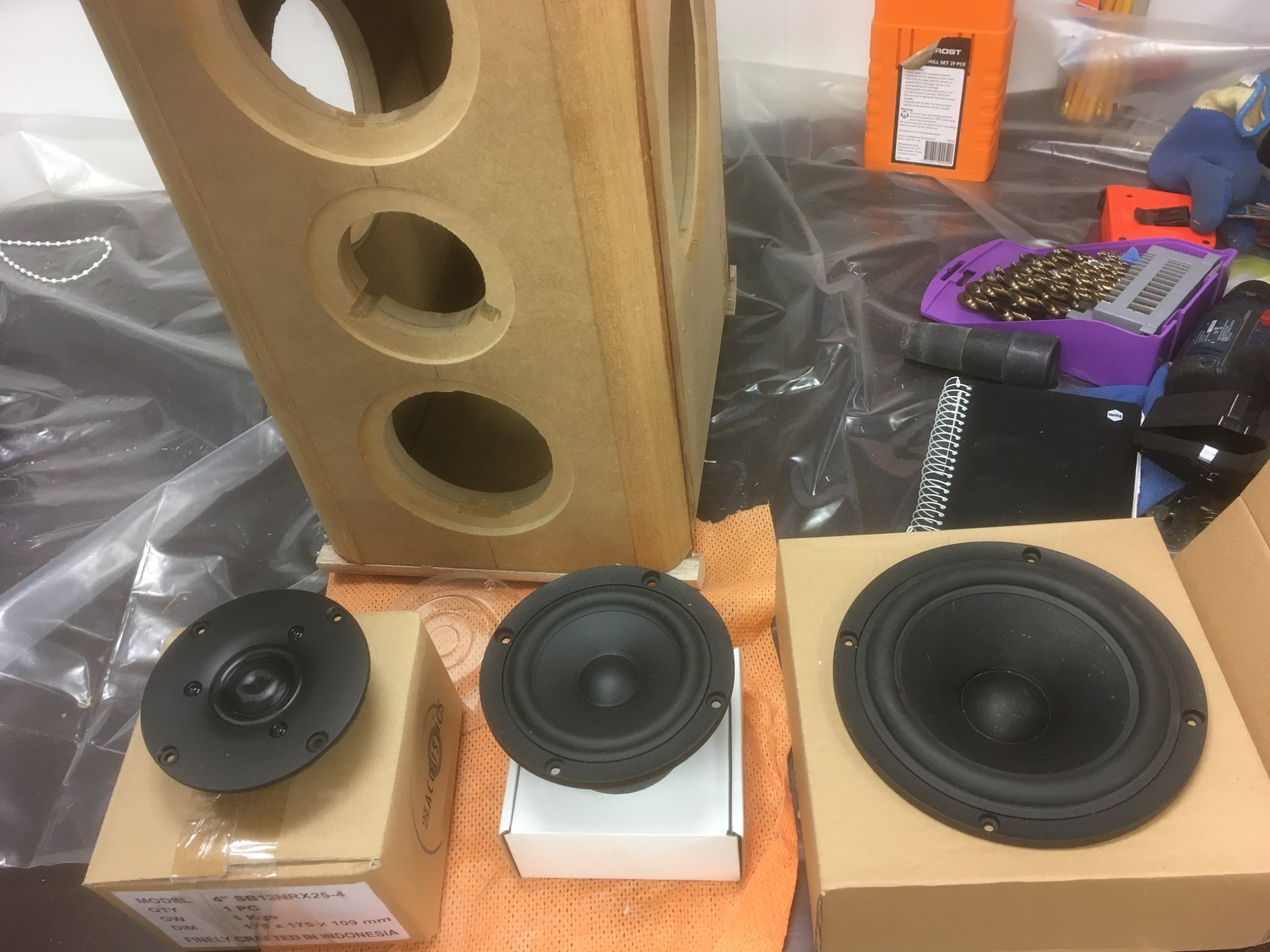

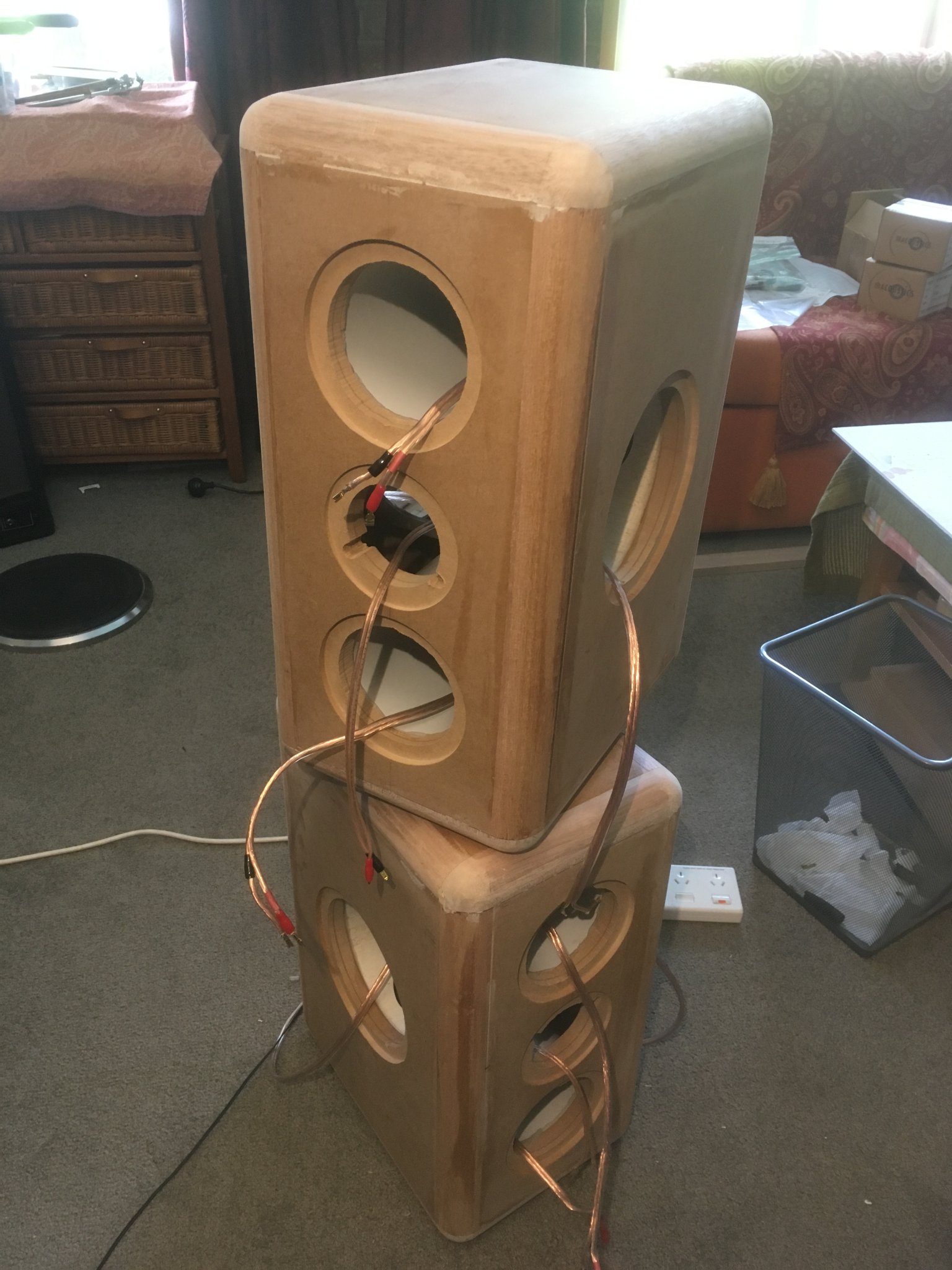

I built a pair of 3-way speakers with exactly the same purpose, for home studio monitoring. They were originally MTM + side mounted woofers. I focussed on making them as compact as I could get away with. They turned out to exceed my expectations to such an extent that I have since used similar strategies in much larger speakers with very good results. I am mindful of the greater importance of keeping the woofer-mid crossover frequency low for a larger speaker. To keep this around 80 Hz, pushes the mid-range driver range wider than I like. I try to keep drivers to at most a 3-octave range. This means that my larger speakers are 4-way and use a lower mid-range (80 Hz-640 Hz) with upper mid-range (640 Hz-2560 Hz). I have recently replaced one of the mid-range drivers by a 2" dome upper mid-range and converted the speaker to active 4-way dsp, which is probably overkill for the initial purpose, but they now work well in a normal domestic environment. The original MTM baffle works best if sitting directly on the tweeter axis and comb filtering is minimised by room acoustic treatment.
I might also mention that I give a high priority to minimising the effects of edge diffraction, hence the 1 1/2" hardwood roundovers.

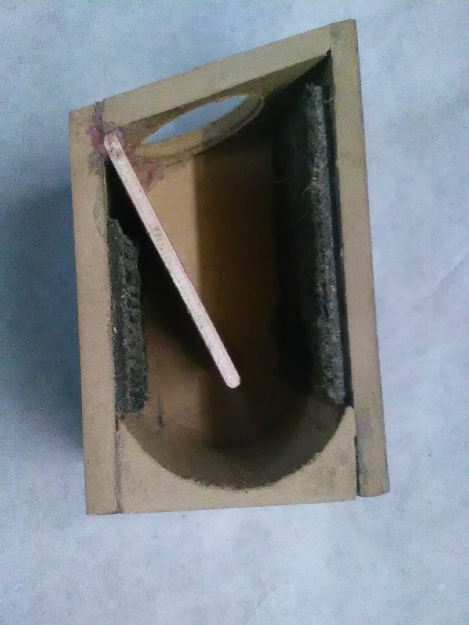

As a small note, I've been looking at some practicalities of the side-facing option. A couple of small disadvantages have come up; one is that the woofer magnet would block my (mild) preference to have a long/deep tapering mid-range compartment, another is that they really might not work so well where there is stuff (shelves etc) right up to each side of the desk.

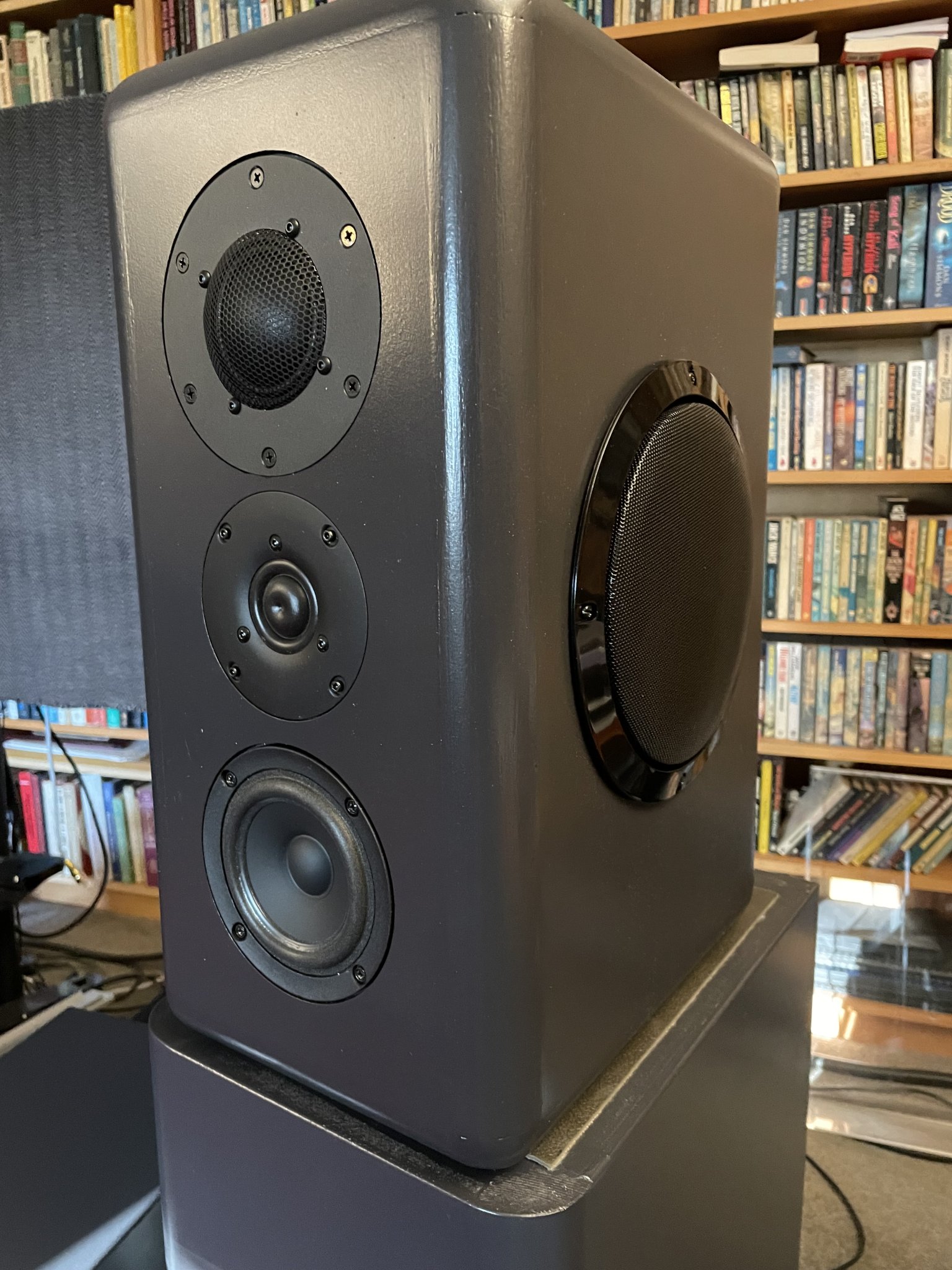

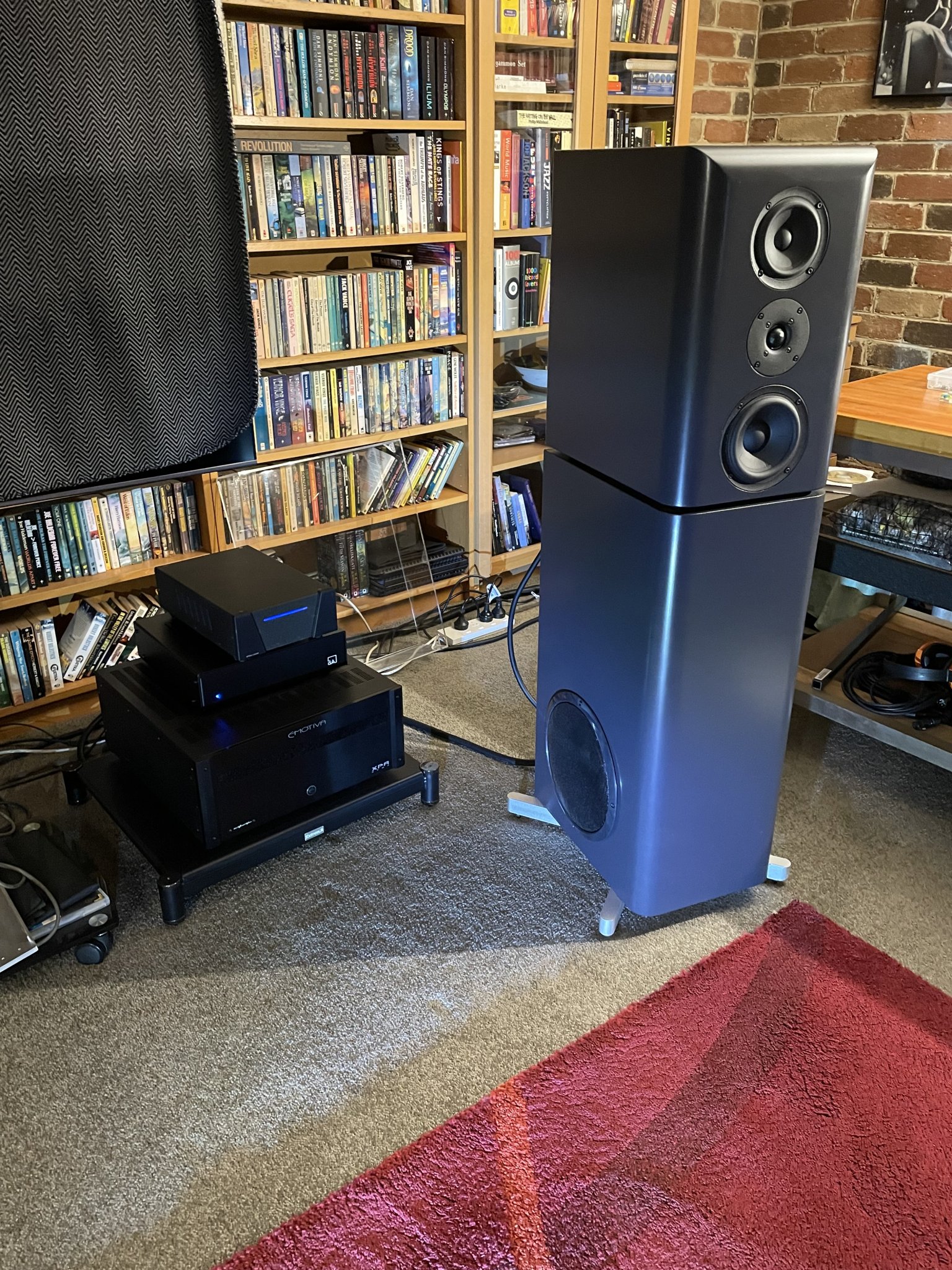

To show where my experiments on side mounting woofers have lead, I attach some photos of my current main speakers, which are essentially similar to the near field monitors of #8 sitting on a separate decoupled reaction cancelling subwoofer box containing 2x8" drivers.
