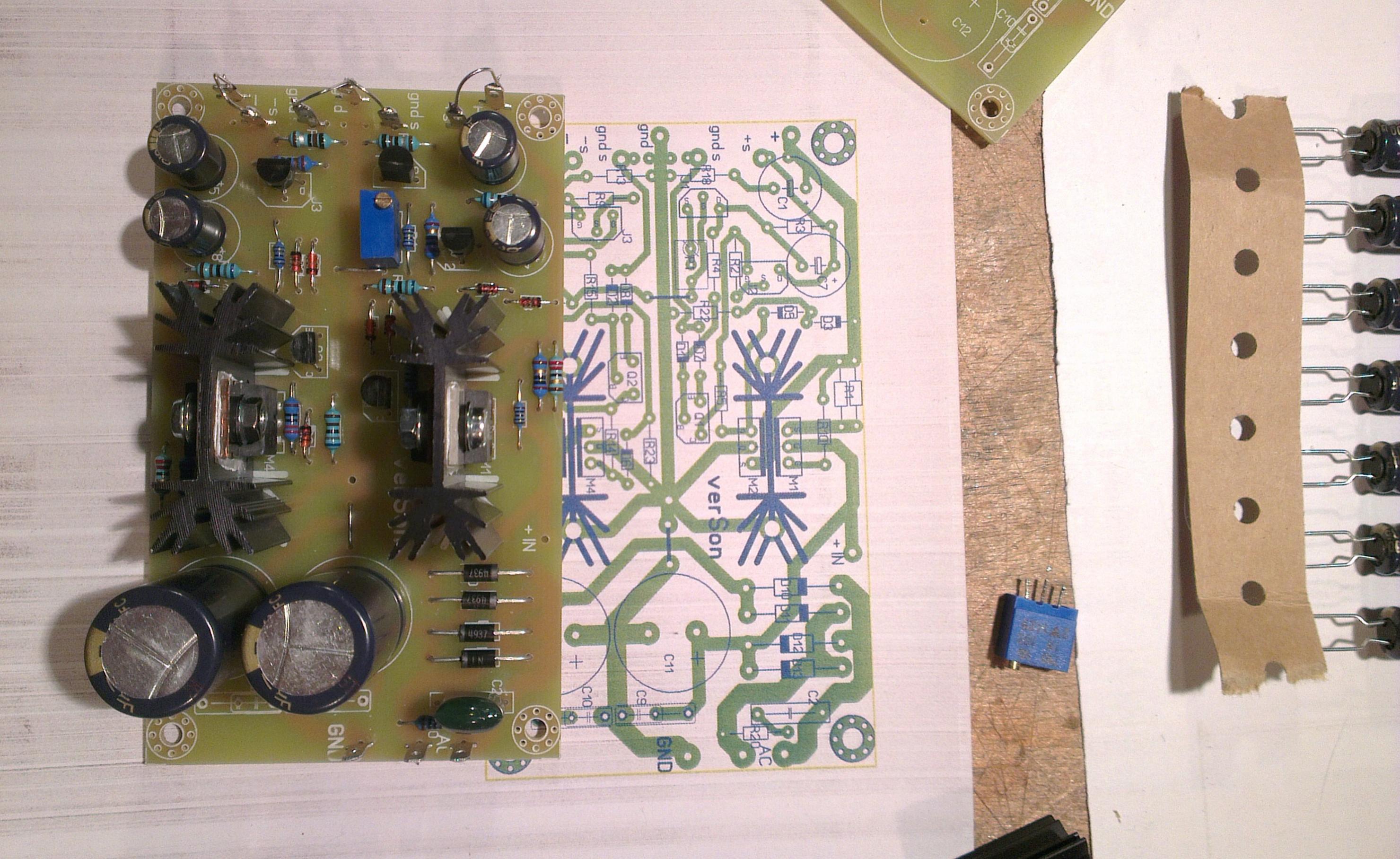

i've decided i want to experiment with a good shunt regulator to use for my marsh headphone amp. your design will do perfectly.

Shunt regulator one finished.
CCS with DN2540 will give 110 mA about with 10R for R1, R8, and 140 mA with 6R8.

Go for it, and you are welcome.
