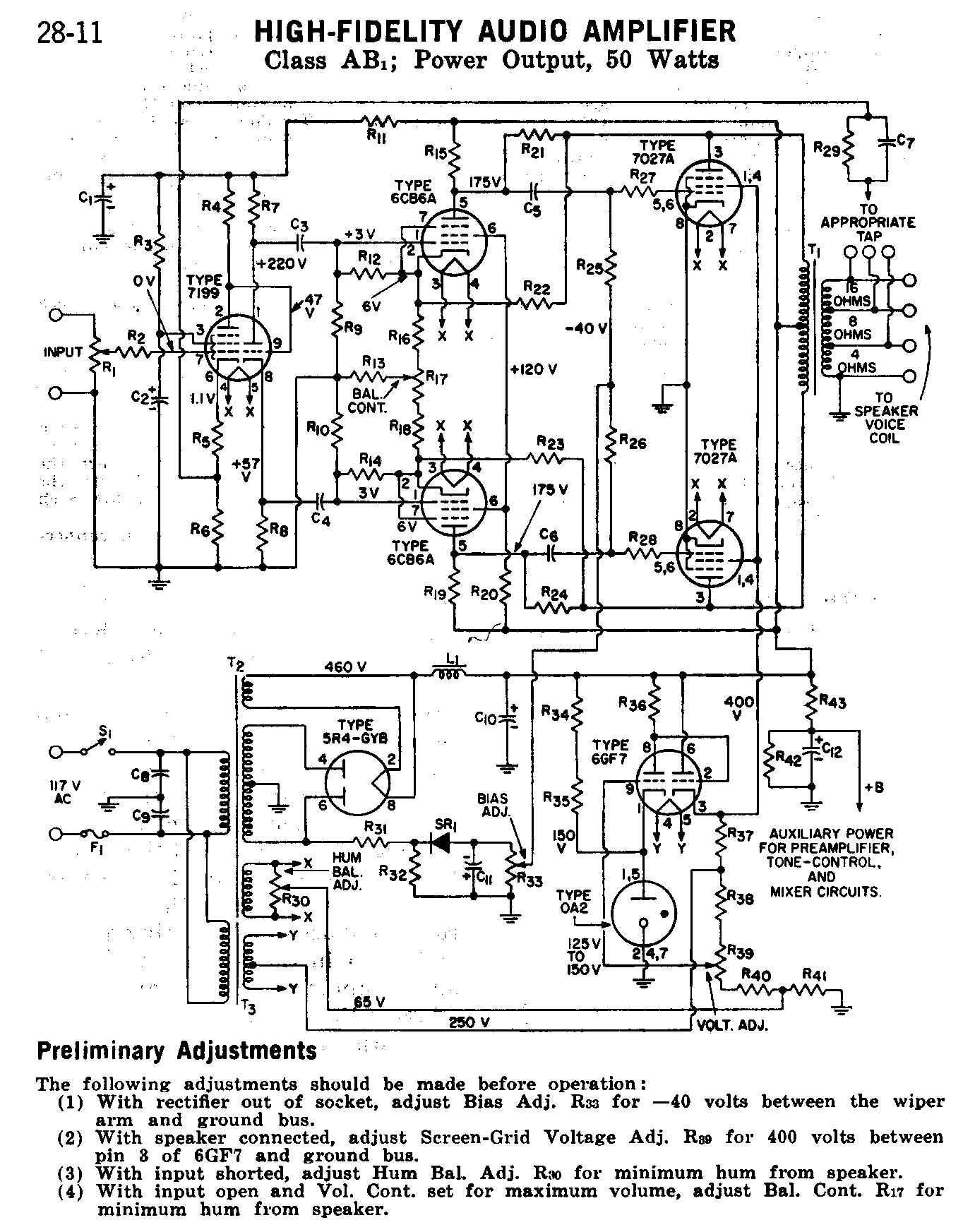

Looking at the original schematic in post #1, I'm seeing two N Feedback loops.
The obvious one is the so called "Shunt Schade" from output plate to output grid driven by current drive.
The second hidden N Fdbk loop does involve the output tube and the Op Amp thru resistor R1. Current derived from the output plate voltage and R2 passes thru the Mosfet down thru R1. (ie, same plate V derived current thru R2 and R1) The voltage on R1 reflects an attenuated plate output voltage, and is being fed back to the Op Amp inverting input, providing an outer loop N Fdbk. This is really quite ingenious. The Mosfet avoids any NPN base current distortion effect besides.
The presence of the hidden outer driver loop N Feedback is surprising. One starts to wonder what the RCA 50 Watt Amp has going on with an extra driver CFB loop in addition.
This can be generalized to an all tube solution easily. Just put an LTP of pentodes in place of the Op Amp and the Mosfet, with a resistive tail or CCS tail. (optional floating screen supplies from tail at this point). The LTP output pentode just gets a constant bias V on it's grid. The LTP output N Fdbk current will have to be complementary to the input LTP pentode signal current.
If the screen supplies are not cathode floated, but just summed screen grid currents to ground (single screen V supply from ground), then the LTP will have gain droop at signal extremes when plate V drops below screen V. This might be useful for soft limiting. Have to experiment here.
Then one can go to a full P-P scheme by just filling out the symmetry. Both LTP driver pentodes are used as complementary "shunt Schade" drivers to P-P output tubes, with complementary inverted inputs into the two LTP pentode grids. Anatoliy should like the hidden nested loops here. An outer global loop would be 3 loops.
Note: The RCA 50 Watt design (below) uses a pull-up resistor (R15, R19) on the driver plates to B+. This inserts an additional current component in the driver plate output. The driver CFB loops would provide an automatic tracking increase of driver current to compensate, if sized correctly. Maybe this is what they are doing there. Would have to calculate out the effects to see if they are equal. Very impressive design if that's what it's doing, no wonder nobody could figure out what they were up to.

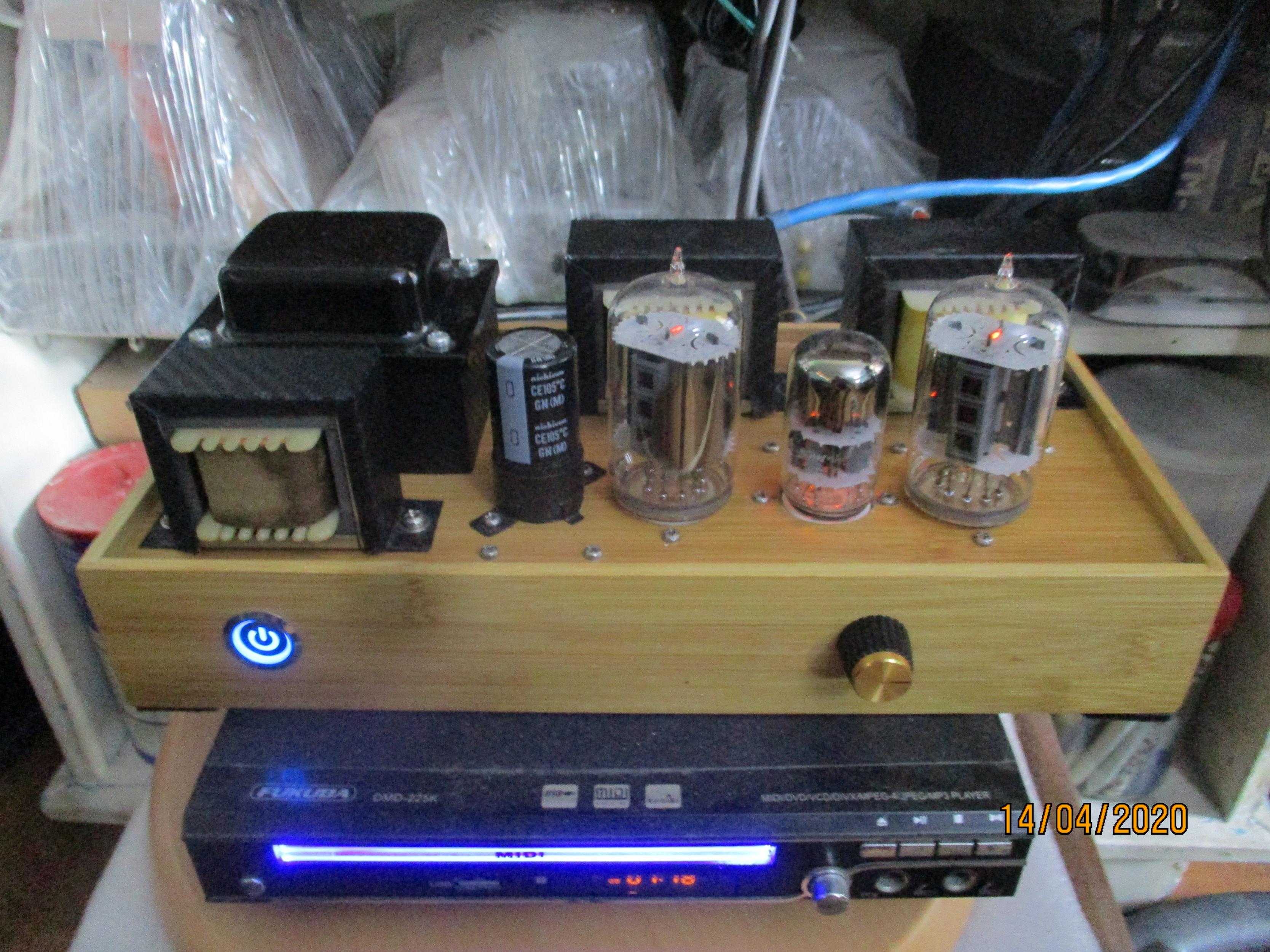

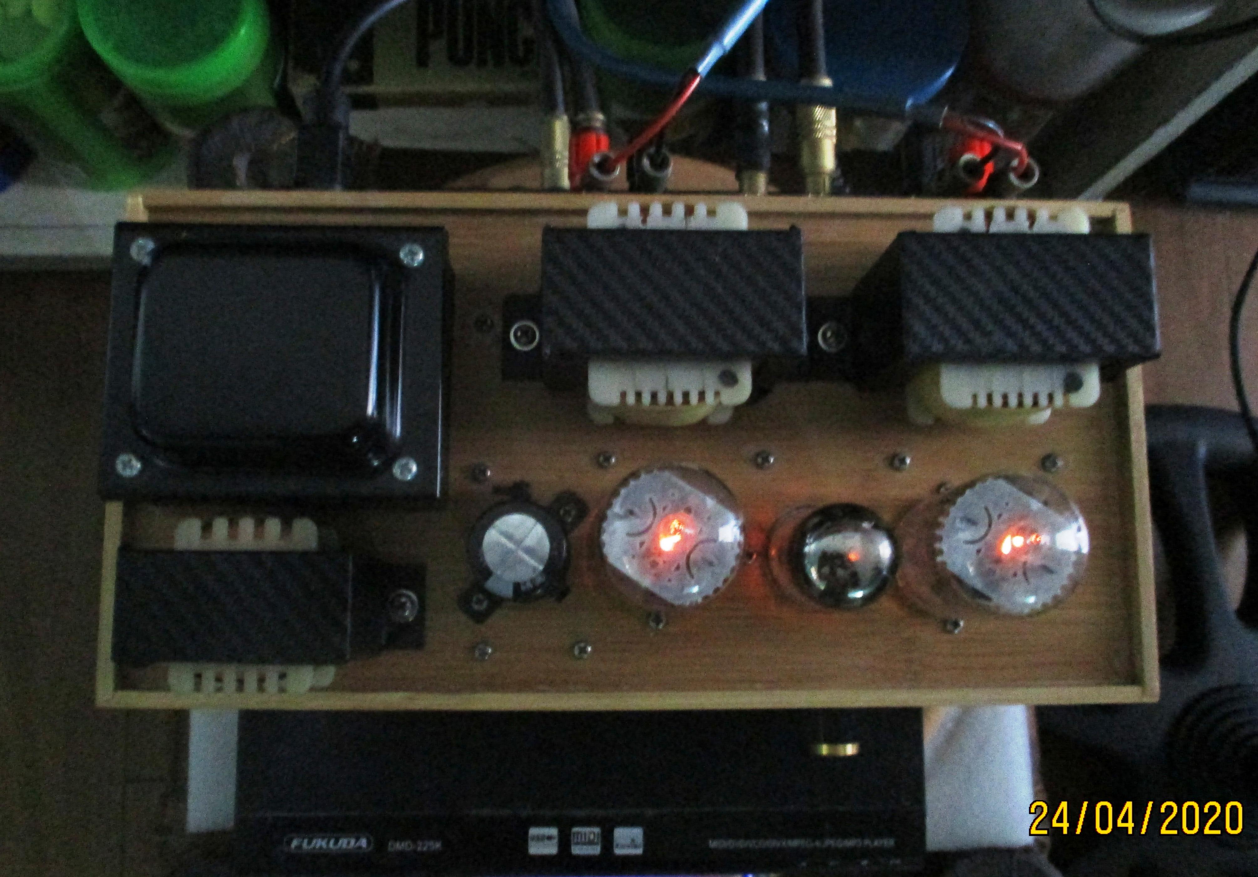

i recently made an all pentode single ended amp with the 12gt5 and 6bn11, using the shunt feedback and no global feedback....sound very good to me ears....

A negative rail for the LTP driver tail would avoid the need for the driver plate pull-up resistors as RCA used (R15, R19). So no need for the EXTRA driver CFB pathes complexity (well, assuming a driver load R current nulling solution was what they did). The "shunt Schade" resistors can provide sufficient voltage to the driver stage then using a neg. rail. An Ultra-efficient parts design, providing 3 nested N FDbks with just 2 resistors (if global N Fdbk is included too).

the G2 supply consisted of an IXYS01N100D CCS set to around 30ma and shunted by two 75v 1W zeners, this is believed to be the reason why the amp sounded so good.....G2 supply is 150 for both the tubes...
Tony, is that 150V G2 for the outputs and ground referenced for the drivers too, or is it a floating supply on the driver cathode tail? (like Pete's circuit below with the 0A2 regulator)
Push-pull driver board
Looks like Pete's driver board could be easily modded to do this design, with no driver pull-up resistors (remove R35, R4). The neg. rail V needs to be sufficient to operate the pentode drivers thru the shunt Fdbk resistors (R1, R39), and the pentode driver grids get re-referenced to near the neg. V.
One might like to put a signal splitter in ahead of the pentode drivers for better symmetry.

yes, ground referenced.......the amp i built is single ended...
if i may add, the B+ take off point was at the junction of the filter caps in the full wave voltage doubler so that the the raw b+ of 180 volts is then dropped to 150 volts, so the regulator is not dissipating a lot...
Your bottle neck of shunt feedback is the grid 100k , reducing the ratio to 30%. You can use simulated inductor , gyrator as called here. see example here. Extra power,higher DF,lower distortion from SE pentodes
