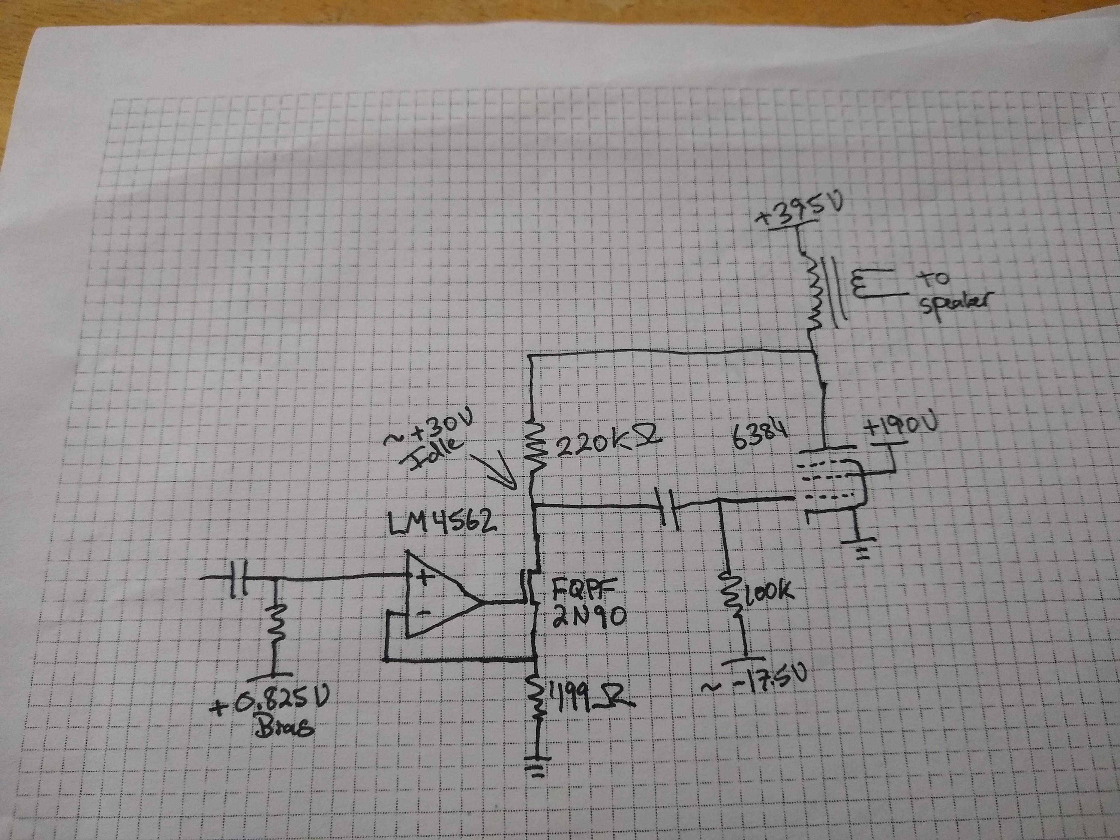

Shunt Feedback 6384 SE Amp
Yes, indeed, taking the N Fdbk back to the driver cathode should be much cleaner with more loop gain and less driver Vg1 to K distortion inserted.
With a low gm output tube in the original configuration (so called shunt "Schade"), the output tube grid drive voltage, Vg1, is inserting noticeable distortion in the current Fdbk thru the Fdbk resistor. One way to fix that would be to put a P-chan Mosfet in series with the feedback resistor as a grounded gate stage. That way the current thru the Fdbk resistor (and subsequent Drain current to the output tube grid) will be proportional to plate V minus the AC ground reference at the gate, rather than plate V minus grid drive V.
Another advantage can be derived as well by referencing the gate to B+ instead of Gnd, then Fdbk current is proportional to voltage across the primary. (so B+ ripple removed)
Wavebourn took it one step further by driving the P-chan gate with signal voltage, making the Mosfet the driver itself. I think he had a source resistor to B+ in there too.
What do you make of the distortion results that I got with a mosfet driving this transformer with very little distortion on the primary, but quite a bit of distortion coming out the secondary? Is this just the nature of SE transformers? Would I get better results with a more expensive transformer?
I mean, for all the faults of the circuit I tested, I don't know if I'm going to do much better without a loop around the transformer if the mosfet couldn't do it. The only way to counter that would be anti-phase pre-distortion on the primary side, which may actually be happening here in the areas where this circuit beat the mosfet.

So...I never really got to take a measurement to confirm that my primary voltage waveform was low distortion. I was attempting the measurement when I disconnected the input to the amp and everything broke out into full-power oscillation and some parts literally went up in flames. I elected not to do extensive repairs to take that one last measurement, since I decided that I wasn't going to build that into a real amp.
I just don't think it likely that a mosfet follower would add much distortion, especially this comparatively huge amount of 2nd harmonic. Any reason I might be wrong?

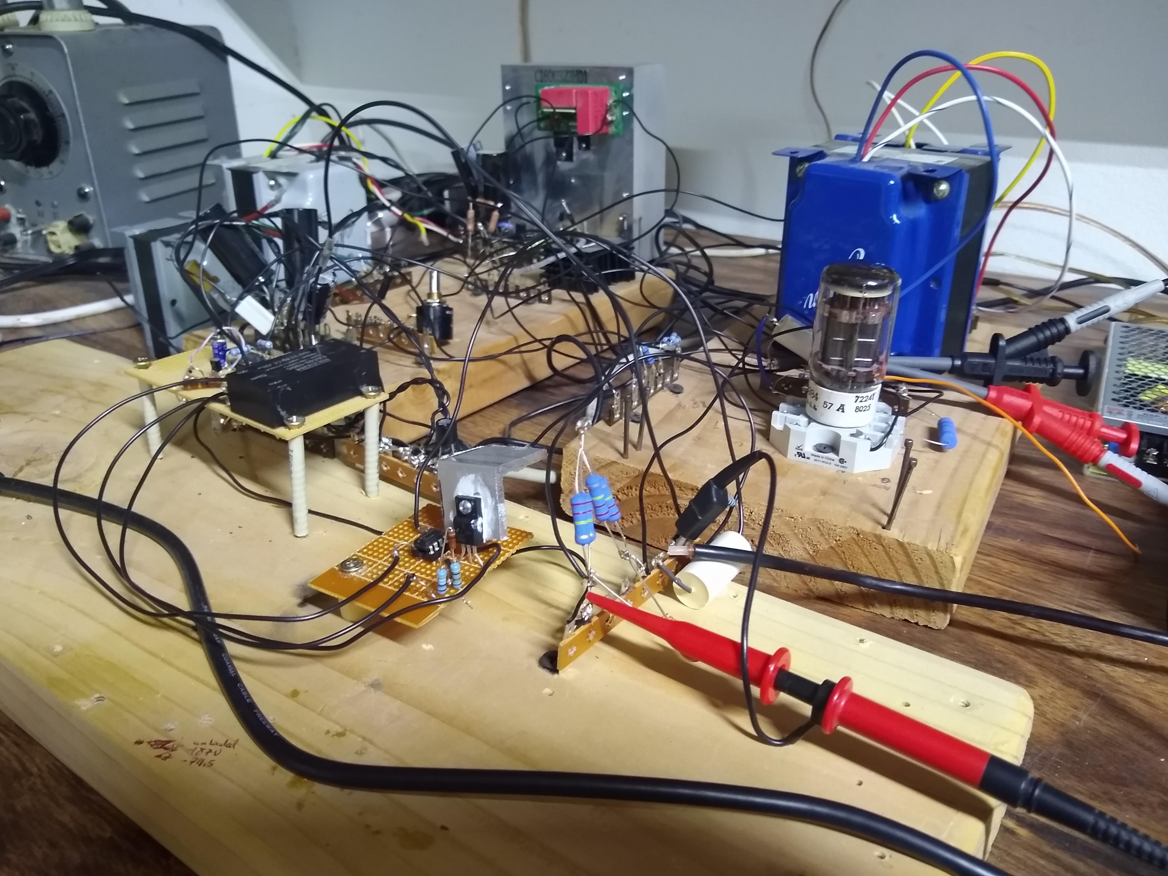

I have converted this amp to a pentode input stage and applied the feedback to the input stage cathode. The thread title is no longer accurate as this is series-applied voltage feedback. Why'd I do that rather than try to make a linear tube V-to-I converter to replace the solid state circuit?
I want to apply this to a lower gm output tube later and 100% feedback on that tube won't give me the results I want. I also couldn't figure out a simply way to keep from referencing inputs to negative rails. I like the series feedback to the input stage cathode since it easily avoids that.
My goal in this design was to get a healthy amount of open-loop gain so I could get the distortion to be better than the 100% output stage feedback previously tested in this thread with the op-amp/fet input stage.
First attempt was with a 47k resistor as plate load for the pentode input stage. The result was 1.25% distortion at 1W. Gain of the input stage was only 60. Clearly not enough gain to apply enough feedback...
Second attempt was with a 3.5mA CCS plate load in parallel with 440k. This got me an open-loop gain of ~360 in the input stage. Eerily, the distortion measurements of the complete amp came very close to every measurement of the amp with the op-amp/fet input stage. It really made me think I had some sort of measurement setup issue because it was so close. Then I though about it a bit. The open loop gain of the input stage was almost exactly the gain I was setting in the overall amp (input to plate). This meant all of the gain of the output stage was going to feedback. Makes sense that this would give similar amount of distortion to a 100% feedback configuration around just the output stage. Pretty good but I wanted to do better.
Third attempt was with the 3.5mA CCS plate load in parallel with 1M to reduce current feedback further, but still provide a little bias stability. Open-loop gain was measured at ~560 for that stage.
Distortion results were as follows:
100mW: 0.045%
500mW: 0.1%
1W: 0.14%
2W: 0.21%
5W: 0.35%
10W: 0.51%
Zout: 0.8 Ohm
I learned a couple of things:
1. It's tricky to actually apply more feedback in this configuration. I didn't want to vary the feedback resistor from plate to input cathode, since a lot of voltage/power is seen there. However, when you increase the feedback in the amp by increasing resistance in the input cathode, you end up increasing the current feedback in the input stage by almost as much, causing a corresponding loss of open-loop gain in that stage. When I applied enough additional feedback to halve input sensitivity, I only saw about 10% improvement in distortion. I had to figure out how to get rid of unwanted current feedback in the input stage.
2. CCS load in parallel with a resistor works great to get lots of gain in a small signal pentode and minimize current feedback in an unbypassed cathode resistor. 1M in parallel seems sufficient to get a stable bias point.

Oh, and I forgot to mention that the mosfet follower can probably be eliminated now. I kept it because this amp is going to get an output tube that will require it, but since I am taking output from the first stage from the source of the CCS mosfet, it shouldn't have trouble driving a 100k resistor.
That would make this a very simple amp to build with one B+ and one bias supply voltage only. A cathode bias version could be very simple indeed.
Another thing I forgot to mention: The input stage loves to oscillate when input is left floating. It does it with or without output tube installed. I put a 10k resistor on the input, which stops that from happening. I haven't thought of a better solution. Also, I have a 1k grid stopper on the input stage which I didn't bother showing on the schematic.

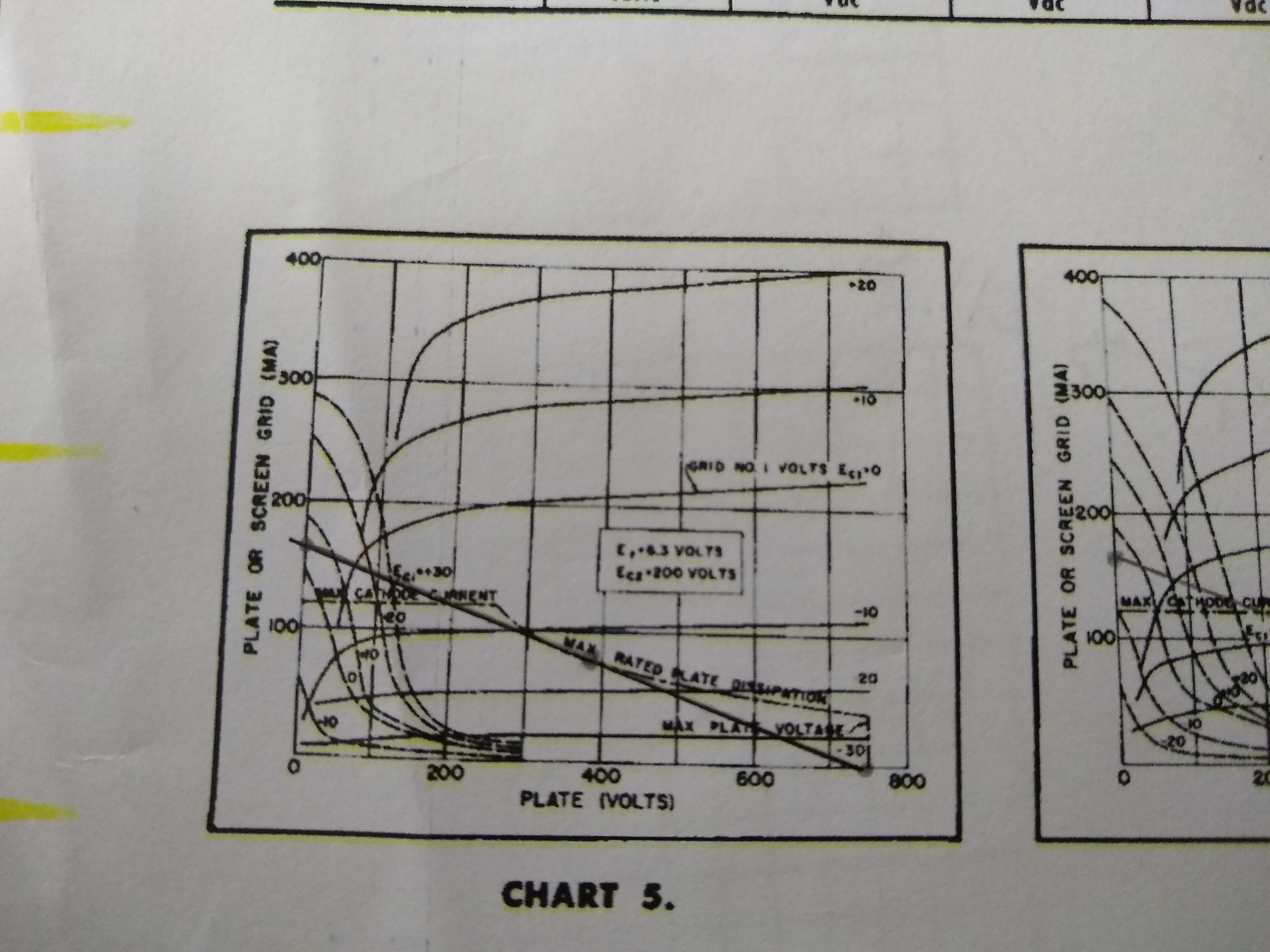

I swapped out the 6EW6 input tube for a 6BN11 last night. My 6EW6s tested good but I did notice that they required higher screen voltages to get Vg=0 up where it should be. The did not match the datasheet characteristics, in other words. They were both used tubes pulled from equipment.
My 6BN11 is NOS and offers characteristics very similar to the datasheet. I did a simple gain test and I was getting a gain of over 700, whereas the 6EW6s were giving me ~550 in the same circuit. The datasheets indicated that these tubes should have pretty much identical characteristics, which mine obviously do not.
I also really like the looks of the 6BN11 as well. Both tube types have a very open plate structure but all of my 6EW6s have a smoked glass coating on the inside that hides it (which probably improves performance somehow but I'll be honest, I'm designing with tubes because they look cool, seeing hot cathodes and grid wires is a plus).
