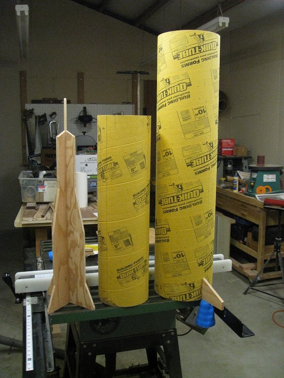

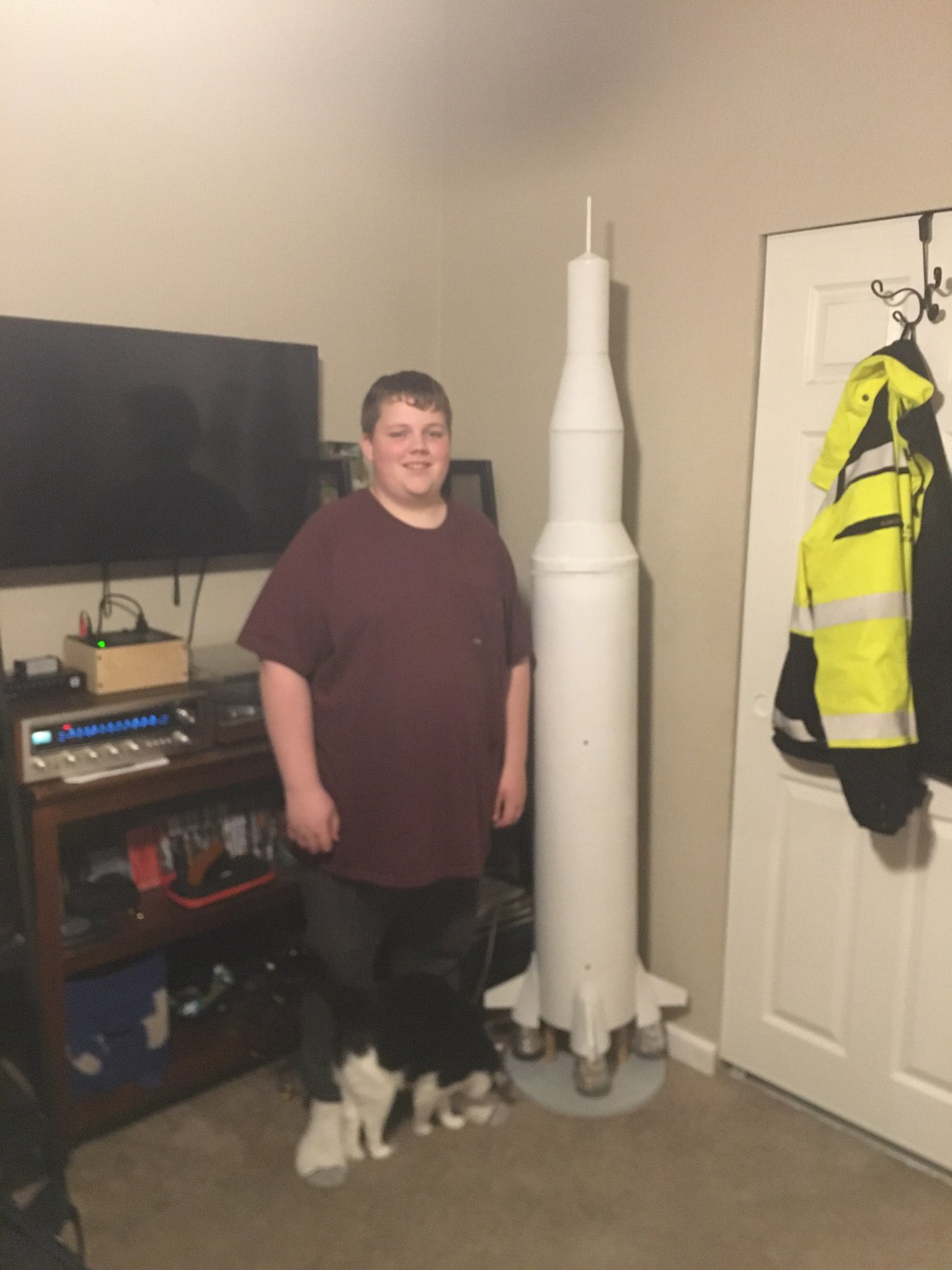

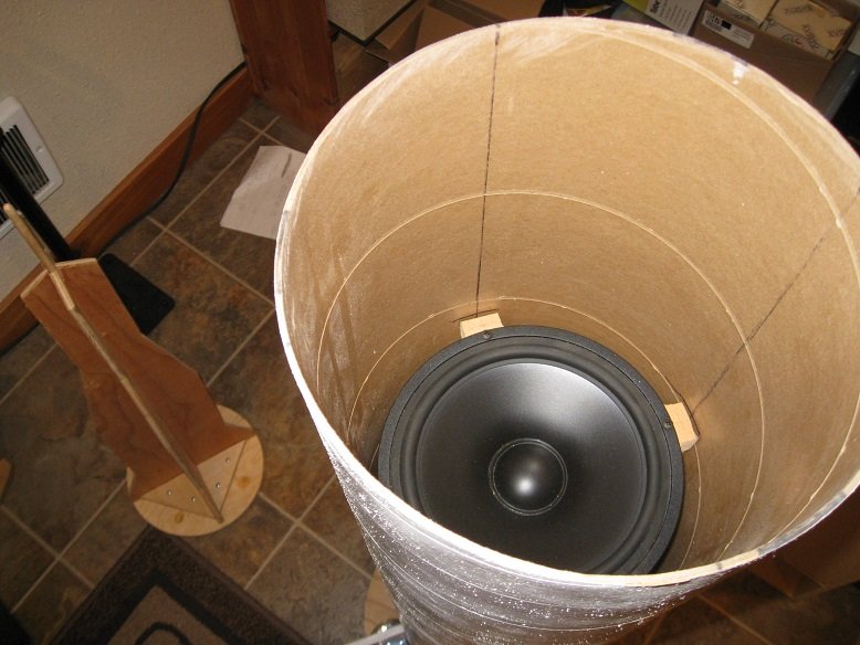

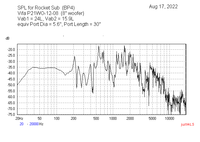

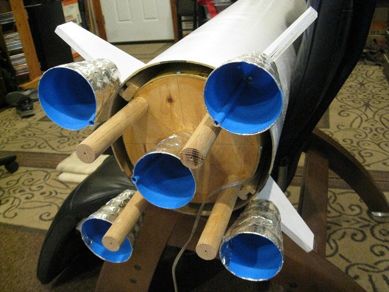

The grandson had a wild idea to make a Rocket Sub a couple of years ago.
It's a 4th order bandpass design, using an 8" up-firing woofer mounted on a sealed cylinder, and inside a 10" vented cylinder. Quik Tubes (concrete form cardboard tubes) were used. The space between the tubes acted as a vent.
Sippy cups wrapped with foil tape were used for the engines.
A large paper cup was used to make a pattern for the fin fairings. The cup was cut at an angle with the bandsaw. The cut piece was flattened out for a pattern.
The -3 dB pt is around 30 Hz - better than the simulation. Works fine with the bookshelf speakers he has in his room.
Definitely a FUNtastic FUNctional project!

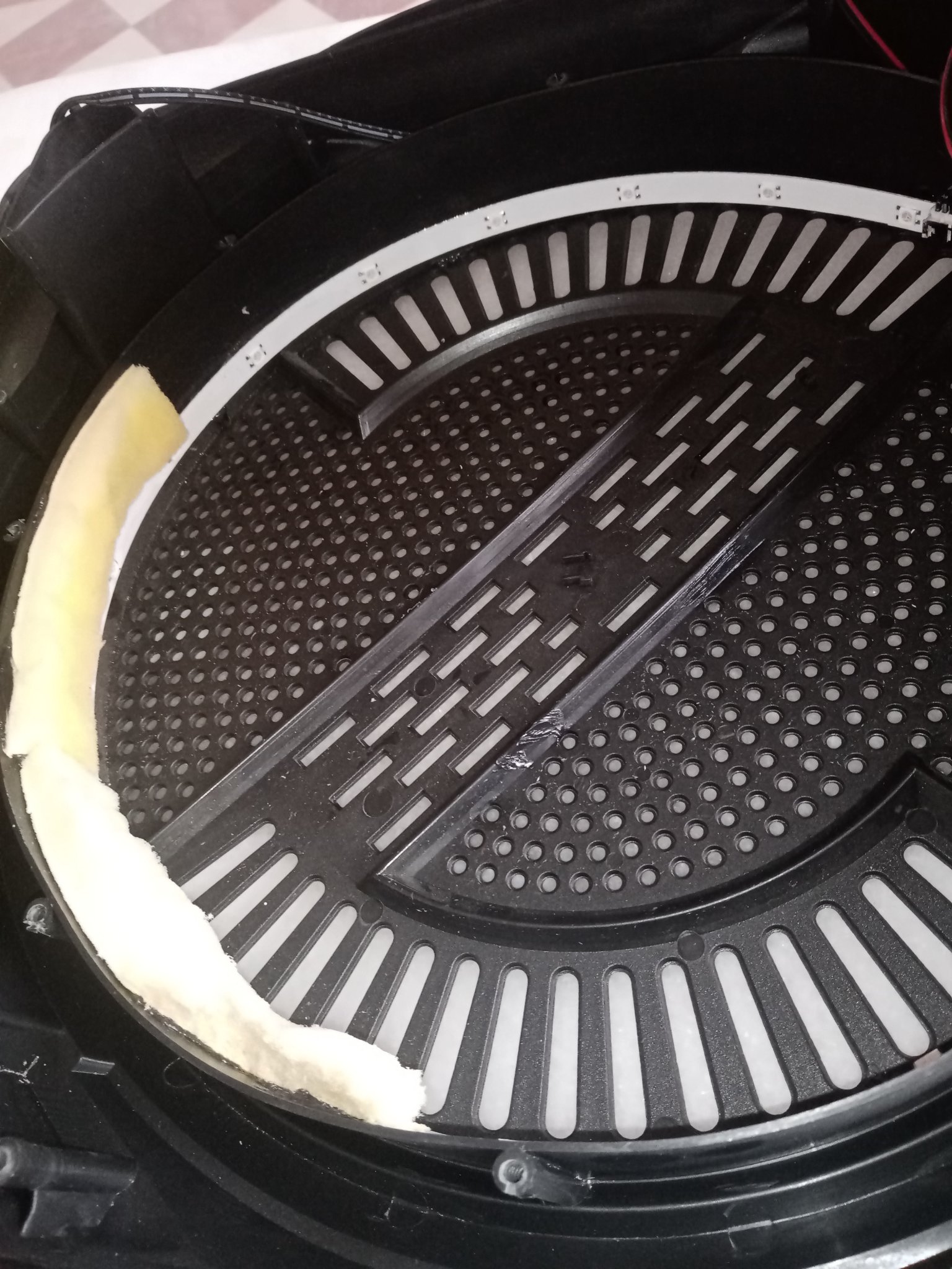

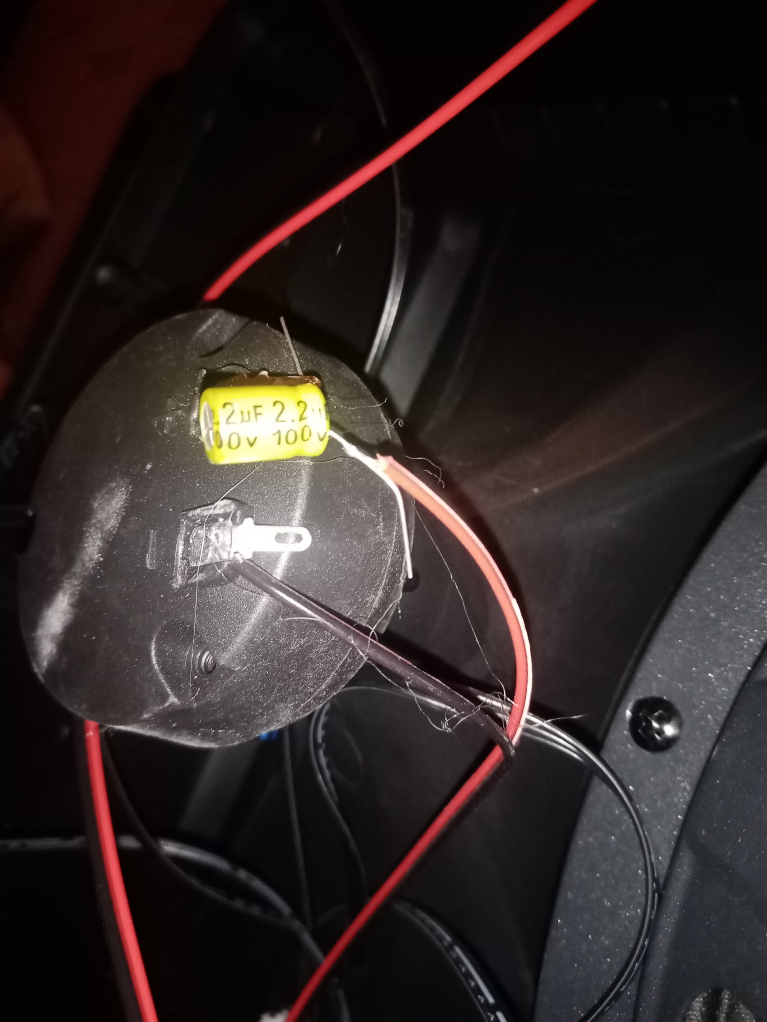

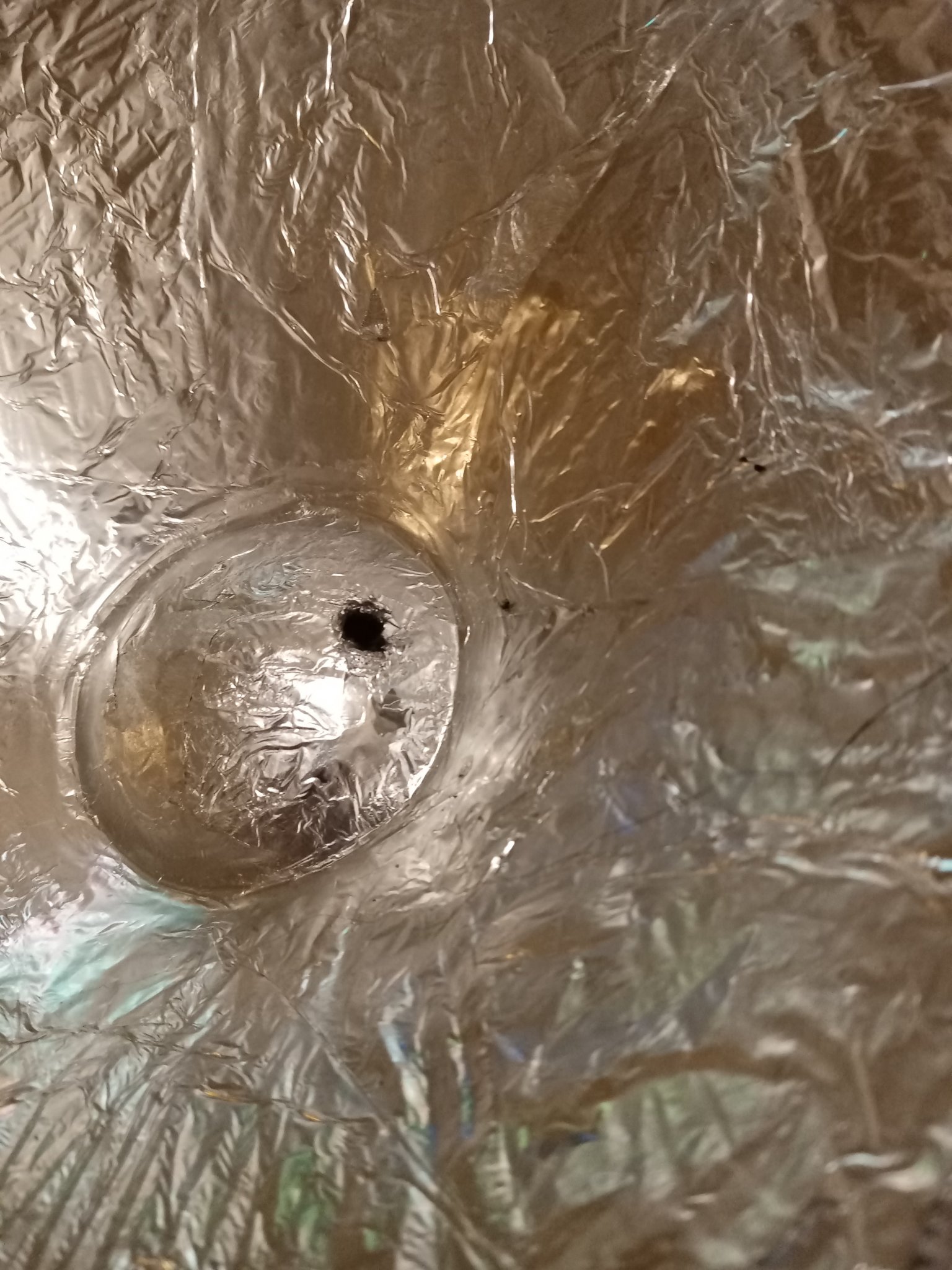

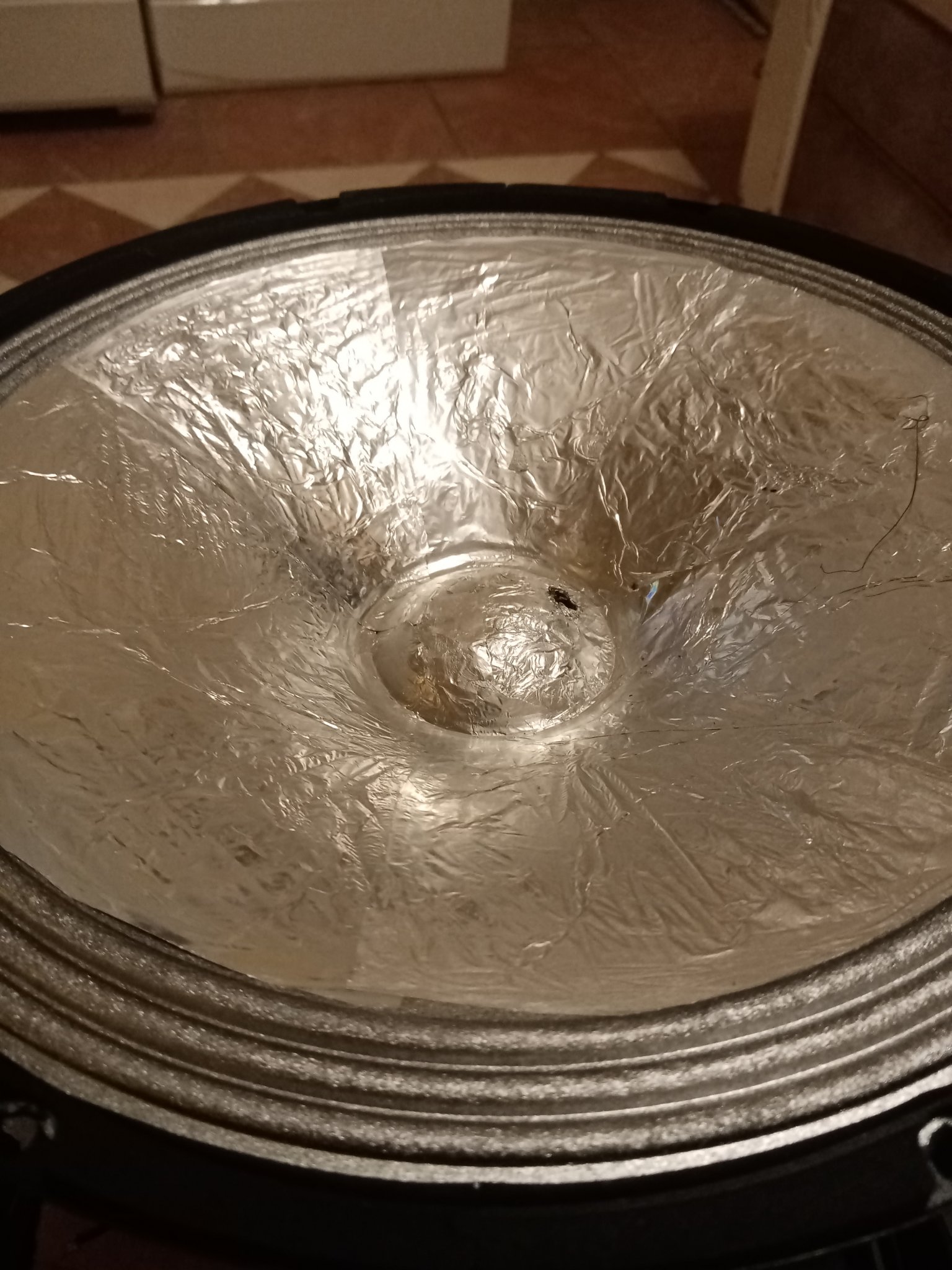

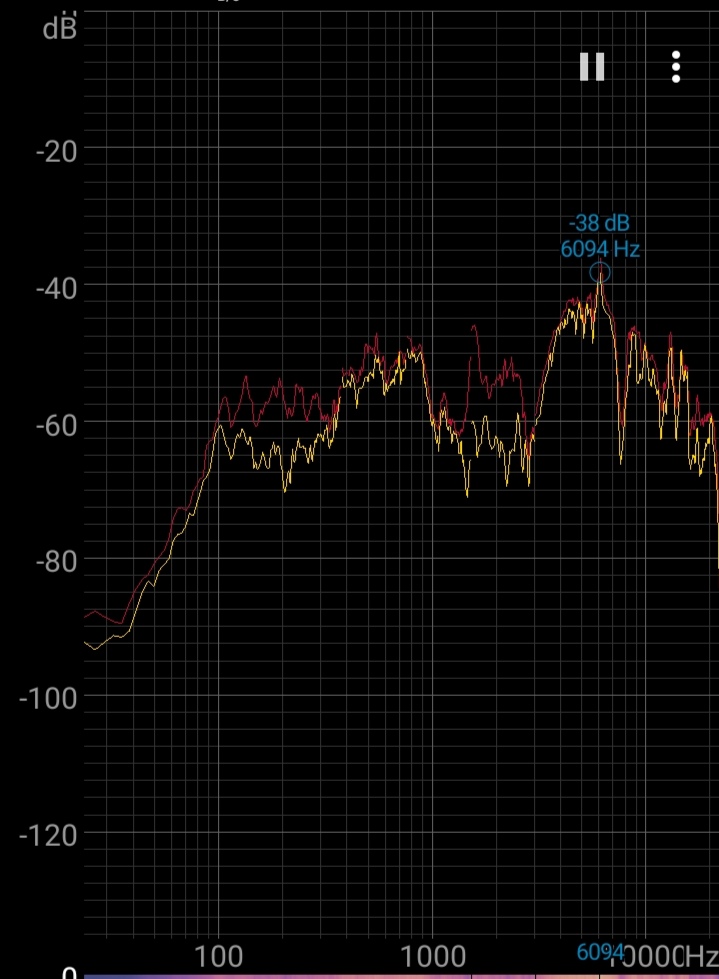

fun loudspeaker portable bluetooth
some info on how I modified it
added damping
added 1 ohm in line with the bass for a little bit of current drive by added resistance
EQ for corner placement (you can really gain headroom like this!)
EQ for against back wall

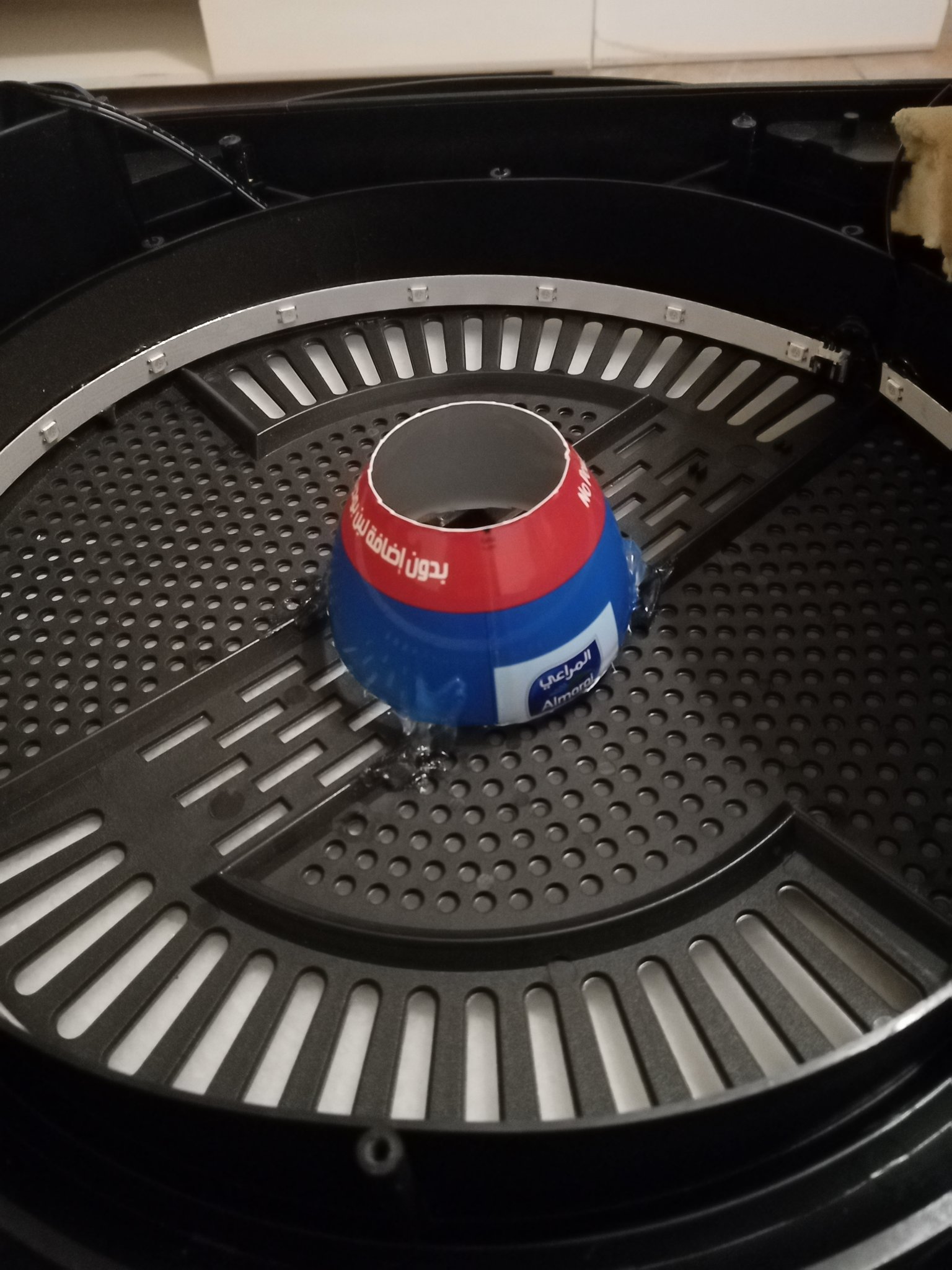

testing a
dispersion / diffuser / waveguide element
in front of the 12 inch driver.
Sound could be more "warm" with more mids.
Maybe it will do some good.

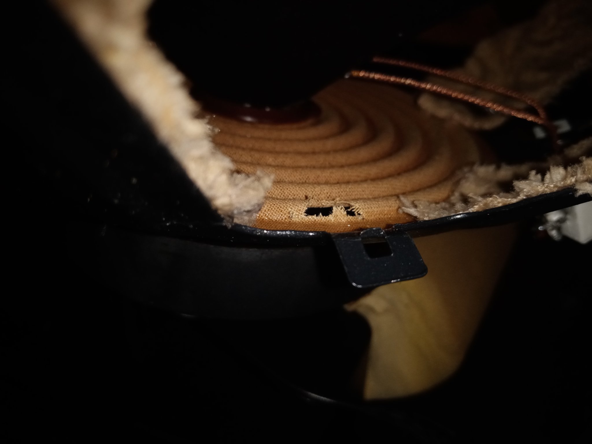

Its attached to the protective grill not the driver
ventilated the dustcap and yellow spider, subtle but clearly more articulate sound
opening facing downwards hoping it collects like this less dust.

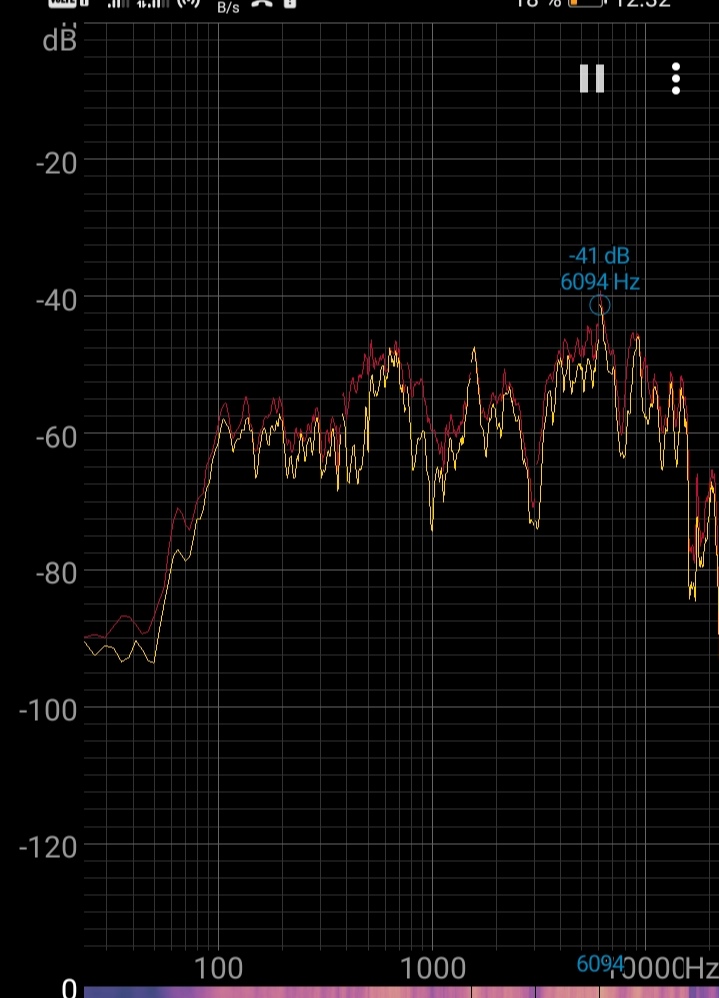

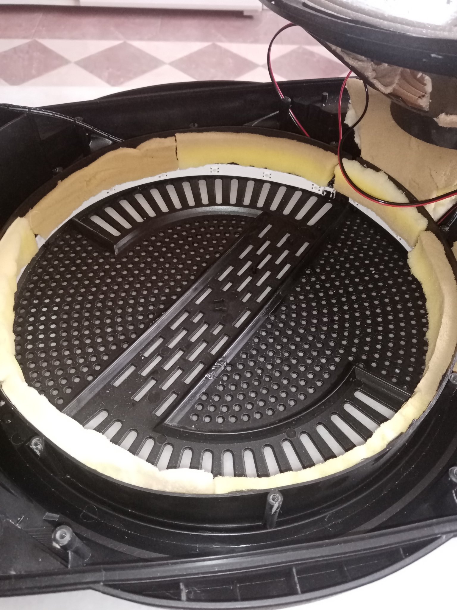

now I found the solution to remedy the "cold" sound presentation:
damping the 5cm high plastic surrounding. Together with a grill not much transparent there are vagabonding resonances like in a cavity murking the sound.
Now the mids come much better through fullrange speaker alike.
Again in the frequency response not much change maybe in the burst decay which I did not measure.
since the BBC LS 3/5a we know that edge diffraction influences the sound.
Remedy applied makes a big sonic difference.
