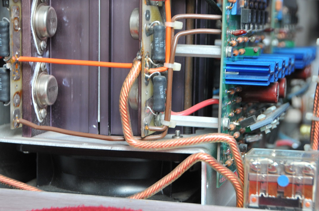

On the schematic of my amplifier there are two feedback caps (C2 & C3. 1000uF). I do know that these 1000uF original darkred Roedersteins (see pic)tend to dry out and it would be good practice to subtitute them with new ones, I bought four new Panasonics FM 5000uF but be honest I do not know how the work in this schematic. Somebody told me the value in F dictates the cut-off frequency and the higher the value the lower this cut-off frequency and it would enhance the bass of the amp. Can anybody explain to me how it works and how important these two capacitors (or maybe also the parallel .1 uF Film cap) are.
These caps are in the feedback network to lower the amplifier gain to 1 at DC.
This is done so input stage DC offset does not appear at the output multiplied by the whole amplifier gain, but only with a gain of 1.
Value is not critical as long as it is large enough. The caps you picked will work just fine.

From a quick look at the schematic, the capacitors you are talking about set the time it takes for any DC offset at the output at the amplifier to be servoed out. This happens at below audio frequencies. Increasing the capacitors by a factor of five would be expected to make the DC servo five times slower. Maybe not a good idea depending on how fast the output offset drifts with temperature variations of the output transistors and other parts of the circuitry during normal operation.
Generally speaking, its probably not wise to substitute parts of different values with original parts without doing a careful analysis of the expected consequences. What I told you is just off the top of my head, and insufficient to make a good decision.
EDIT: The smaller cap is there because the electrolytics have high impedance at high frequencies, thus at 100kHz, for example, they are not good capacitors. Therefore, at high frequencies a good low impedance path is provided by the smaller capacitor.

Higher capacitance will have lower bass respons. But it is not wise going too high as the effect on sound will not be preferrable (higher internal inductance). In your amp, 470uf is fine. 2x 1000uf in series will form 500uf bipolar. Bipolar is expected to be better than a single 470uf. So replacing this with 5000uf will degrade the sound.
I dont usually parallel feedback cap with smaller value, unless i use low quality one, which i dont. The small cap might improve definition tho. I just prefer going with small pcb footprint.
The voltage on feedback cap is very small. I doubt that you need to replace it even if the internal temperature is very high.
