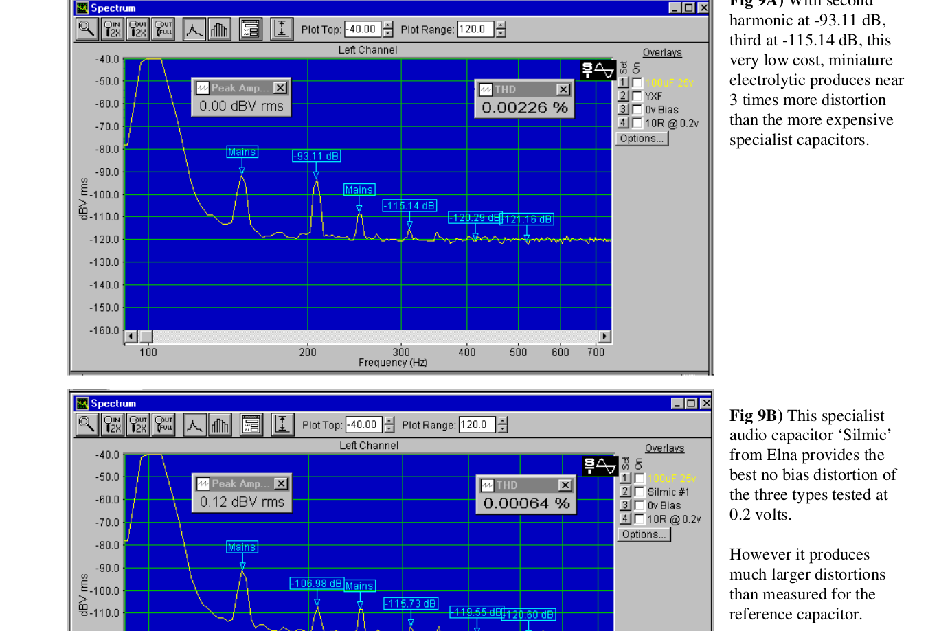

Back to capacitors, over the years I have read a lot of published work about selection of appropriate capacitors. All manner of a capacitor's innate mechanical, electrical, chemical and dialectric properties can make it suitable or unsuitable for a particular application, including audio.
I have also read with interest how capacitors constructed of different materials and dialectric, with different methods of assembly vary quite enormously in nonlinearity and harmonic distortion and how those nonlinearities can be significantly affected by both AC and DC voltage levels across the capacitor. These effects are quite easily measurable with appropriate equipment, and are routinely by capacitor designers. It would be unprecedented if capacitors didn't influence sound, not the other way round.
I have not seen published peer reviewed "science" that proves, or even attempts to prove, that differences in the sound of capacitor are inaudible. If you have read science on which you have based your proposition, you must be able to point to something in support. I am very keen to broaden my knowledge and look forward to you posting references.

Where is the science which supports the the claim that perceived improvements from replacing crossover capacitors are nothing more than confirmation bias. Please share the source of your adamancy.
It is well known that vibration can modulate the value of capacitance of some constructions of capacitor. If such a capacitor is used inside a loudspeaker cabinet there is a known and scientifically understood mechanism whereby that capacitor will alter the signal passing through it compared to a capacitor that is not subject to this mechanism. This is not voodoo, it is the natural consequence of the application of the laws of physics.

With regard to capacitors please show the actual tests where vibrations in cabinets have been proven to change the sound from the drivers.
Thanks. Waiting for your data.
