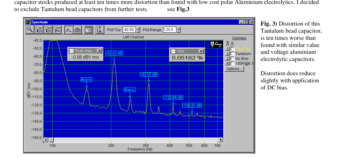

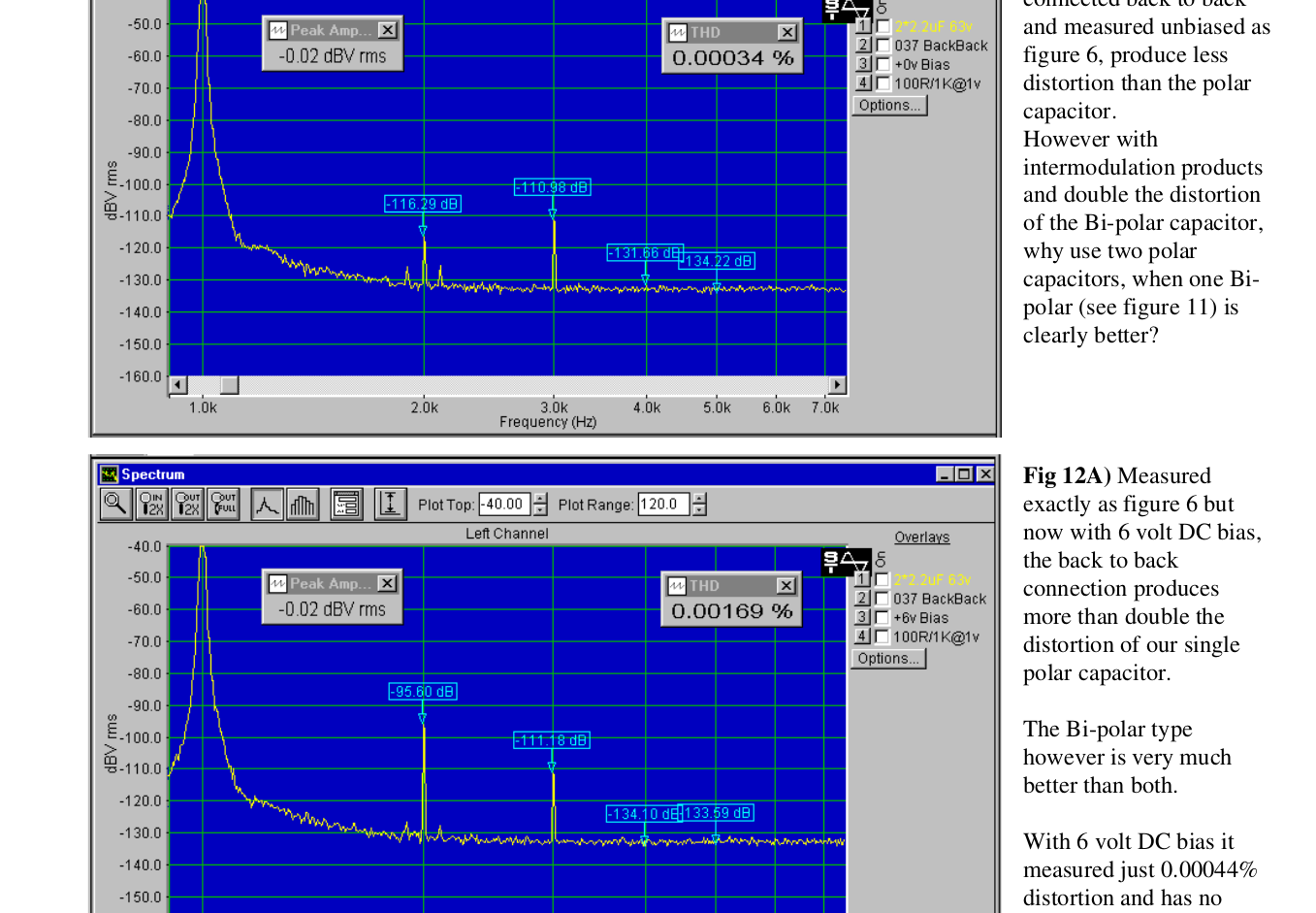

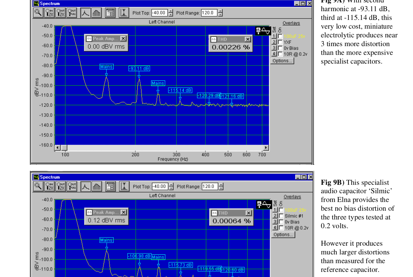

what caps do....that's for you classicalfan
Interesting, but need a lot more information about the test conditions to be able to know whether this has any affect at all on speaker performance.
How were these test run, what were the capacitors connected to, etc. Graphs alone don't really tell you much.
