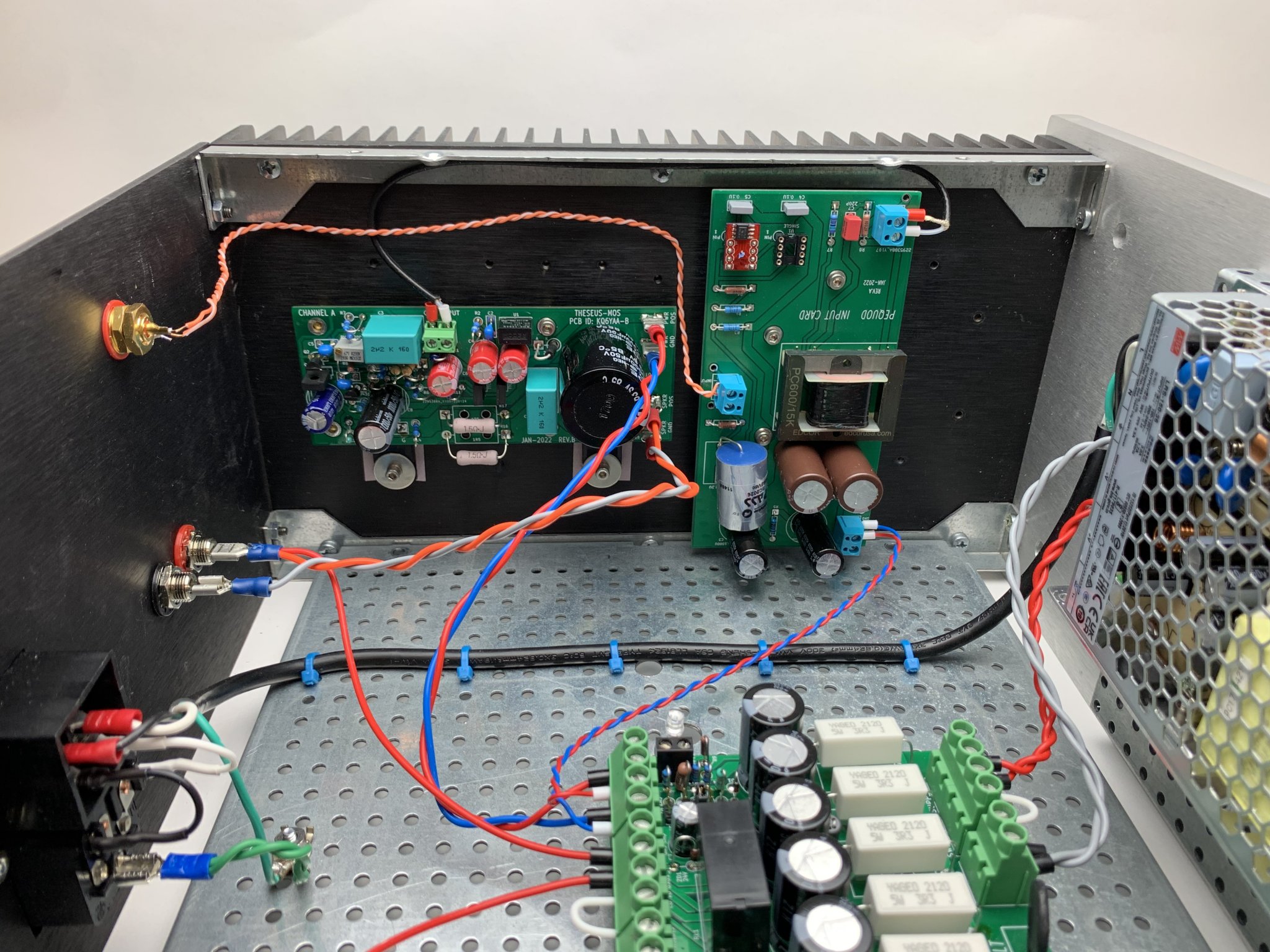

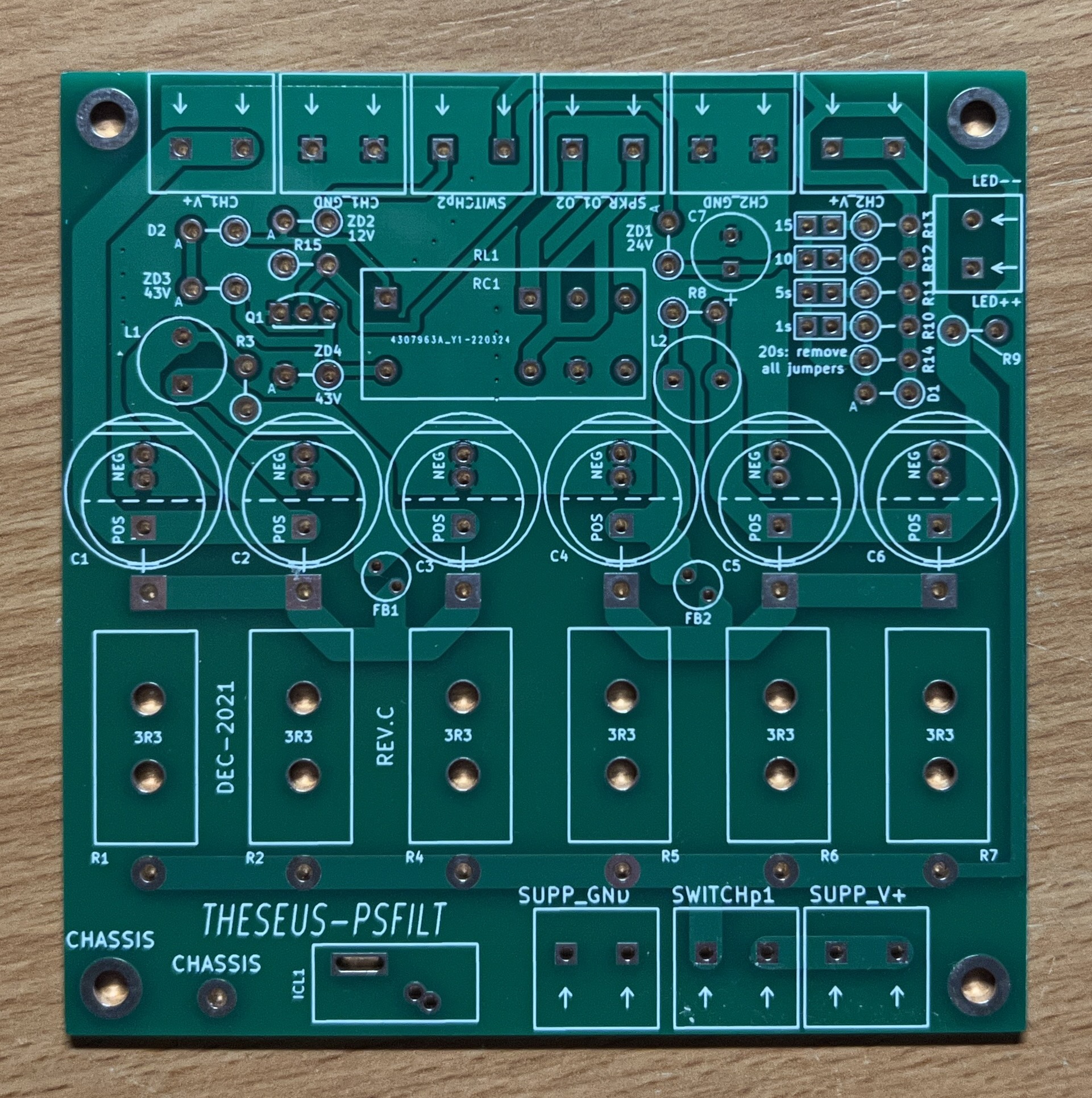

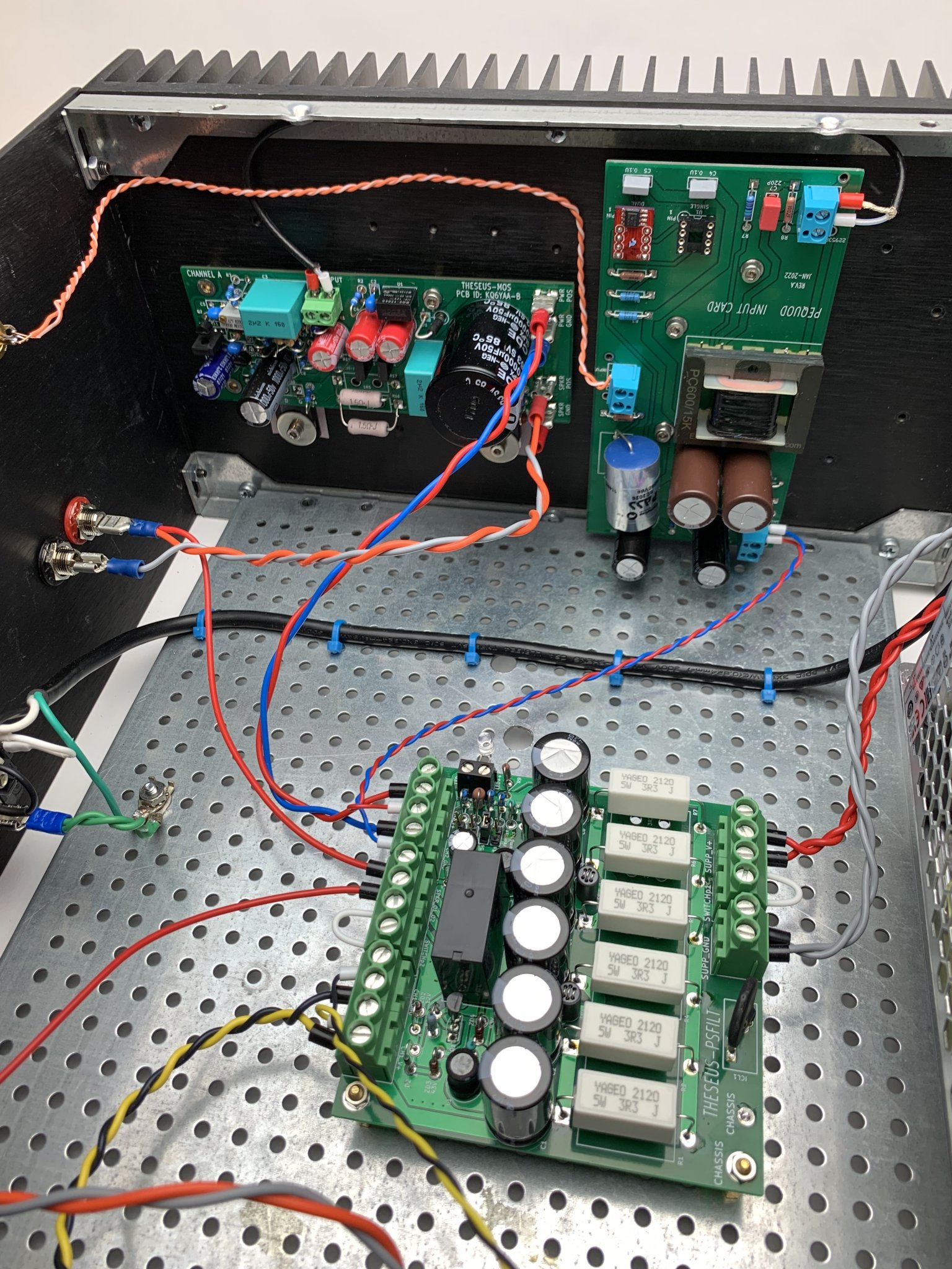

alternativeGetting to play with the Theseus MOS output stage, currently driven by the Pequod input stage. Power from an open frame 36V MeanWell filtered by Theseus-PSFILT SMPS filter and power on/off de-thumper.
Although I've only listened so far for a few hours, this sounds truly excellent! I’m very pleased with this project as a whole, the possibilities are almost unlimited for tinkering and trying a large amount of different circuit topologies and other neat things.

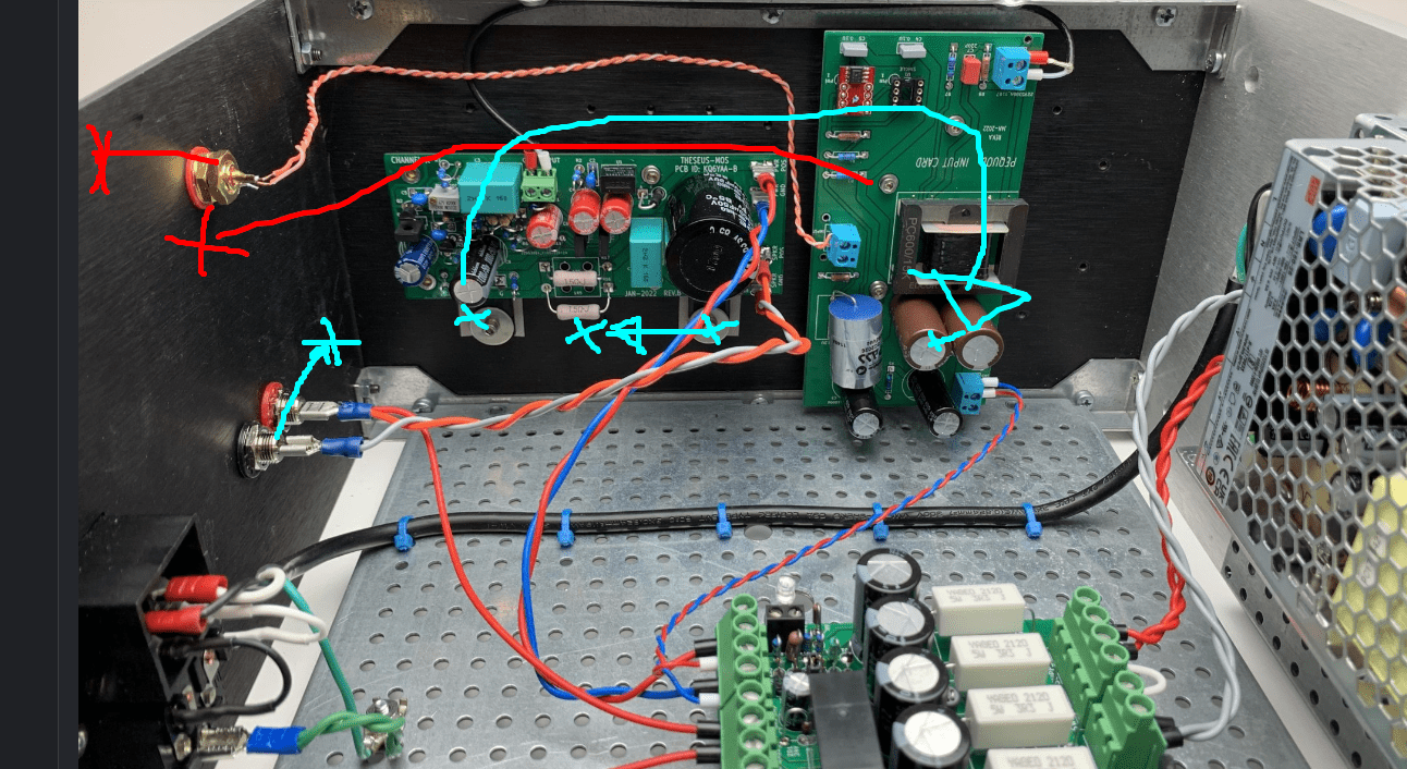

@nicoch58
?? Not understanding what information you are trying to convey.
Yes, there are a lot of different ways to hook up the wiring. Also it seems that daisy-chaining the V+ on each channel may be quieter, however like everything in regards to wiring and grounding, try a few different schemes and when you happen on something quiet, stop. 🙂
@ranshdow Yes, will happily measure when I get home. I think it may fit in vfet chassis. (Though honestly, in that chassis I’d rather just use the brick… ymmv) There’s also a 200W MeanWell open frame on my bench that has better mounting hole spacing that’s worth a look at.
well input stage near the input and not near the psu ....short cable and better routing@nicoch58

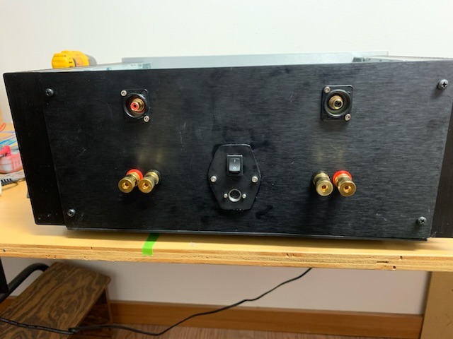

So I am using the 4U chassis to build this amp. But I find now that the back panel connections are not designed for the VFET amp, and thus there is no input for the Meanwell powersupply and the on-off switch is not right either. Also I have built a Missouri FE board and I need a couple of XLR inputs. So after a couple of hours research I came up with the following order from Mouser. I will post it here for those who might need to do the same. Item #3 is optional, maybe I will mount it on the front panel like the ACA. There are two DC power connectors so I can make a external power supply to test the various boards with before I power up the amp.

I used one of these to cut the holes for XLRs before on a Modushop chassis
SagaSave 24mm (16-50MM) Sheet Metal Punch Hole https://amzn.eu/d/5W7hOKn
Check the size is right for yours, but it did the job perfectly and much better than a stepped drill bit would have
Thanks for the tip. They are inexpensive too. I am familiar with these, as a retired Sheet Metal craftsman, I have actually used these in work situations. At our shop we had a set of these, SAE of course, for punching holes for electrial fittings into custom electrical boxes.
I will have to replumb the back panel a bit….

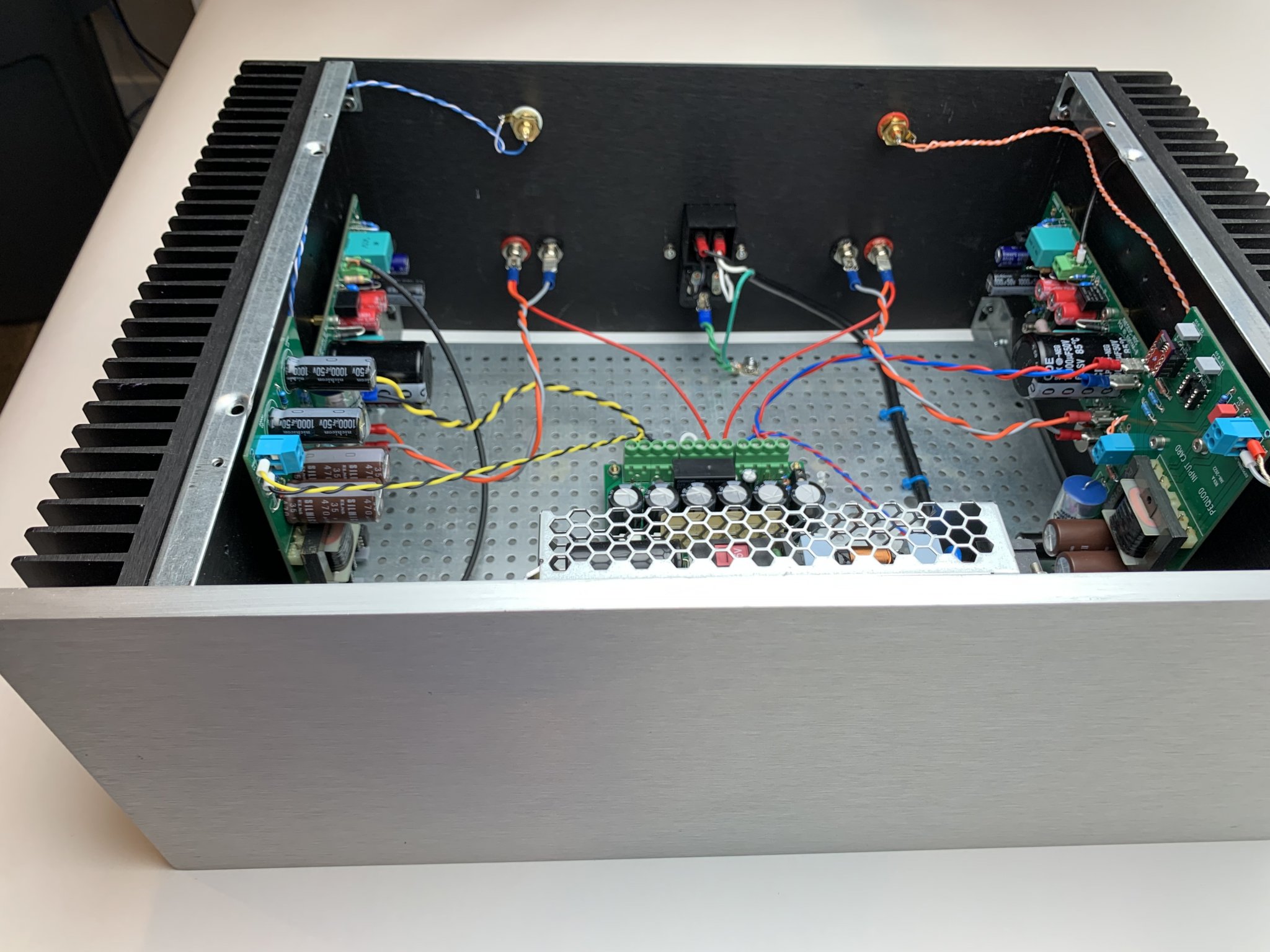

I finished my VFET yesterday evening and got it running. Biased up easily and is running flawlessly today. Sounded a bit rough to me yesterday evening, but I am warming up to it today and really enjoying it. Plays wonderfully at low volumes…wife approved volumes.
Stock NPass output board with 2SJ18‘S, Scourge FE’s, Ship of Theseus PSFilter board. I am using a DIY 4U chassis.
