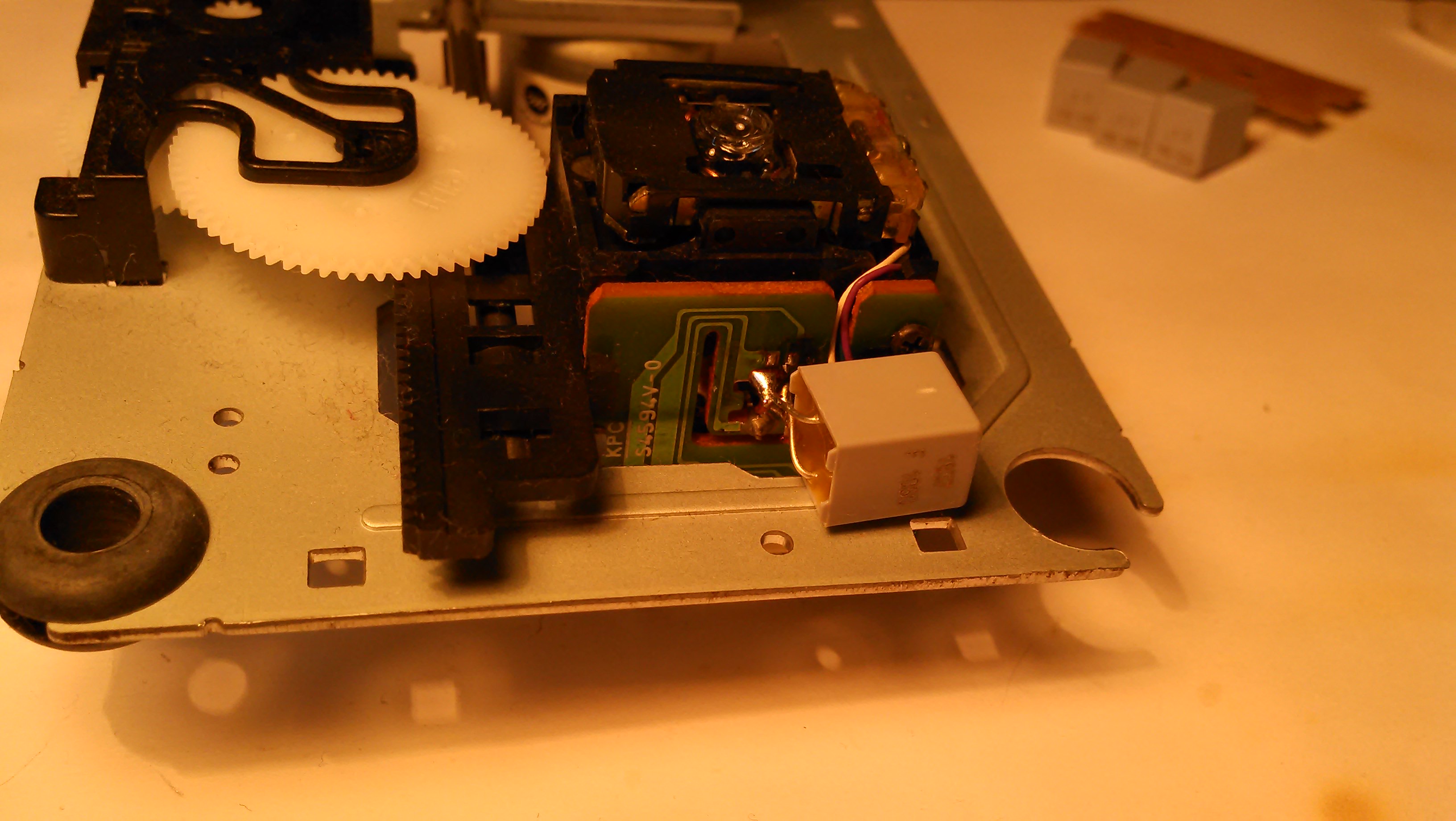

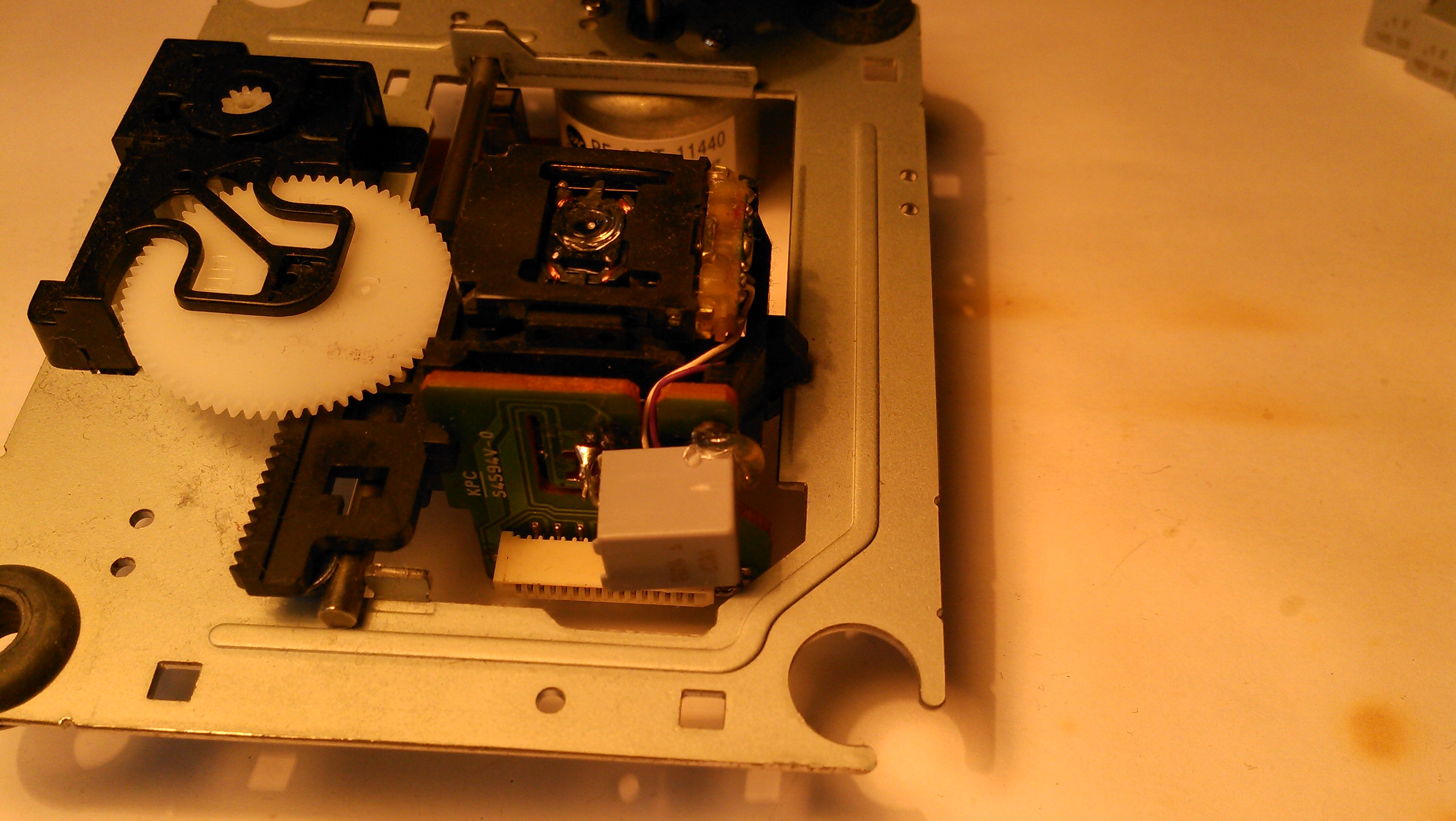

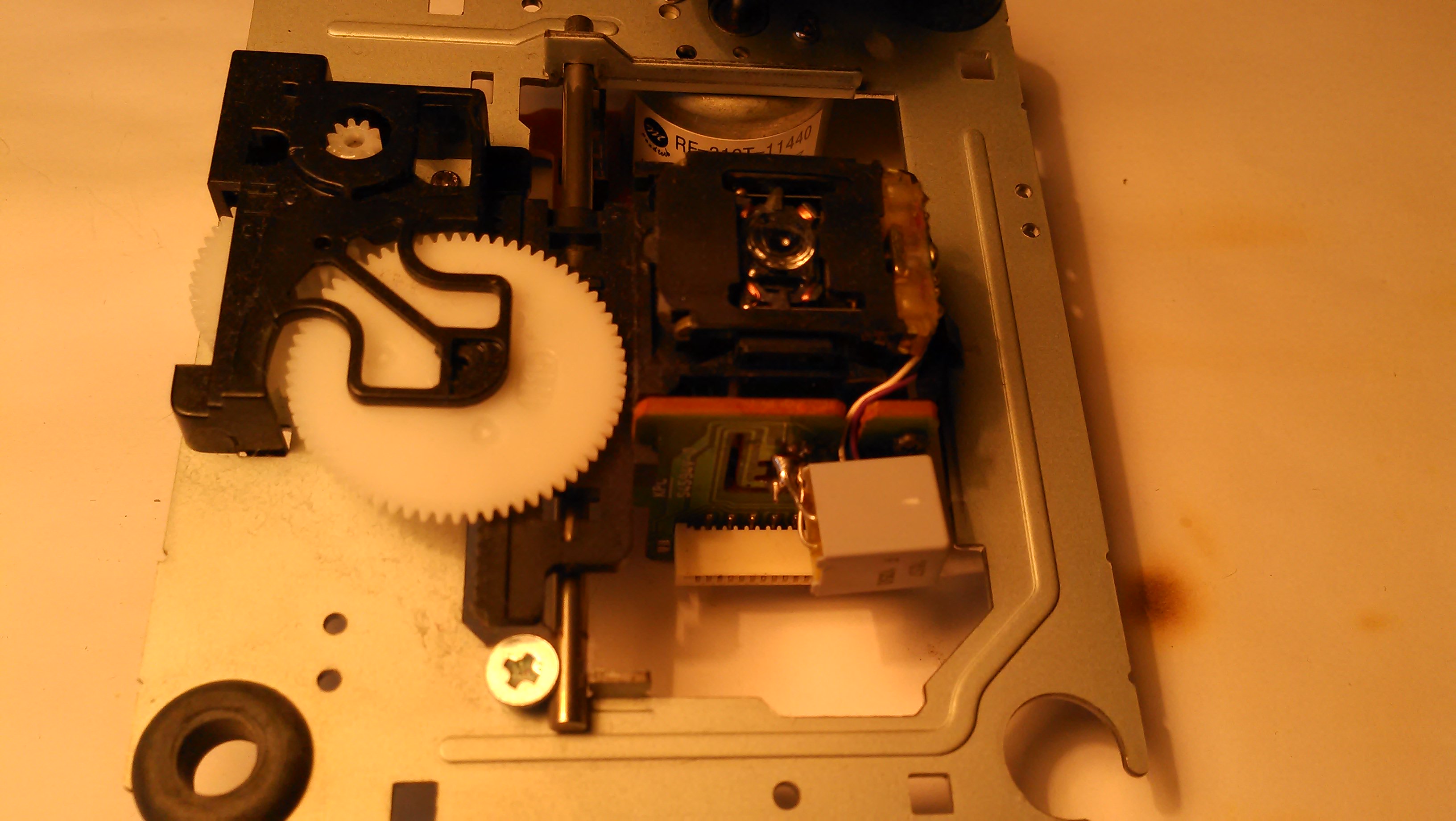

Hi Tibi,
What is the value of Vishay MKP 1837 did you use, 100nf ?
Rudy
Yep, 100nF.
Here is how is mounted.
It can be mounted even closer, with shorter leads, but you need to add more glue to get him rigid with optical block.
Tibi

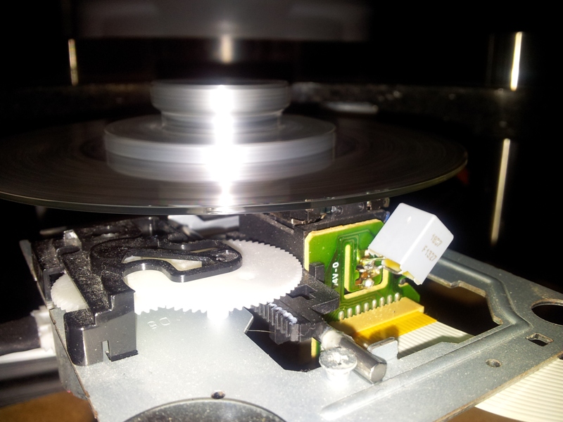

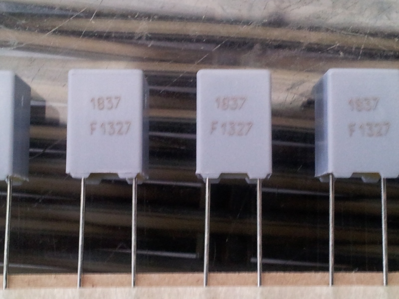

Today is my parcel arrived with the 100nf Vishay Roederstein MKP1837.
I have soldered this evening the Vishay Roederstein MKP1837.
Tomorrow I will listen to what the differences are …
Rudy
Rudy
Thanks Tibi,
With " the best match " , do you mean the Vishay outperformed the silver mica .
It is a matter of taste.
In my system 100nF Vishay give more equilibrium, everything is there, while 1nF silver-mica give more focus and soundstage.
Tibi

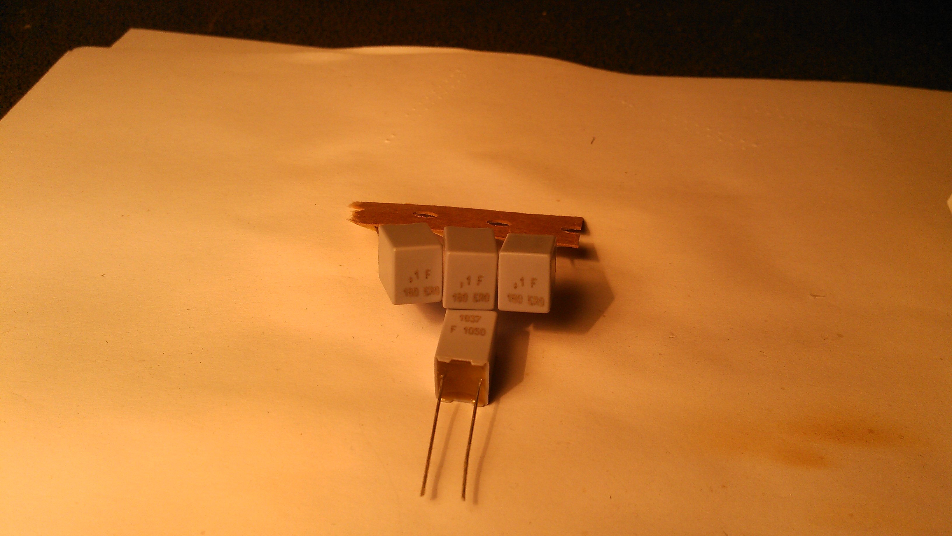

important is the price for this cap is vary cheap.
There is no enough space to put a better cap. 🙁
Vishay 1837 is the best cap which can be soldered in this position, close to laser pins and without affecting mechanic operation.
Tibi
I will make a few different ones and test them how they sound....
EPCOS SIEMENS 0.047UF 47nF 63V 5mm 5% HI-END MKT FILM- CAPS FOR AUDIO
...........we will see........
