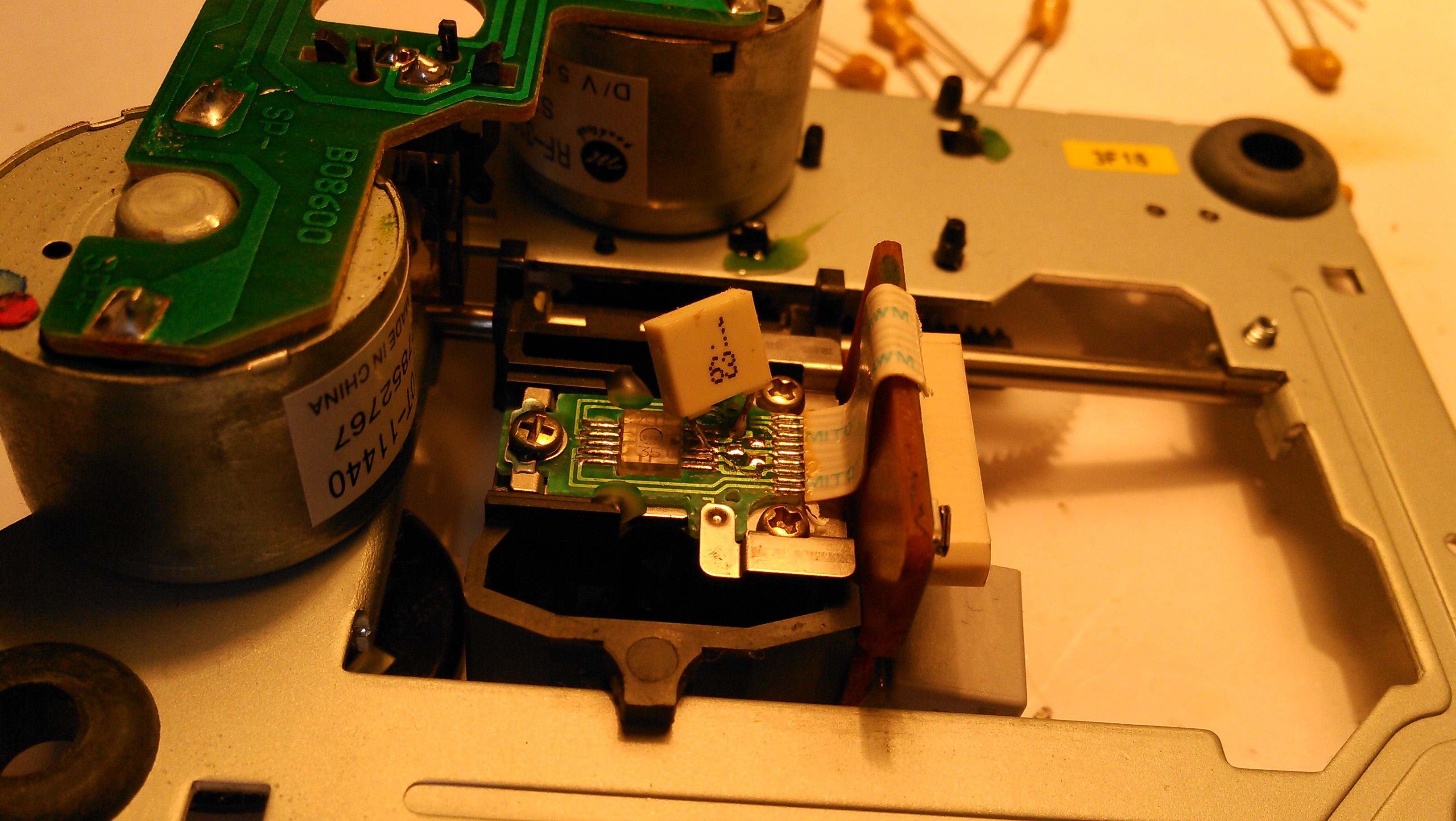

1nF silver-mica in PIN decoupling position. I got huge resolution and detail. I mean really huge. Super trouper mod !
Now optical focus is completely silent. Tracking is ultra fast. TOC reading is almost instantly.

Shiga MKII already have on PCB possibility to add a 1nF silver mica for 2.5V ref, therefore I left for Vref 100nF Arcotronics MKP.
For PIN amplifier decoupling I used an 1nF/100V silver-mica. This is the one who make a huge difference.
This cap changed everything, resolution, dynamics, speed etc. It's like I have installed a super clock.
With all these mods, now Shiga MKII it's so involving, like a very good vinil.

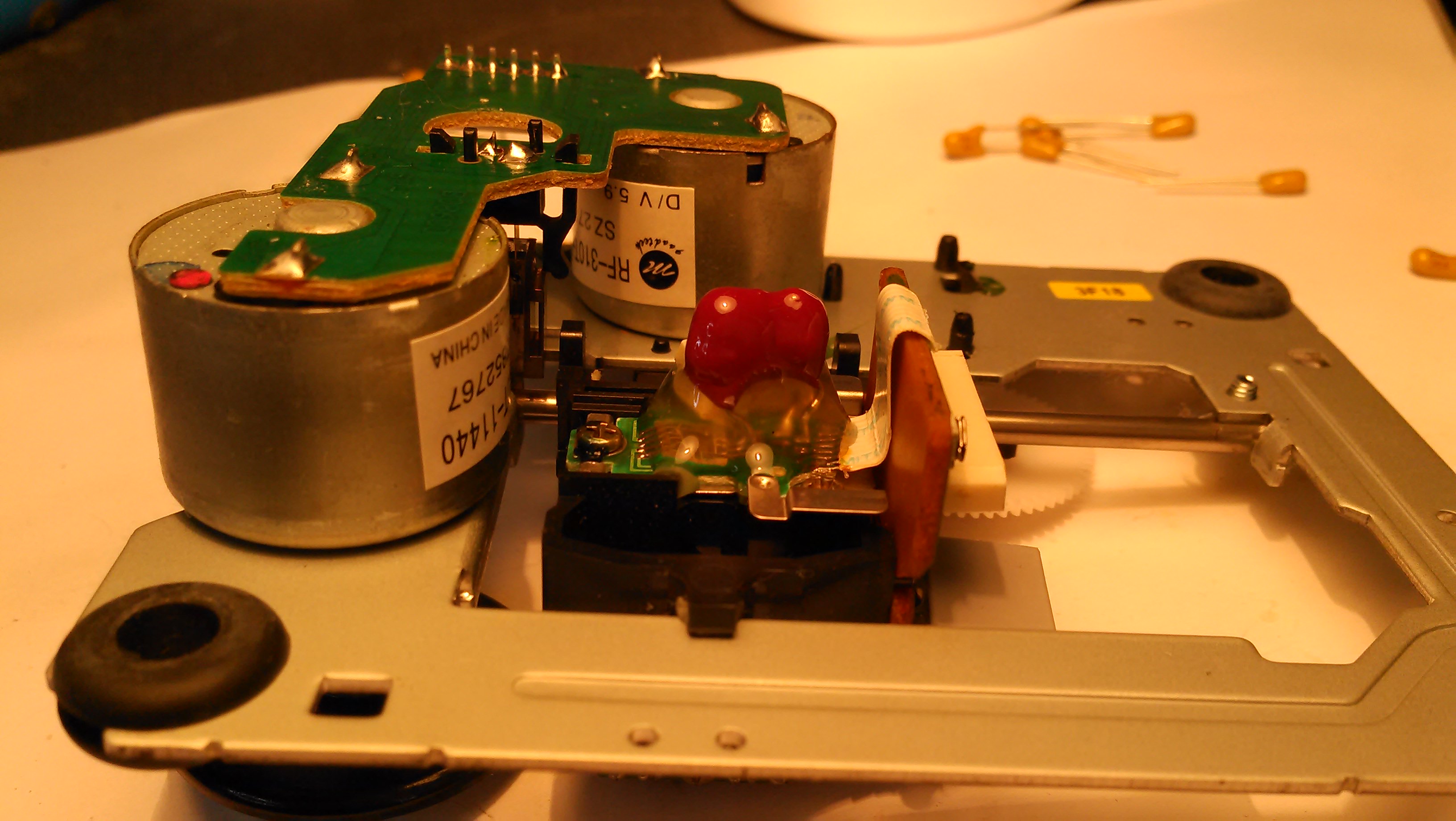

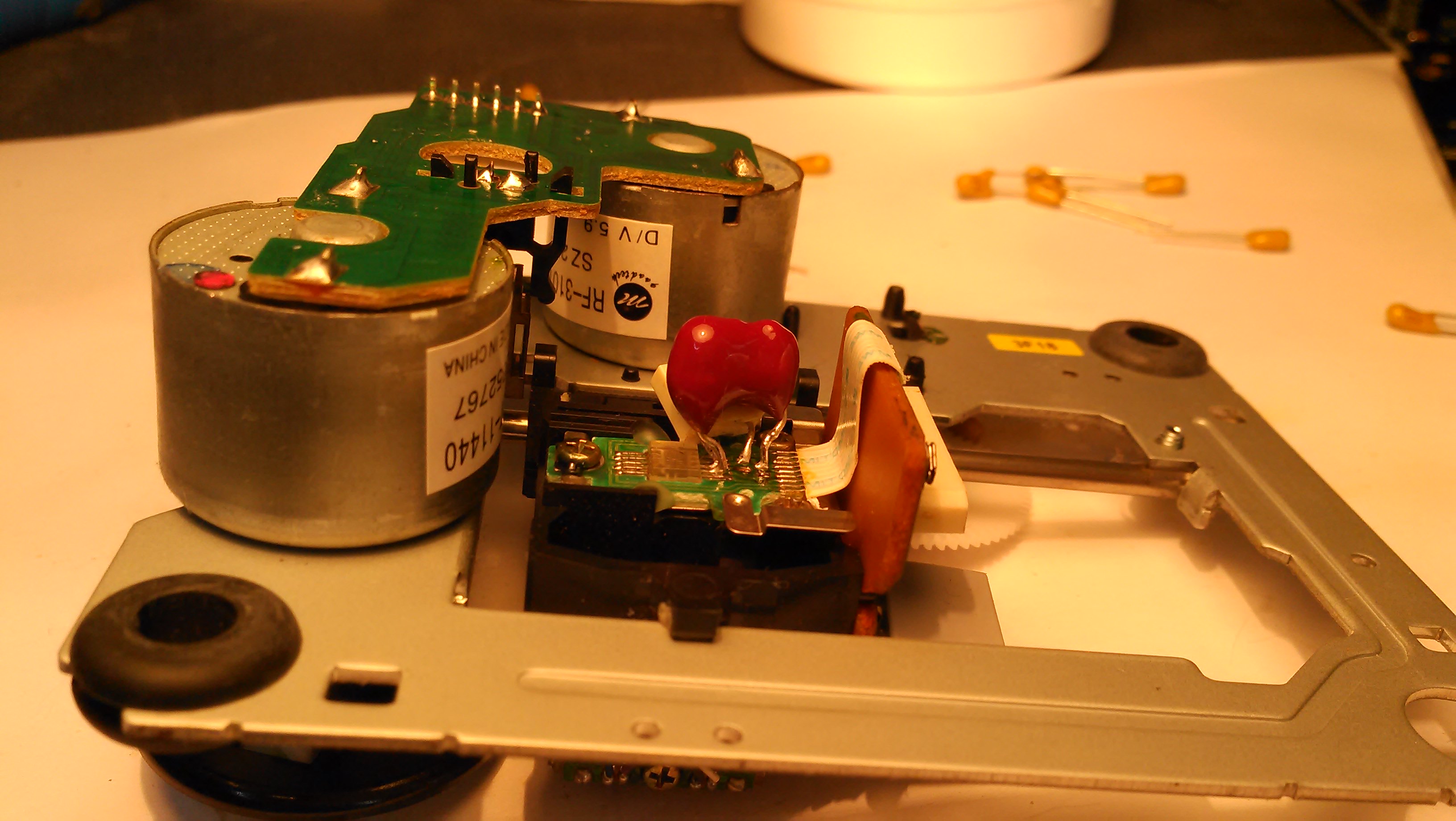

What's the glue you use to enclose the parts on that last photo?
Kind of silicon compound?
Silicon glue.
Tibi
Aah, nice and easy to use I believe?
Hold the stick near and warm it up so it drips in place?
Easy to use but better with a glue gun.

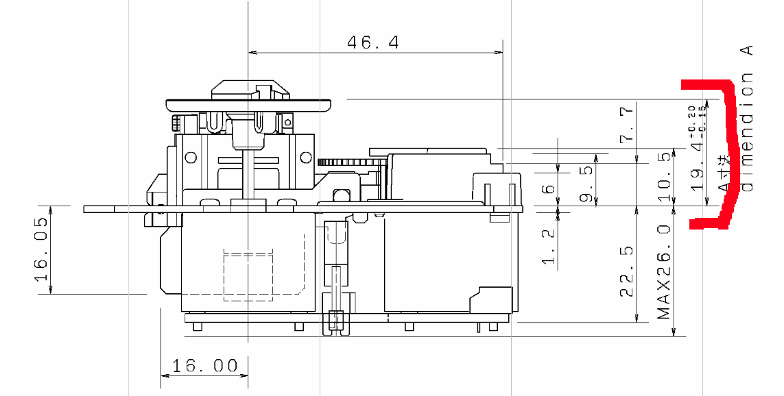

Danzup, hope you don't mind another question. I'm having trouble waking up my shiga and want to make sure I have all connections correct. The six point connectors are oriented by the terminals marked with '1'...correct? In other words, the '1' terminal on the board should connect to '1' terminal on the mechanism...right? Thanks. Kind regards.
Six wire cable for motors is 1 to 1 - '1' terminal on the board should connect to '1' terminal on the mechanism.
If you followed this thread, than 3 wire cable for CD TOC reset is 1 to 3, 2 to 2 and 3 to 1.
Other things to check.

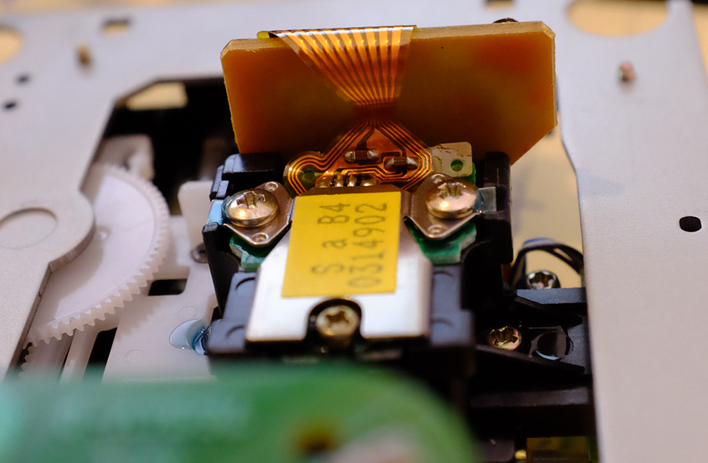

- optical ribbon cable connector do not be reverse soldered- see pictures in this thread
- remove laser protection bulb from CD mechanic
- distance between turntable and CD mechanic to be 19.4mm - see attachment
You may post here top and bottom high resolution pictures, so I may have a look.
