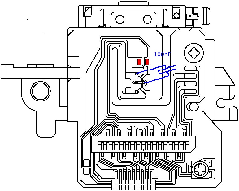

This 100nF cap is there to kill any kind of noise, not only from power supply, but also from and induced RF trough ribbon cable.
The main rule is that whatever you put there, must be connected as close as possible to laser diode.

As I said the cap is 100nF X5R.
Almost any capacitor will be better, but must be small enough do not affect mechanic operation. Also big caps with long leads are out discussion here. The cap must be as close as possible to laser.
My choice is Arcotronics MKT. It is good, cheap, have exceptionally low ESR, and small enough to be soldered directly on laser pins.
Another candidate could be VISHAY-RODERSTEIN MKP-1837.

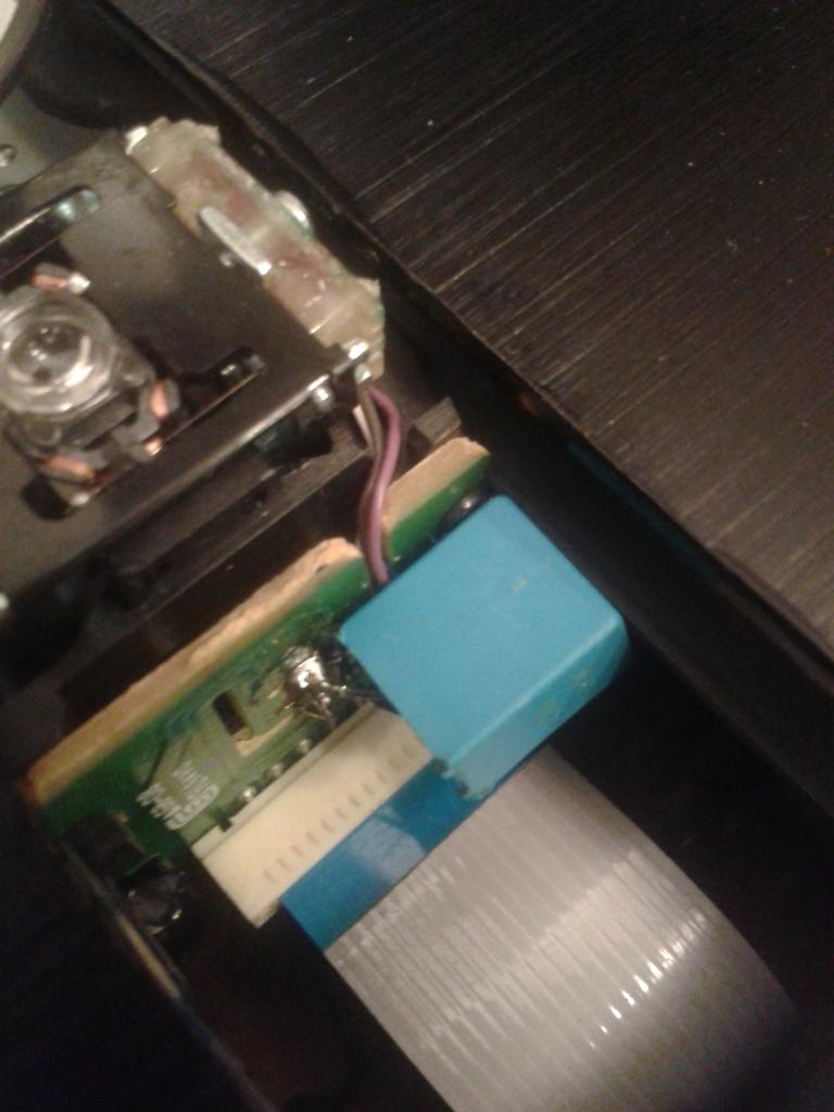

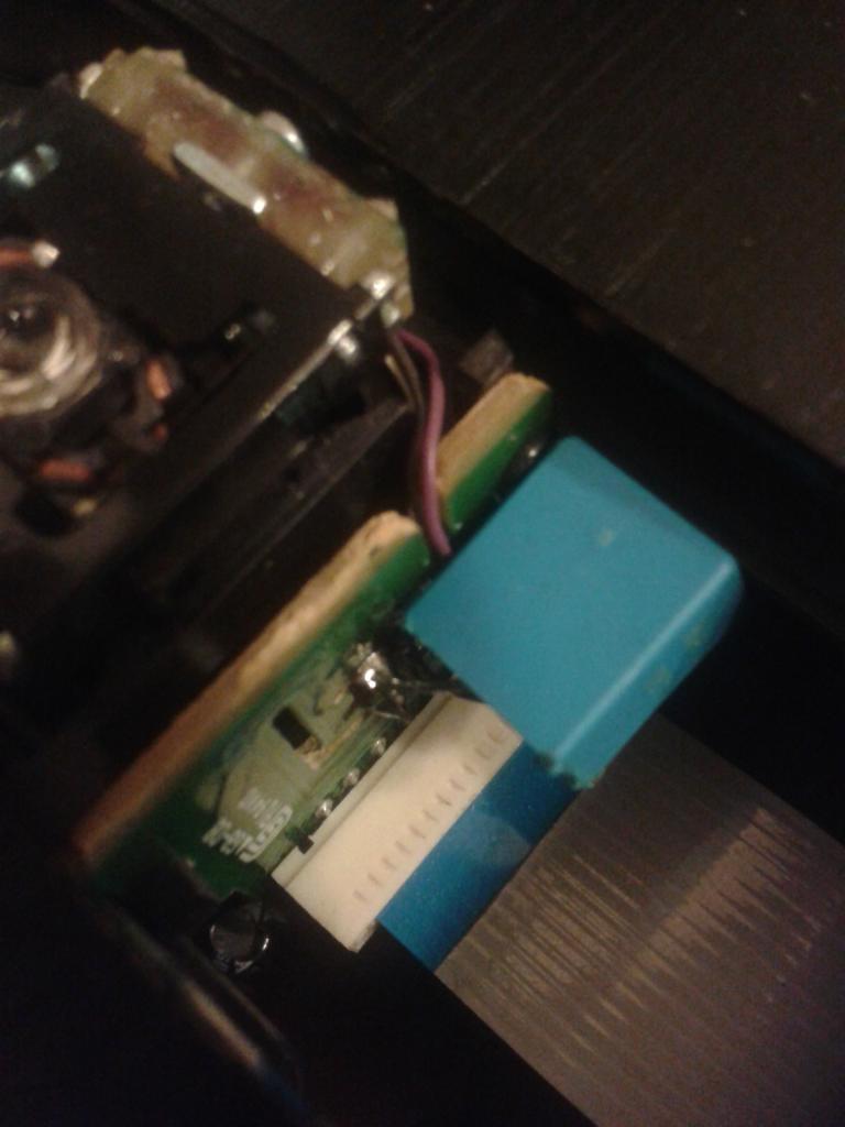

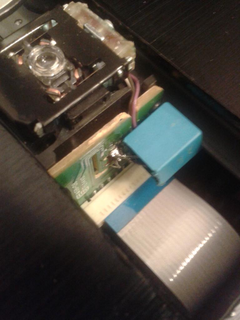

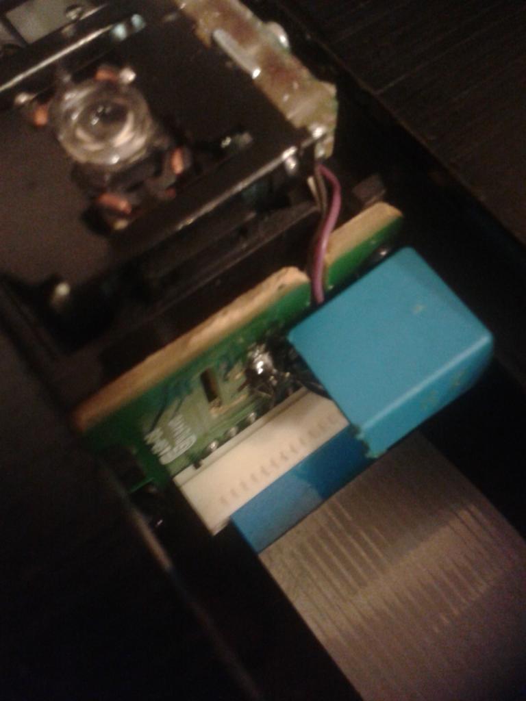

Thank you Tibi,
5 minutes work and here it is the MKP1837 on laser board .
Sounds really good ,there is more control of everything but the most is the better control of sound stage,a more sharp image.
its deffinitely worth this mod
