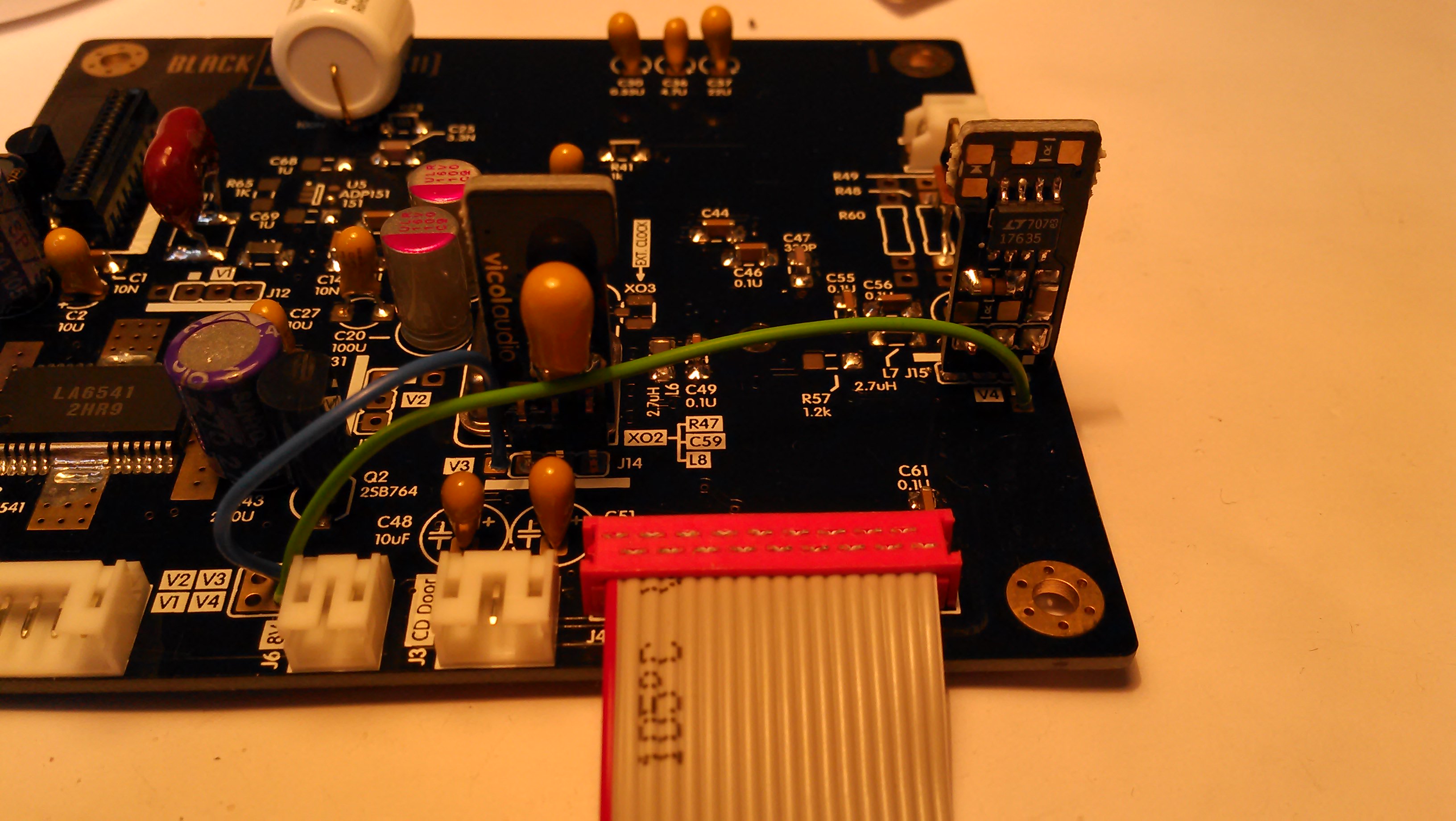

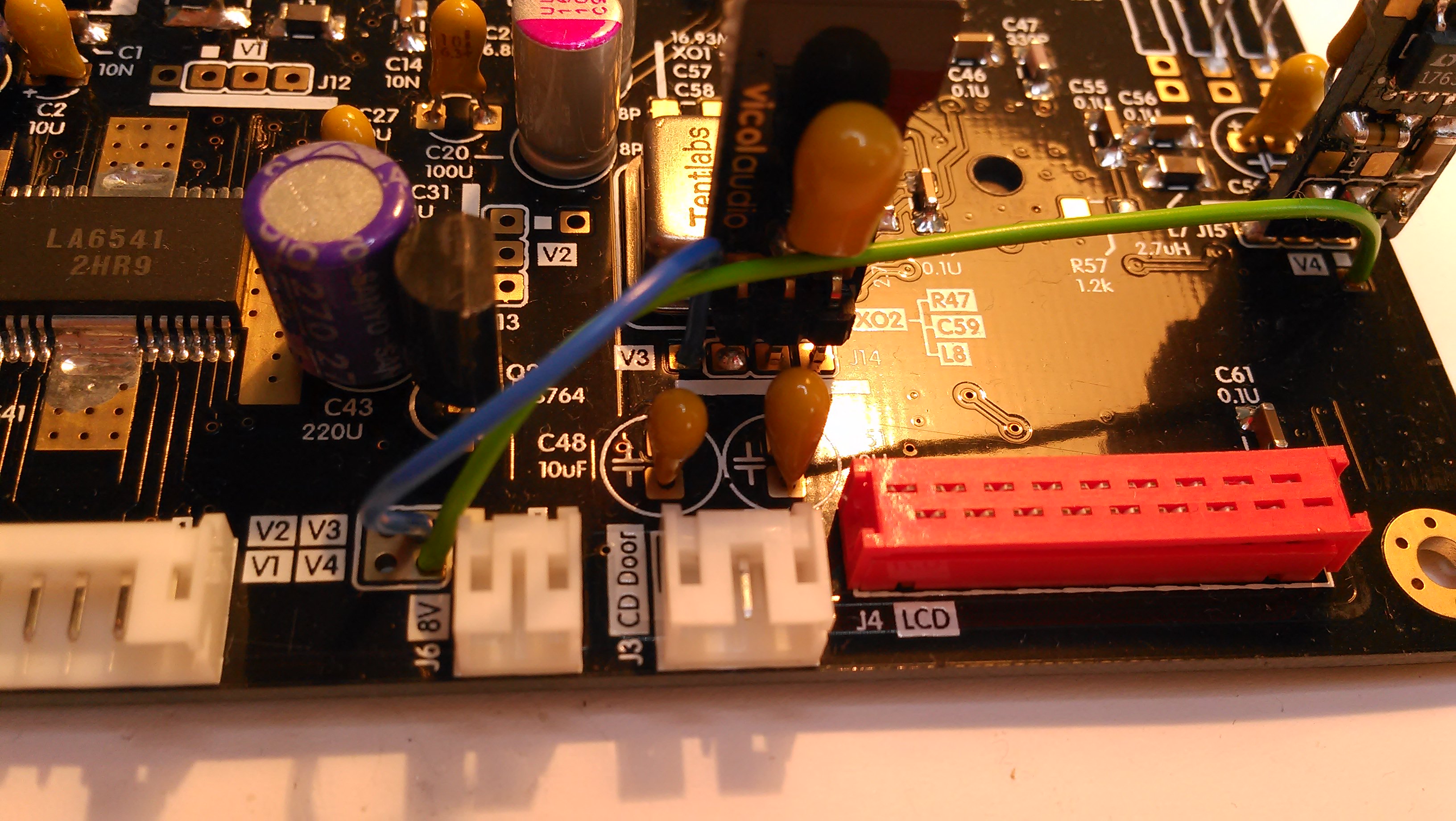

In order to power miniregs you need to make a strap from 8V common point to each regulator. Miniregs will be in series after main 8V regulator from power supply board. Don't forget that L5 and L9 must be removed.
Why a wire and not another elegant solution ?
Because I wanted to leave board open to another regulators as well.
Miniregs are LDO and can be cascaded after main PS.
Other super-regulators: tentlabs, alr, burson, belleson etc are not LDO and you need to power them from a separate higher PS.
GND from any other external power supply must be connected at J6.
Tibi

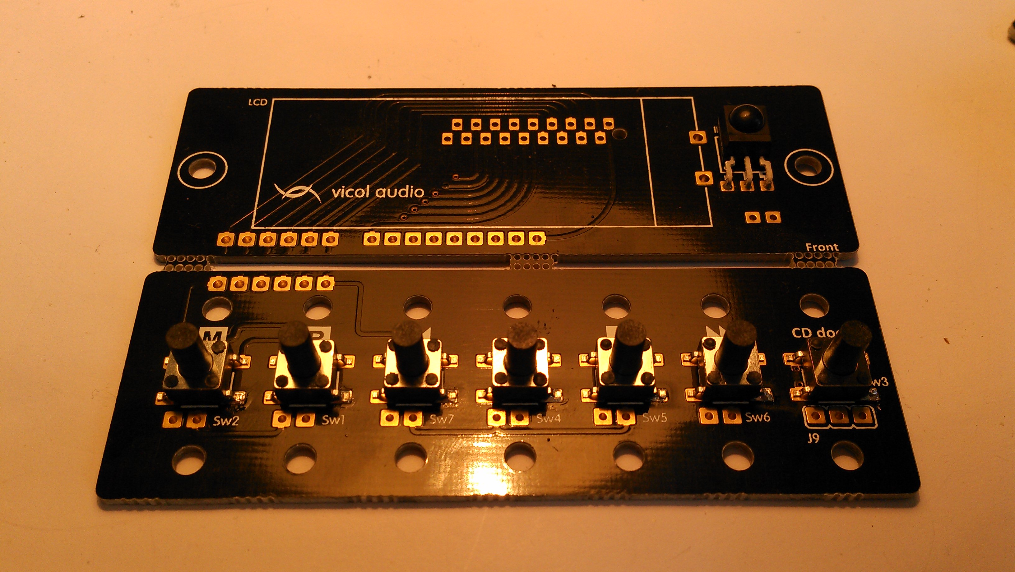

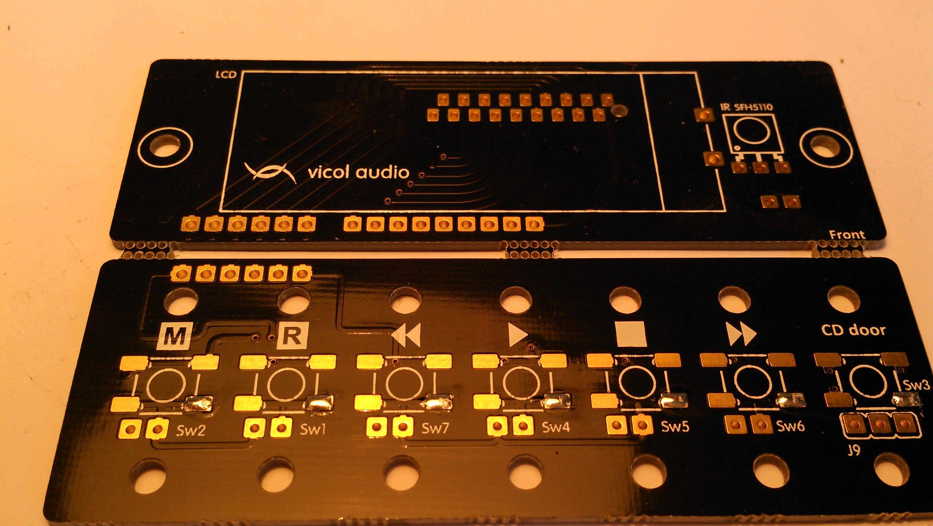

This is how to build control and display board.

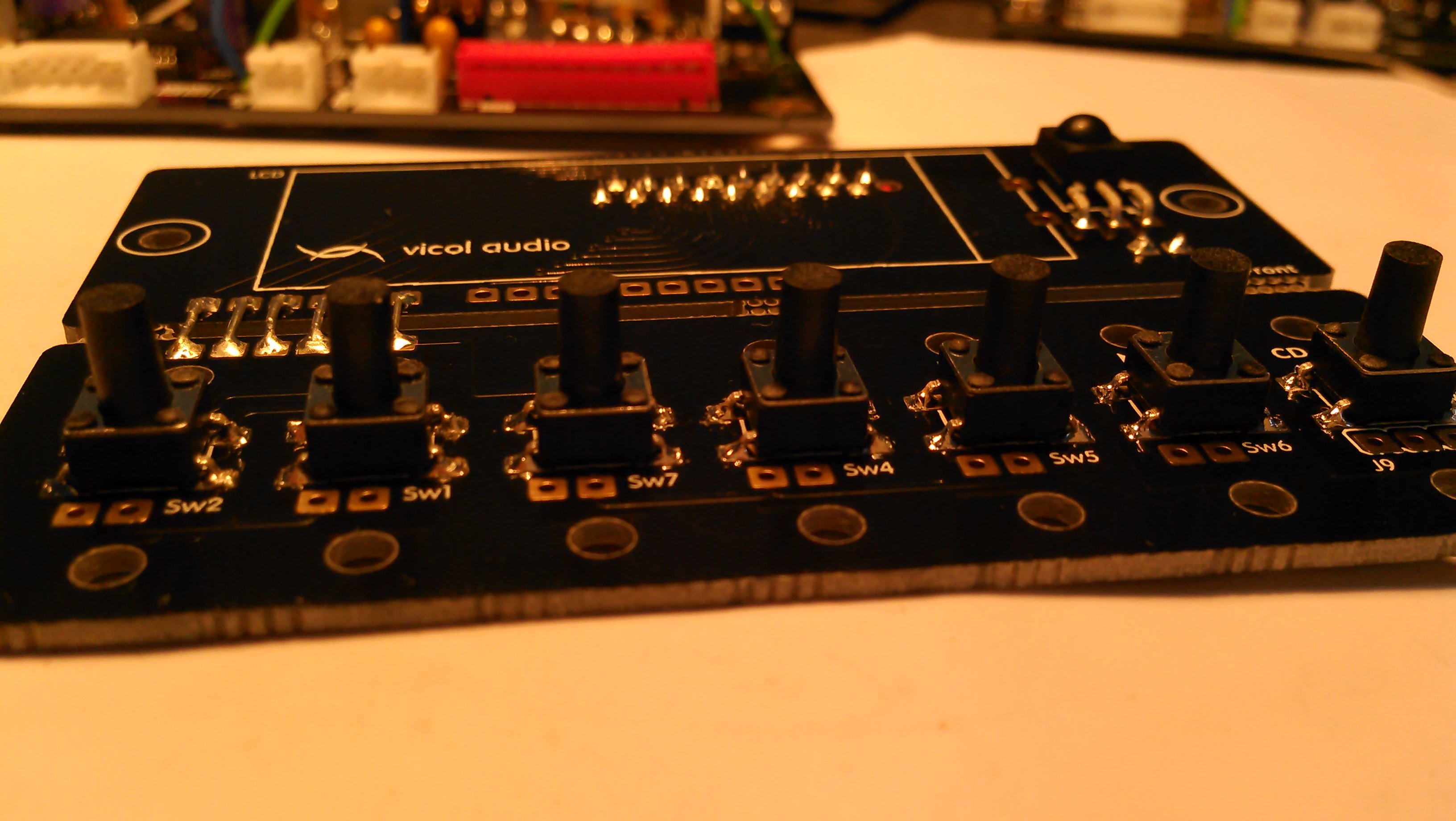

You can start soldering all smd parts and leave at the end push-button switches.
I started with switches. Same technique, solder one pad and align all switches.
Tibi

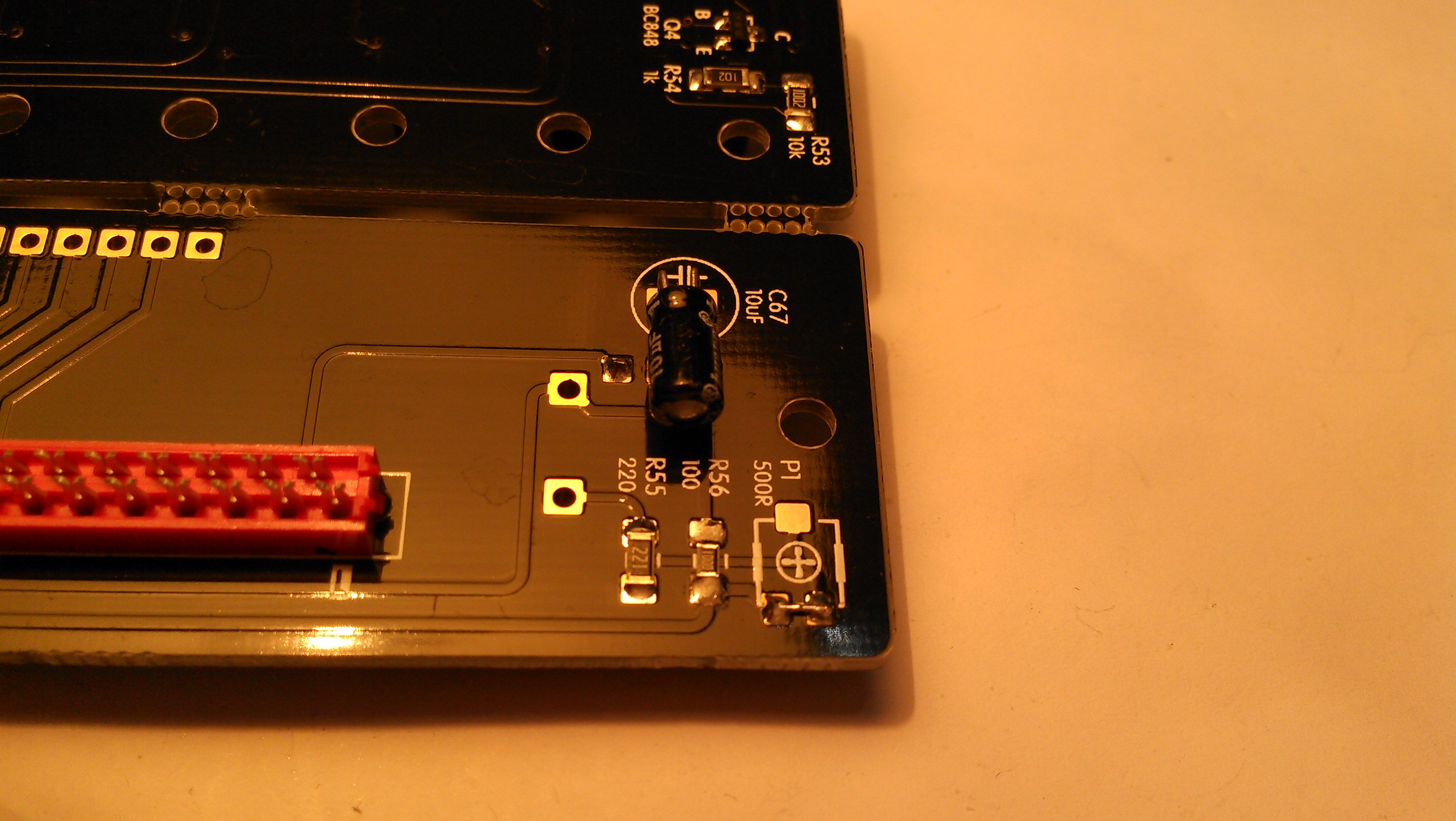

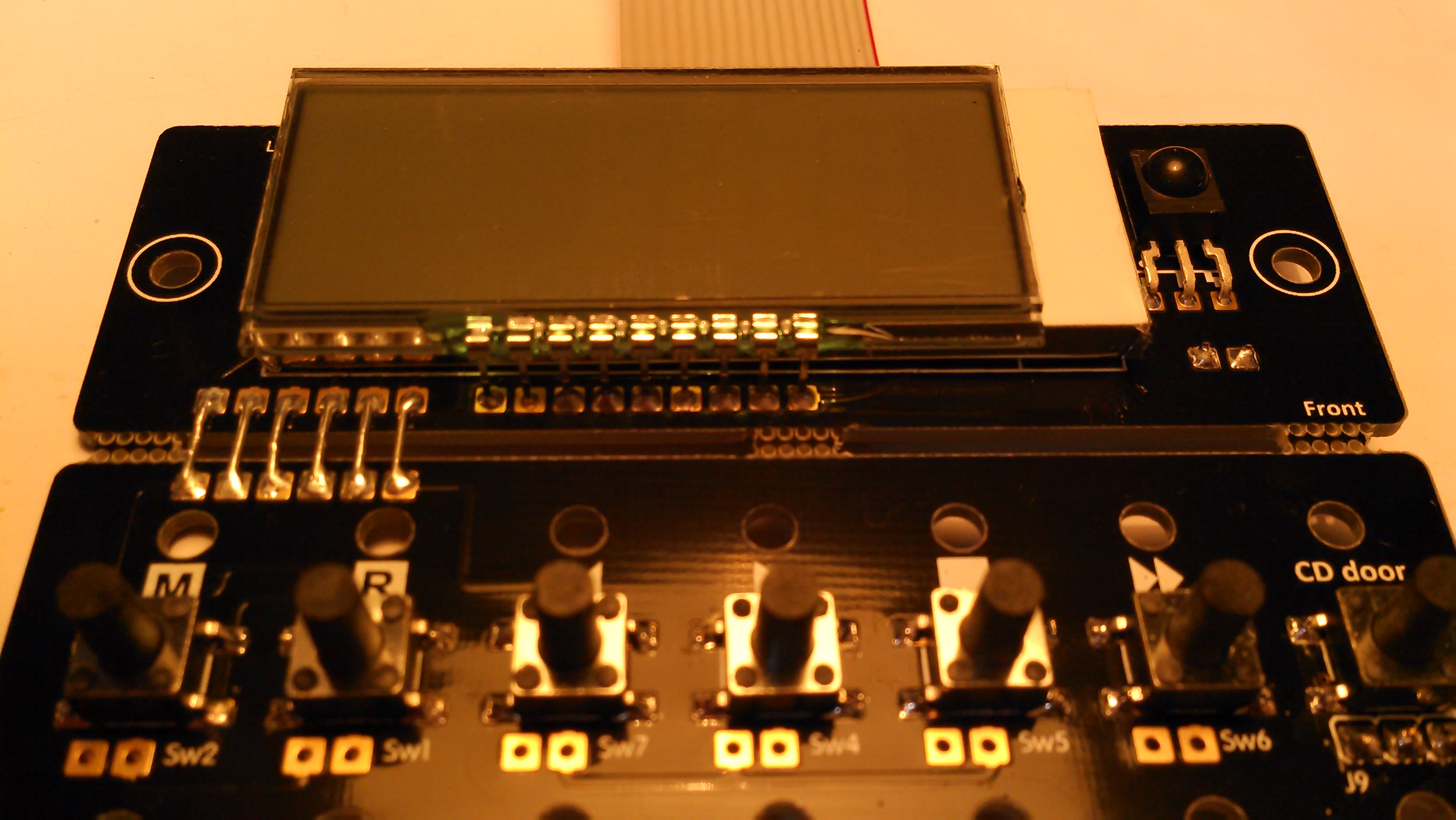

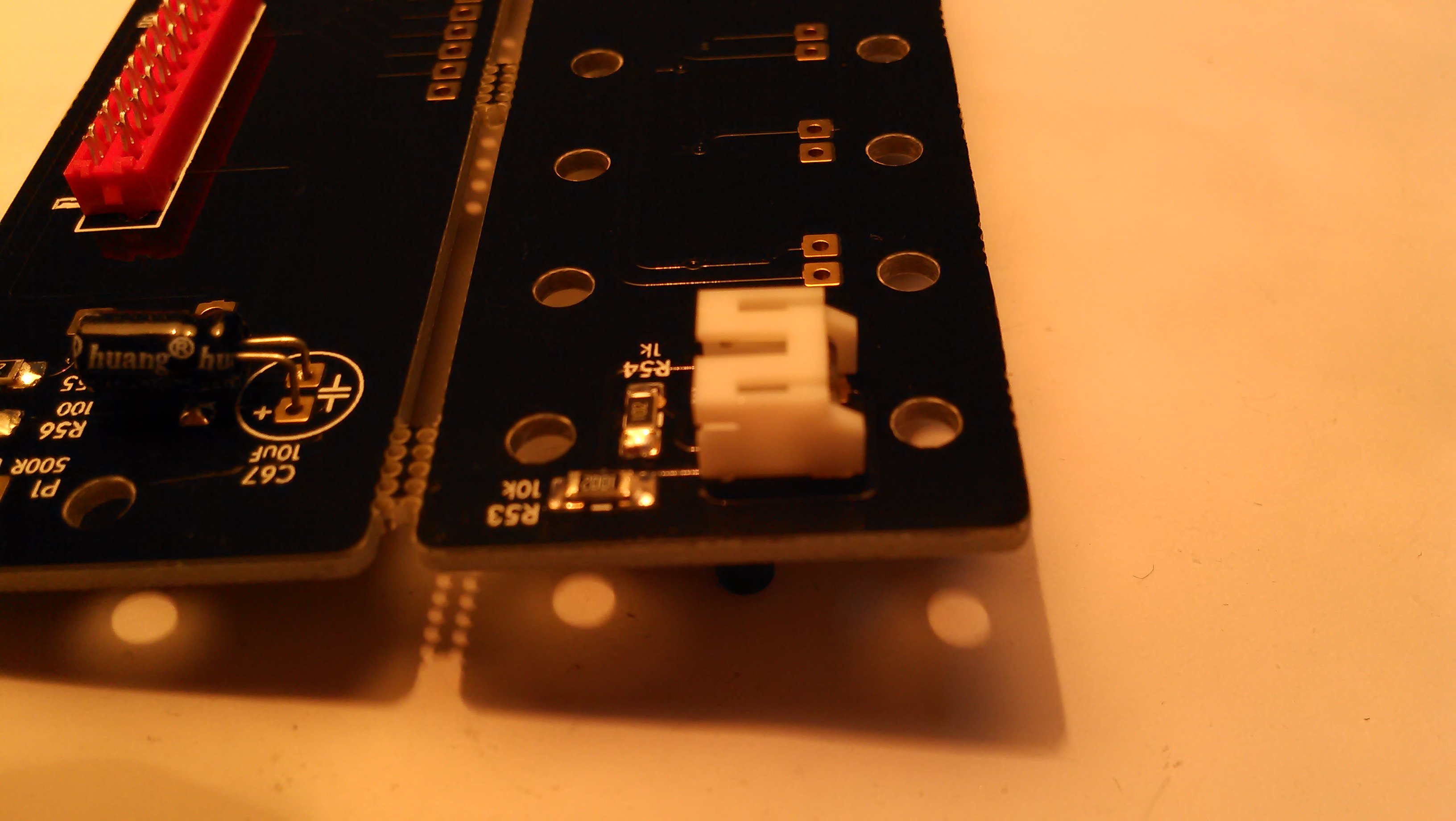

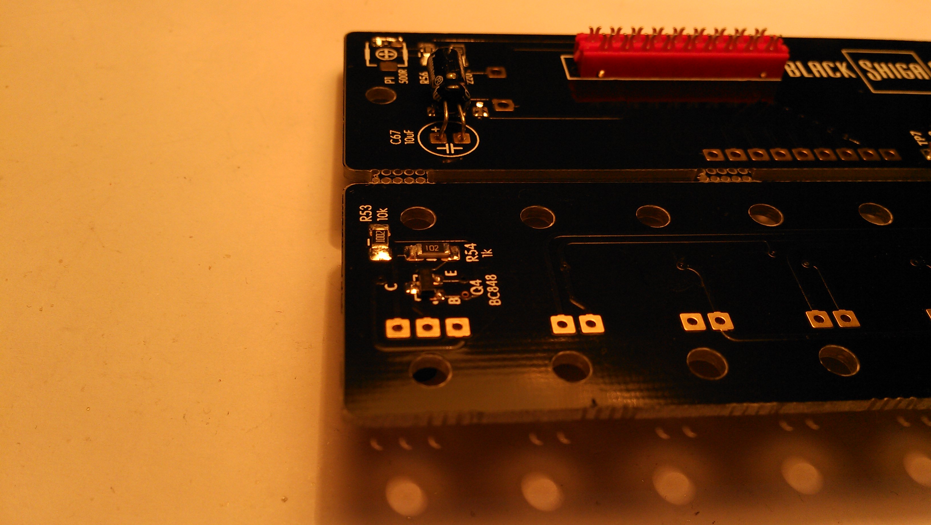

Solder other parts except LCD display and back-light. You need to solder these only after flat cable is connected.
Nothing fancy for C67. This cap is decoupling for infrared sensor.
P1-500ohm is optional. Mount one if you like to adjust back-light intensity.
Mounting J9 as in below picture (over Q4) will leave access open to mounting hole.
Tibi

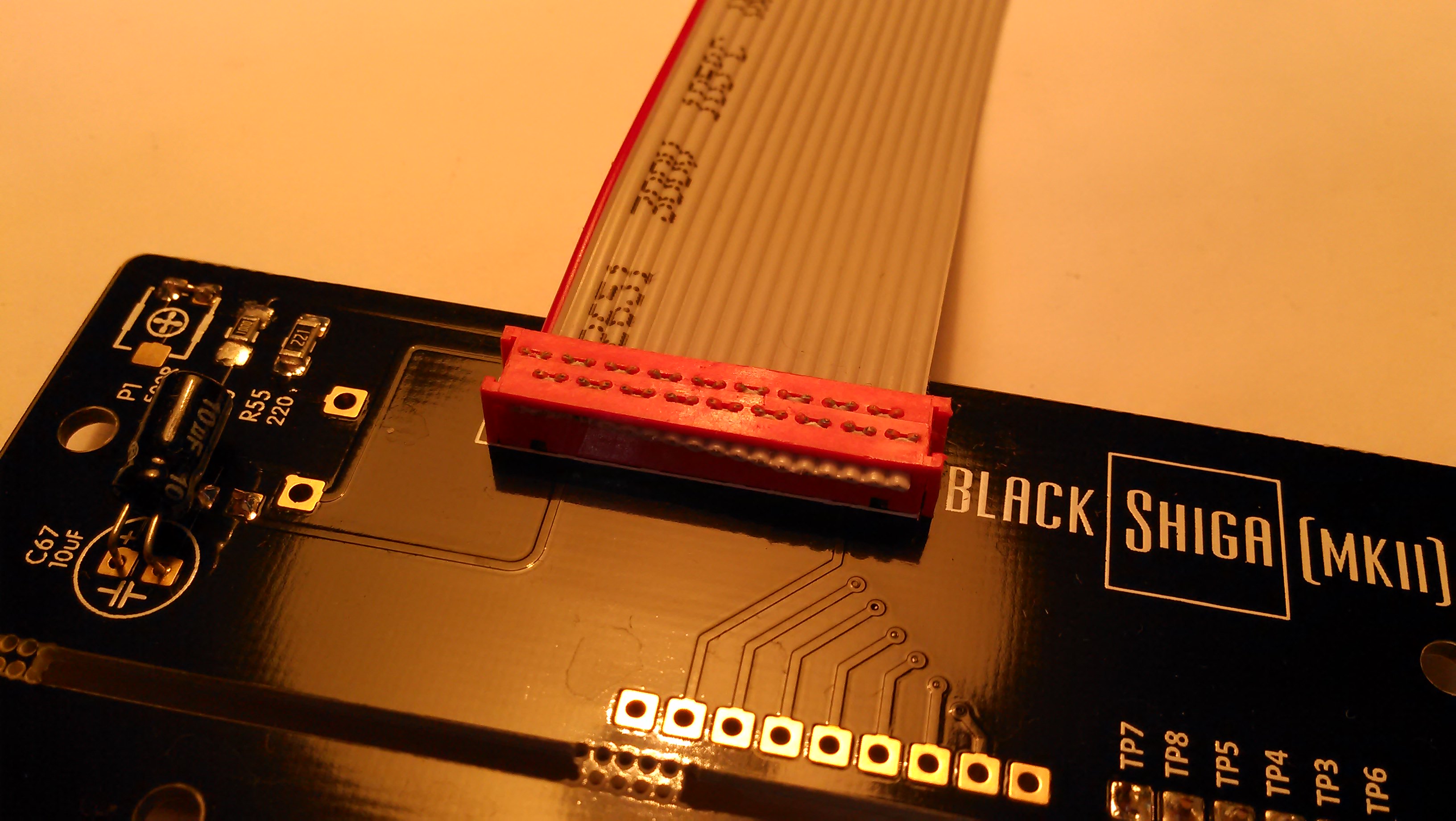

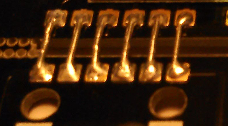

In case you want to use control board connected to display board solder small wires between boards.
Connect flat cable on main and display board. Best way to do this is to use two flat small pinewood pieces. Place one under connector and another over top cover connector. Press this till you hear connector clicking. You may use a big pliers like in picture.
Tibi

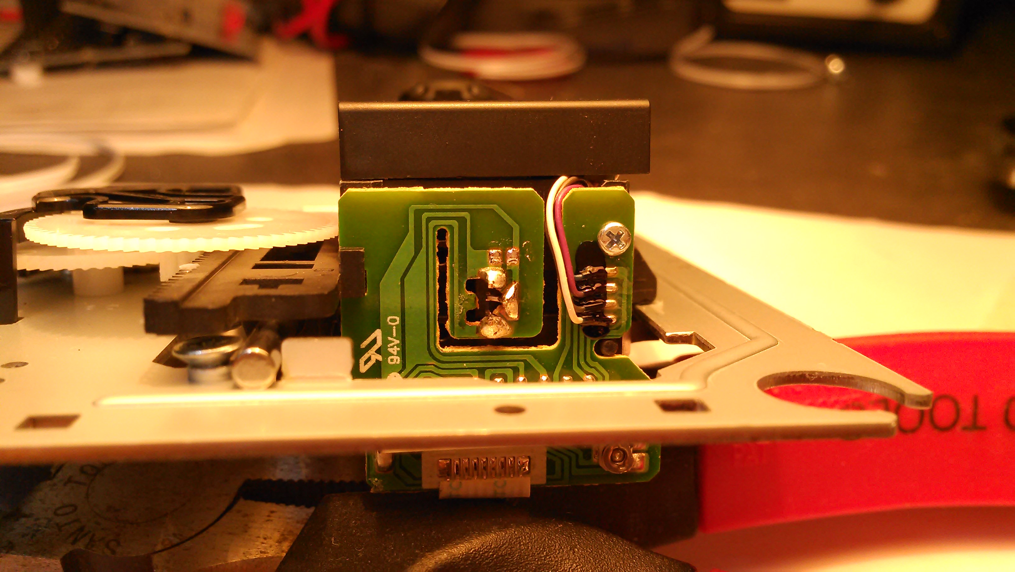

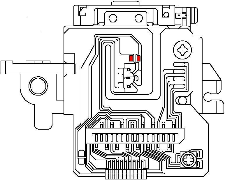

improving SFP101N
Following modification address and improve laser operation of SFP101N-16P Sanyo cd mechanic.
Undoubtedly SFP101N-16P is a very good CD mechanic, but this can be improved further with a simple trick.
Modification is simple but require attention and a steady hand.
We are going to replace a ceramic X5R 100nF which decouple laser diode. This is the worst MLCC type with a huge piezoelectric effect and capacity variation with voltage and temperature is also very high.
As this position is in a very sensitive area, where vibrations and shocks are quite important, I expected some improvement.
Result is astonishing, above all my expectations.
This is a highly recommended modification.
In below pictures I have marked with red capacitor position on schematic and board.
Tibi

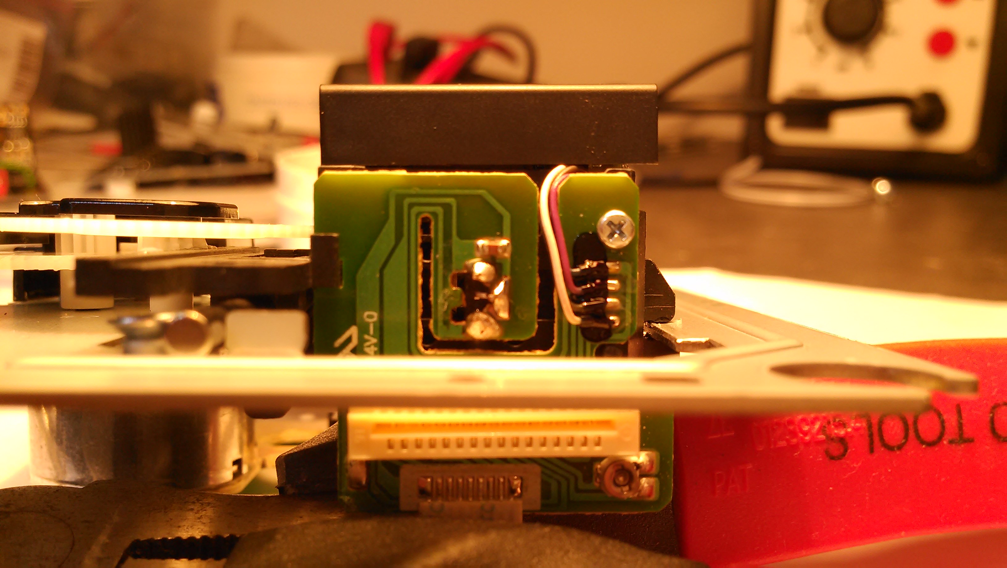

Here is the little bastard who kill our path to nirvana. 😀
The pcb is very thin and sensitive, try to remove him as quick is possible without overheating the board.
Tibi

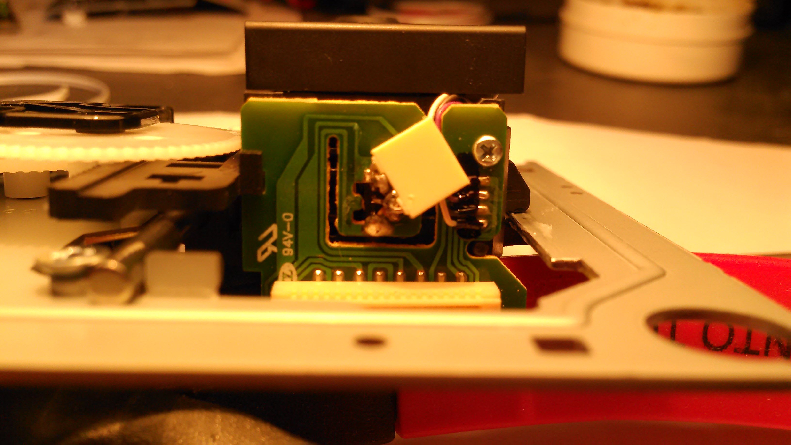

As I said the cap is 100nF X5R.
Almost any capacitor will be better, but must be small enough do not affect mechanic operation. Also big caps with long leads are out discussion here. The cap must be as close as possible to laser.
My choice is Arcotronics MKT. It is good, cheap, have exceptionally low ESR, and small enough to be soldered directly on laser pins.
Another candidate could be VISHAY-RODERSTEIN MKP-1837.
Here is the cap in his new job.
Tibi
Now about the sound. 🙂
I expected some improvement at least in tracking and reading, but the result is astonishing.
This is a completely new dimension ...
The bass ... Wow, the bass get a lot of weight and each instrument have more body. Voices are here, full of deepness and every detail is full of harmonics, much better defined.
I consider this modification the most important and the most effective so far. Give it a try and let me know your results.
Tibi
