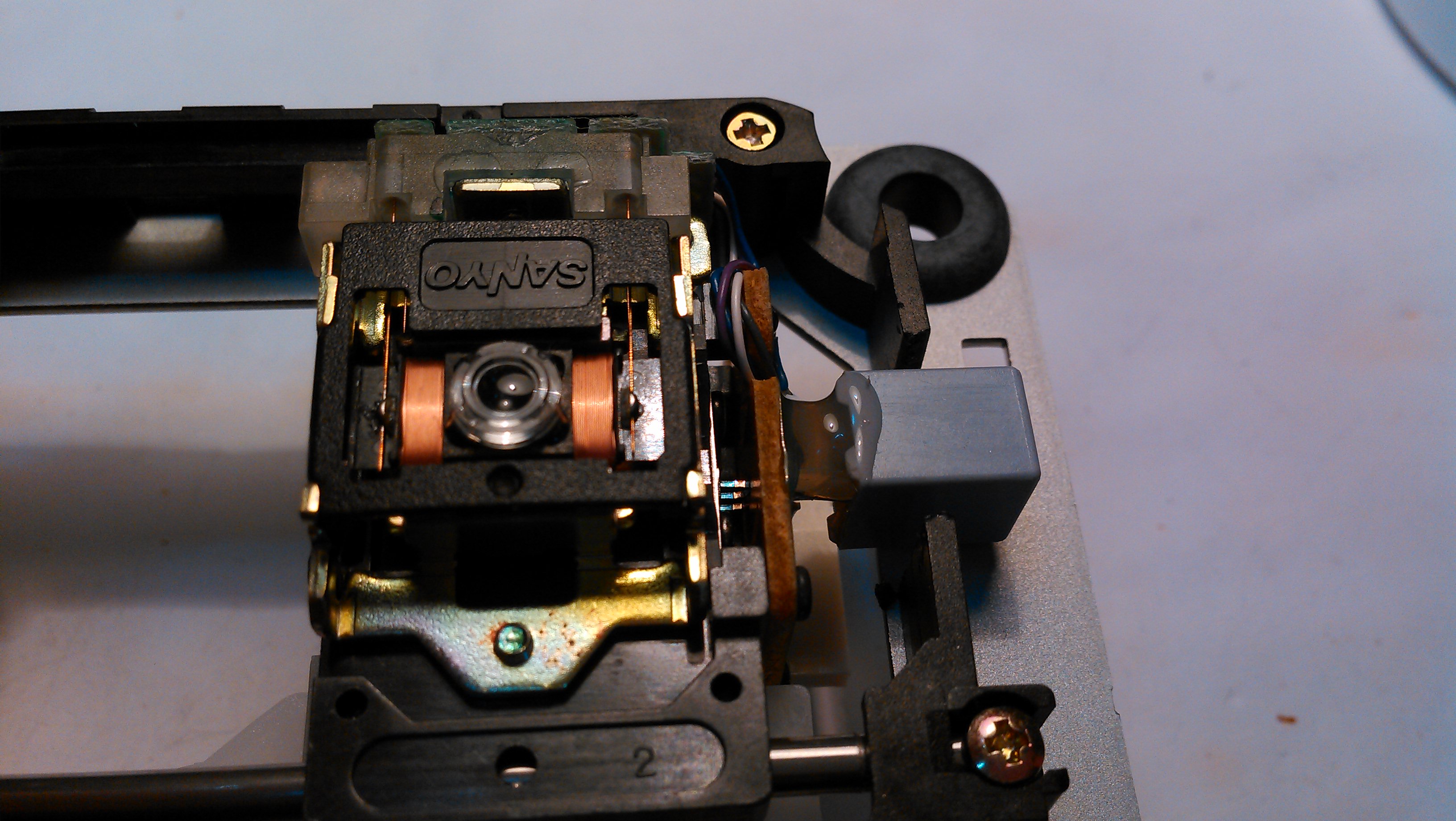

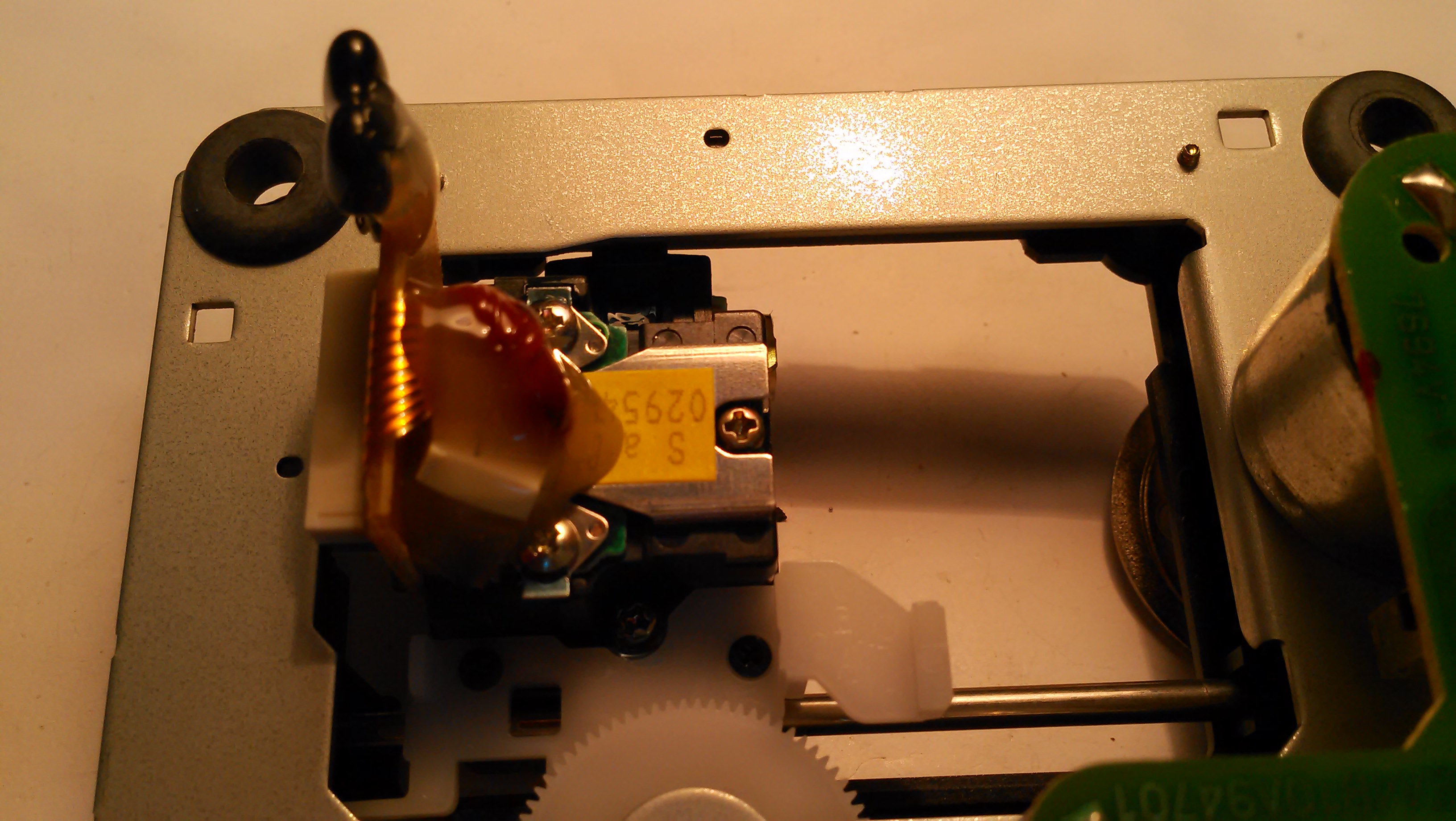

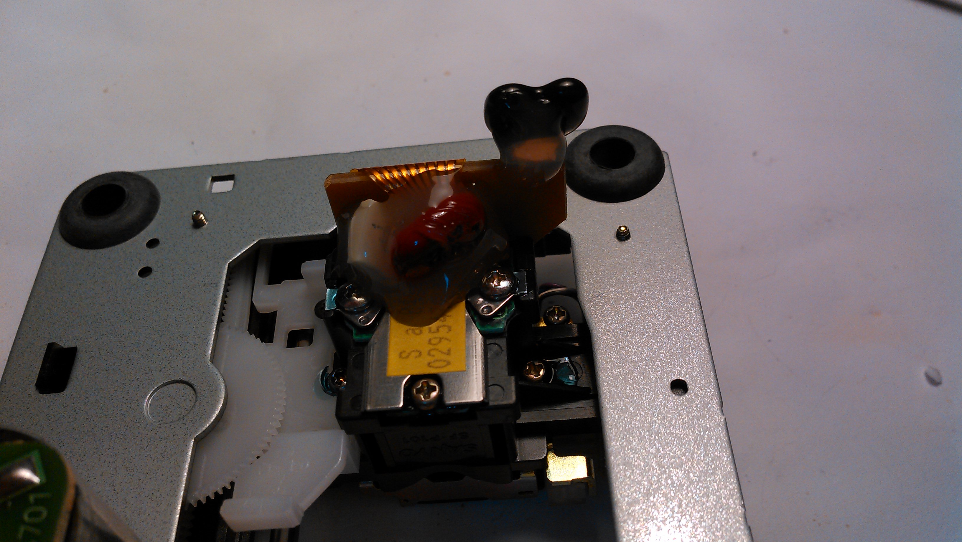

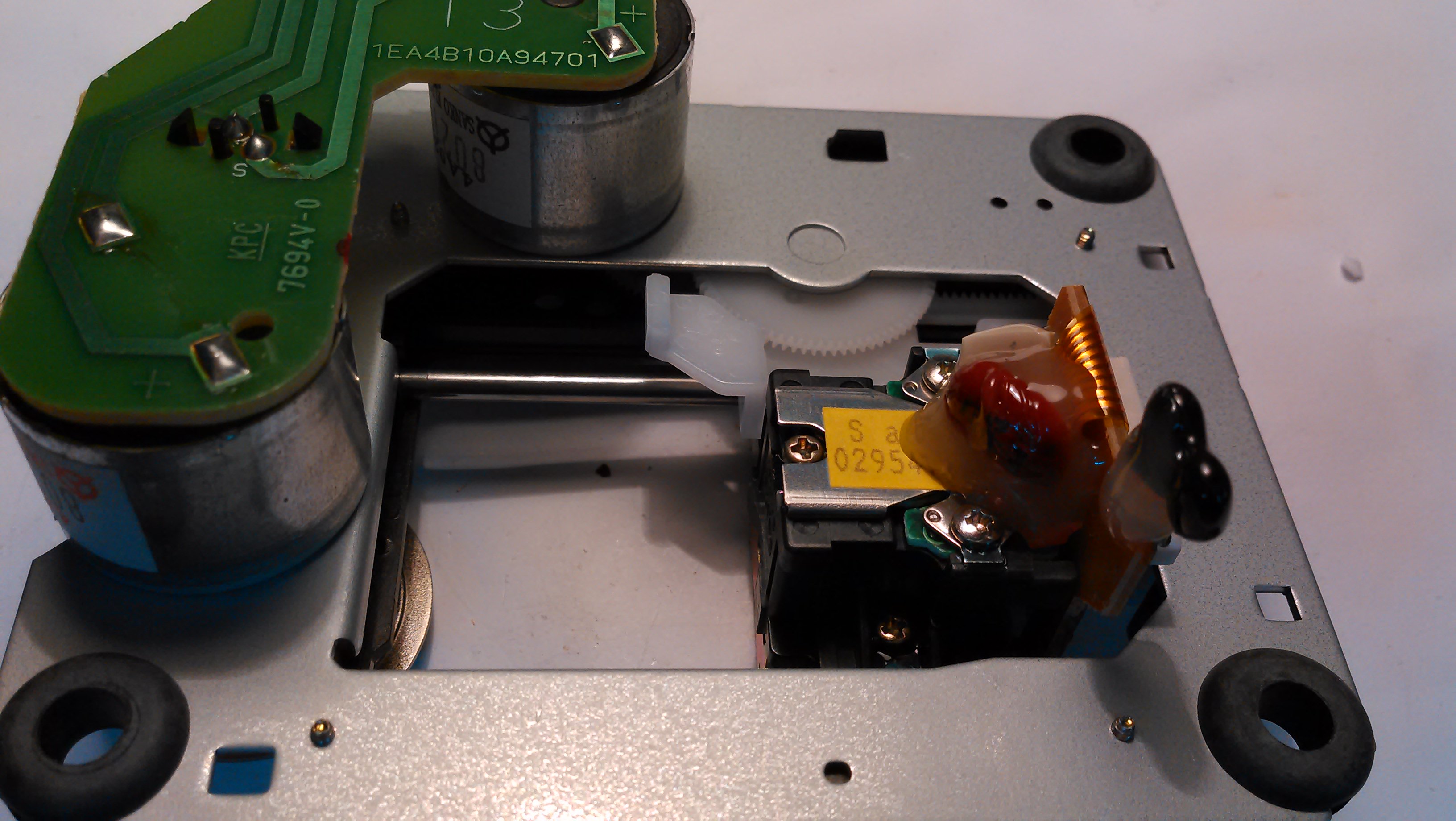

Have ordered few old Sanyo CD SFP101N-16P from ebay.
Interesting is that I got two different versions. One can be used with no modification in Shiga MKII, while the second need a small rewiring in order to get working. The easiest way to adapt the cable from J2 to CD mechanic.
To be clear on the older sanyo mech on the left, make the correction at the ribbon cable not on the mech or board itself? Do you redo connector and wires crossover each other to proper position? Thanks! Also did you do your usual mod on the gold ribbon cable?
Steve
... Do you redo connector and wires crossover each other to proper position? Thanks! Also did you do your usual mod on the gold ribbon cable?
Steve
I redo only wires crossover. The laser and pin mod is made on gold ribbon cable.
Tibi

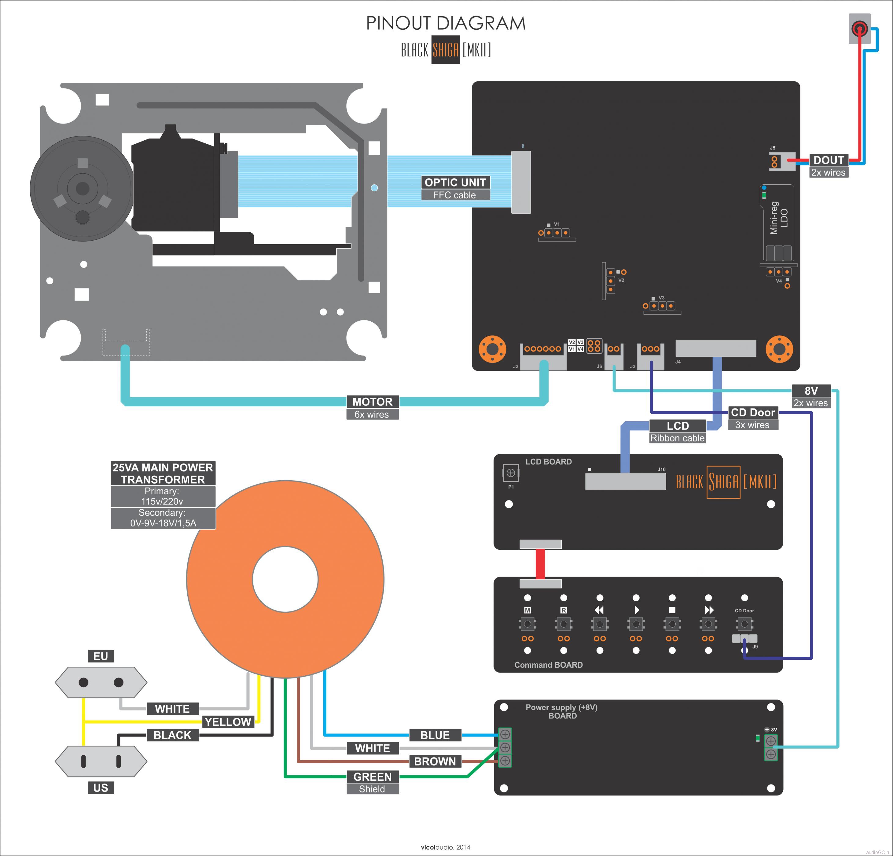

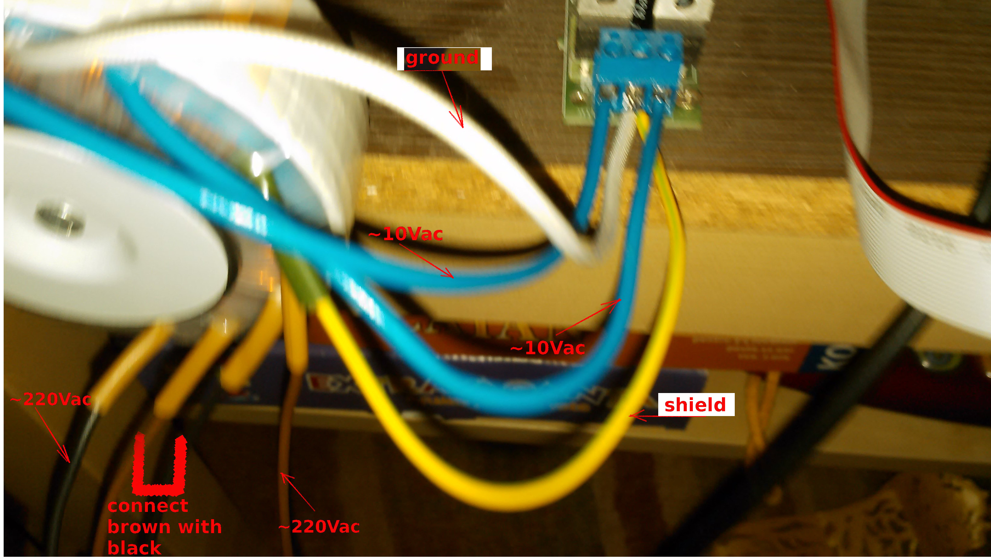

Does anybody have the wiring diagram of the transformer? Vicol Audio site is down right now
Tried to hook mine up and it got really hot. Colors on primary are black / white / yellow,
marking says Pri:0,115V,230V/50Hz - yellow/blaack/white.
Regards
