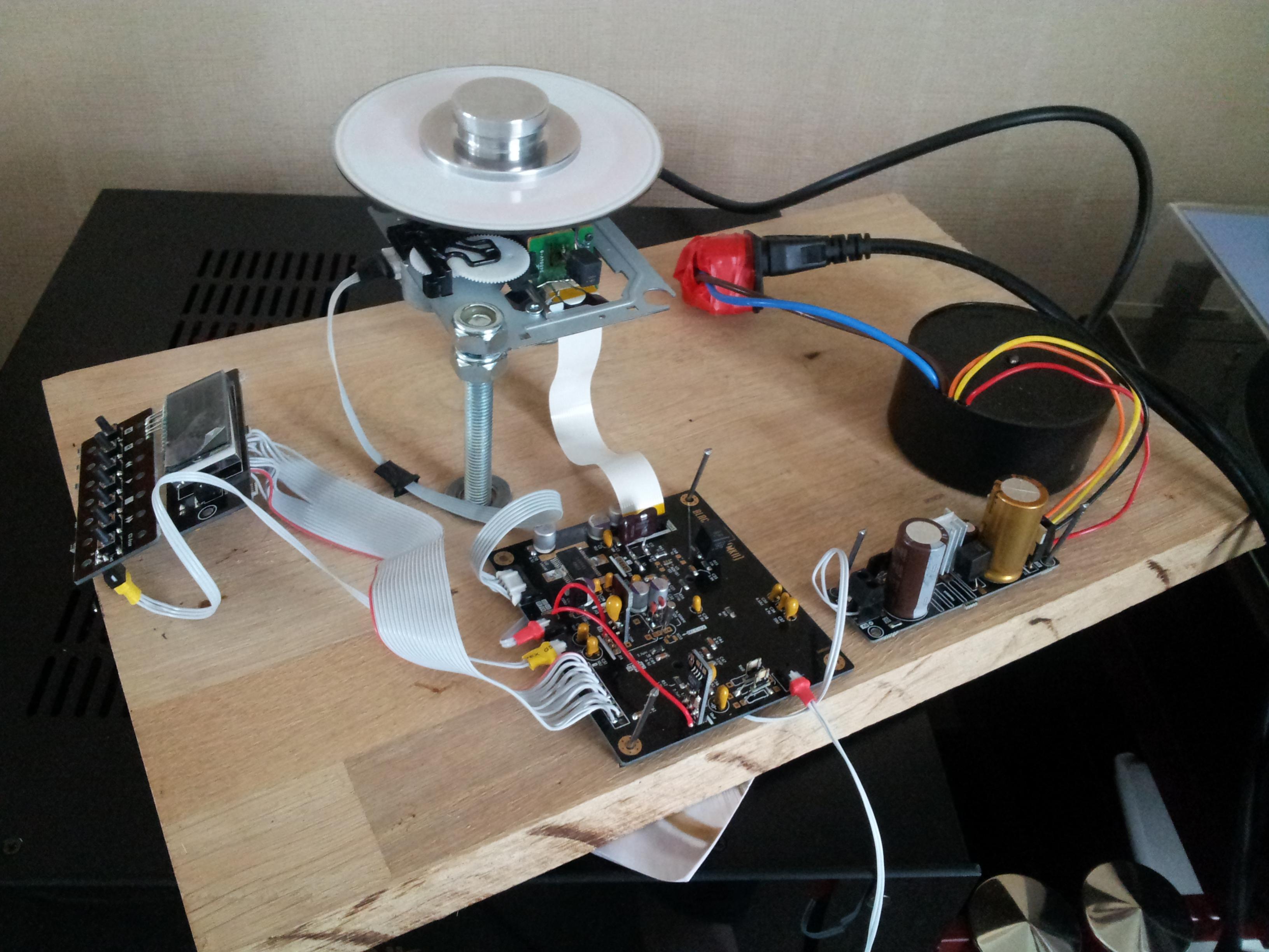

Another happy oh wow transport complete. Just need to make a box to match the sound quality I'm currently hearing. It's the best I've ever heard from CD.
Many thanks to Tibi and all the other project builders for making this a smooth build. Fault finding was much easier having read the forum for this build.

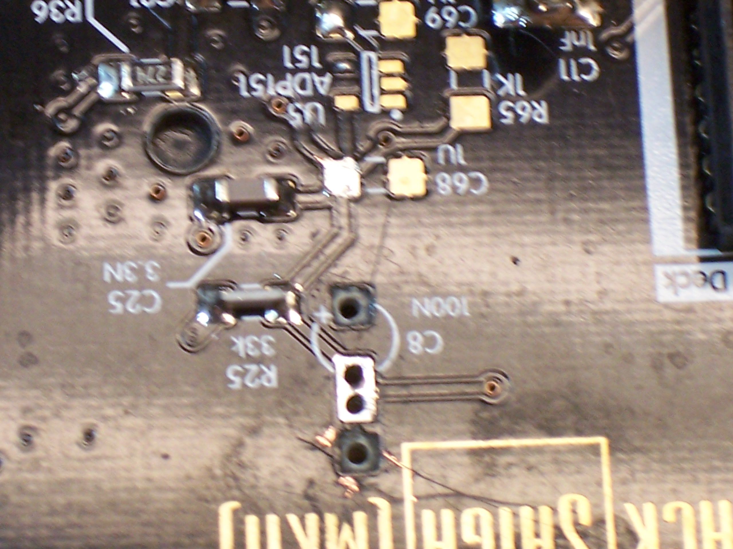

Yes, I removed the solder blob from both mechanics, The motor cable is making contact on both ends. I will try to post some photo's of the pads I butchered. There is no cap in C8 position. But when I last tested I had the EVO cap in place, making contact with the trace to pin ten on LA9242, and soldered in to pad on other end.

Couldn't edit my last post. So as you can see, pads on both sides of brd. are lifted on the end of C8 that goes to pin 10 on LA9242, however the trace to pin 10 is still accessible. On the other end of C8, of the 3 pads, one is lifted on the top side. What a mess I've made!😕

You need to put C8 back. It will not read TOC without C8.
Connect the cap with one pin to trace to pin 10 and the other one to one end of C9.

Yes, I know. I had the EVO cap in as described, when I tested. I took it back out to photograph what I had done to the pads on the brd. So I went to reinstall the EVO cap, but one of the fine leads broke off at the body of the cap. So, I have the .1uf Copper V-Cap installed. One end to the trace going to pin 10. The other end soldered to it's pad, which makes contact with C9, and all the rest that it is supposed to make contact with. Now when I power up I only get two flashing dash's. No zero's, No CD, or Laser movement? Same if you press CD Door, Nothing but flashing dash's. I checked that the trace to pin 10 on LA9242 isn't shorting to any other pins on the LA9242, and that the other end of C8 was connected to all it's other parts. Help!!😕
Well, I found a broken wire on the motor cable. Fixed it. Now it does what it did before when I had the EVO cap in. Power up without a disk on, and motor turns in little spurts about 3 or 4 times while the laser tries to focus in and out, but the sled is not moving. Put a disk on and hit CD Door, and the CD spins while the laser tries to focus as the sled moves back and forth trying to read TOC, but then comes up with two zero's on the display.😕
