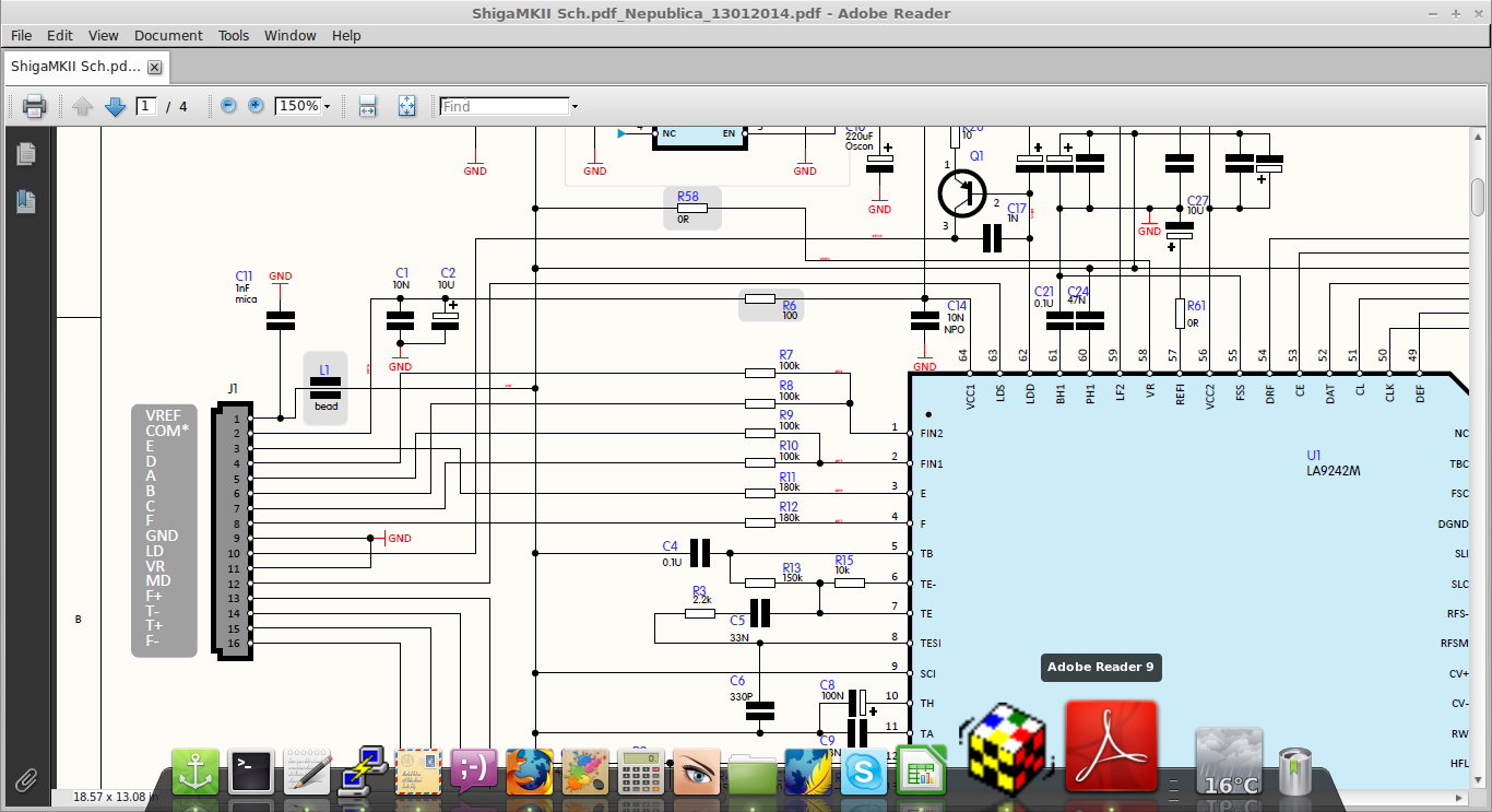

Measured the J1 connector. Is from the text J1 CD Deck no6 and no8 supposed to be shorted?
You see, a schematic would be useful to have...

No short between J1 pin 6 and 8.
Tibi
  • Screenshot from 2014-06-20 09:30:24.png
Tibi
No, but between 9 and 11. So if one counts wrongly as I did with pin1 furthest away from the IC one could believe it was 6 and 8.
I compared the laser on new and old shiga and they seem to be equal in strenght. So the laser seems to work - at least the ld part. I assume that the pickup circuits are the same on old and new shigas? Is the attachment about the new one?

Yep, attachment is the MKII.
