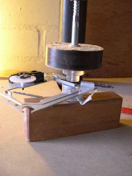

I reveived the puck today and in order to make use of it without stress on the spindle I will have to make adjustments on the platform.
I first tried the puck on five other platforms to make sure that there are no platform deviations causing the problem...there are not. :(
So at the moment I am thinking of widening the plastic gap of the platform just a little or shaving the aluminim a little...since unfortunately the puck is not useable at the moment.
Yes kind of like your delrin thingy, but with a simpler design
The best thing when using ebony is make a really tight fit and take care that it is open on the top (compressed air !)
I think you shoud build yourself a tool to press the platform home in order not to bend the spindle.
I am very curious if you manage to get the job done...succes ;)
Btw I have somewhere a picture of my home built tools and with the help of a drillplatform you have total control over the situation.
