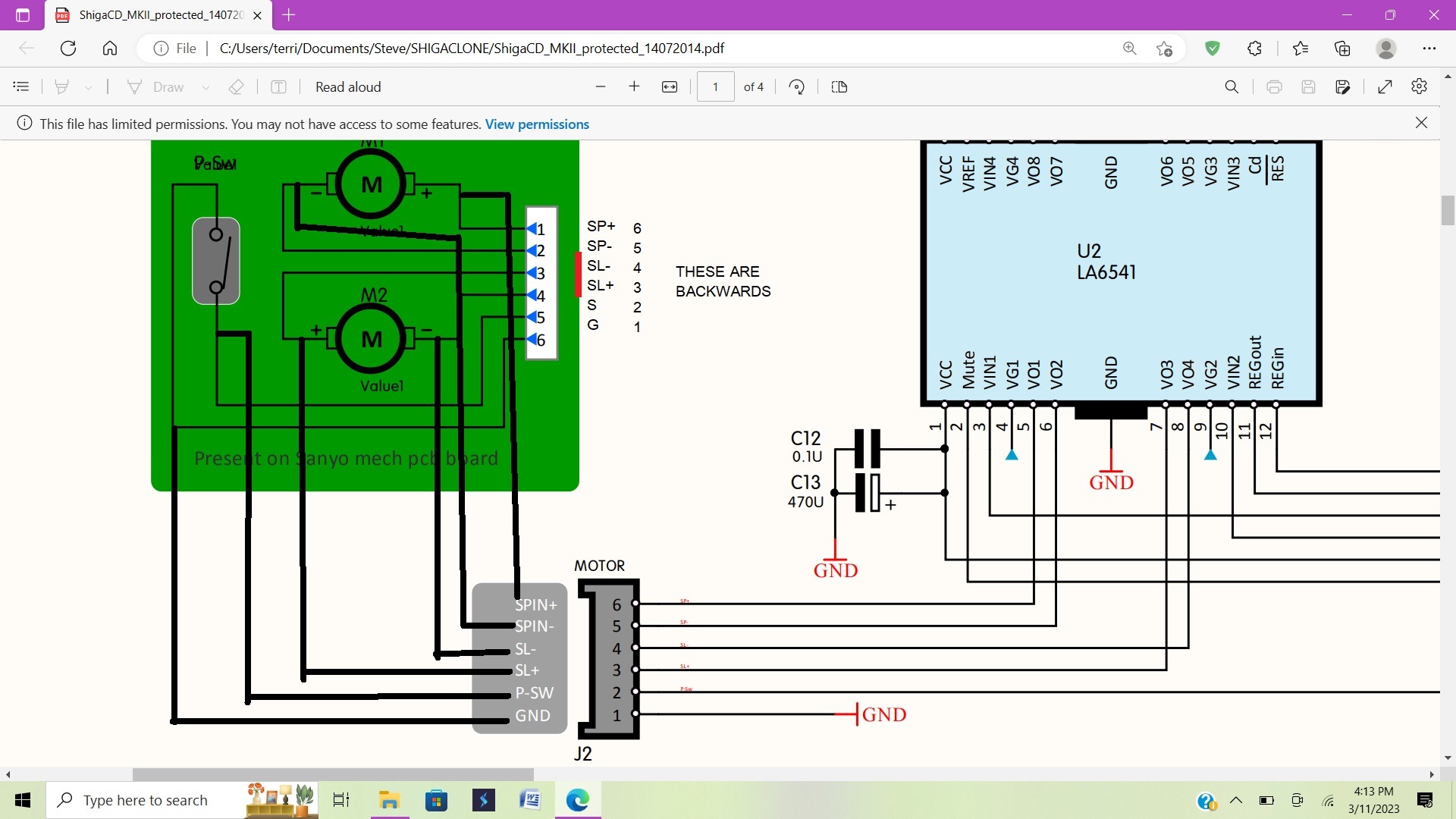

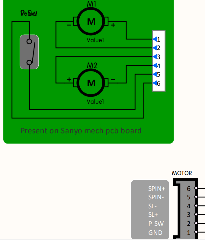

SO I can't figure this out. In image from schematic the pcb for motors starts on left [1] Gnd. Plug shows 1 grnd 2 switch 3 SL+ 4 SL- 5 SP- 6 SP+
Sanyo deck shows 1 GND 2 SW 3 SL+ 4 SL- 5 SP- 6 SP+. It appears sled +/- would be reversed if I just keep the ribbon cable in order!?
I did have mech functioning on breadboard for cd play & cd door, reverse track, NO forward track. Am I missing something or would this reverse +/_ sled.
thanks for any help

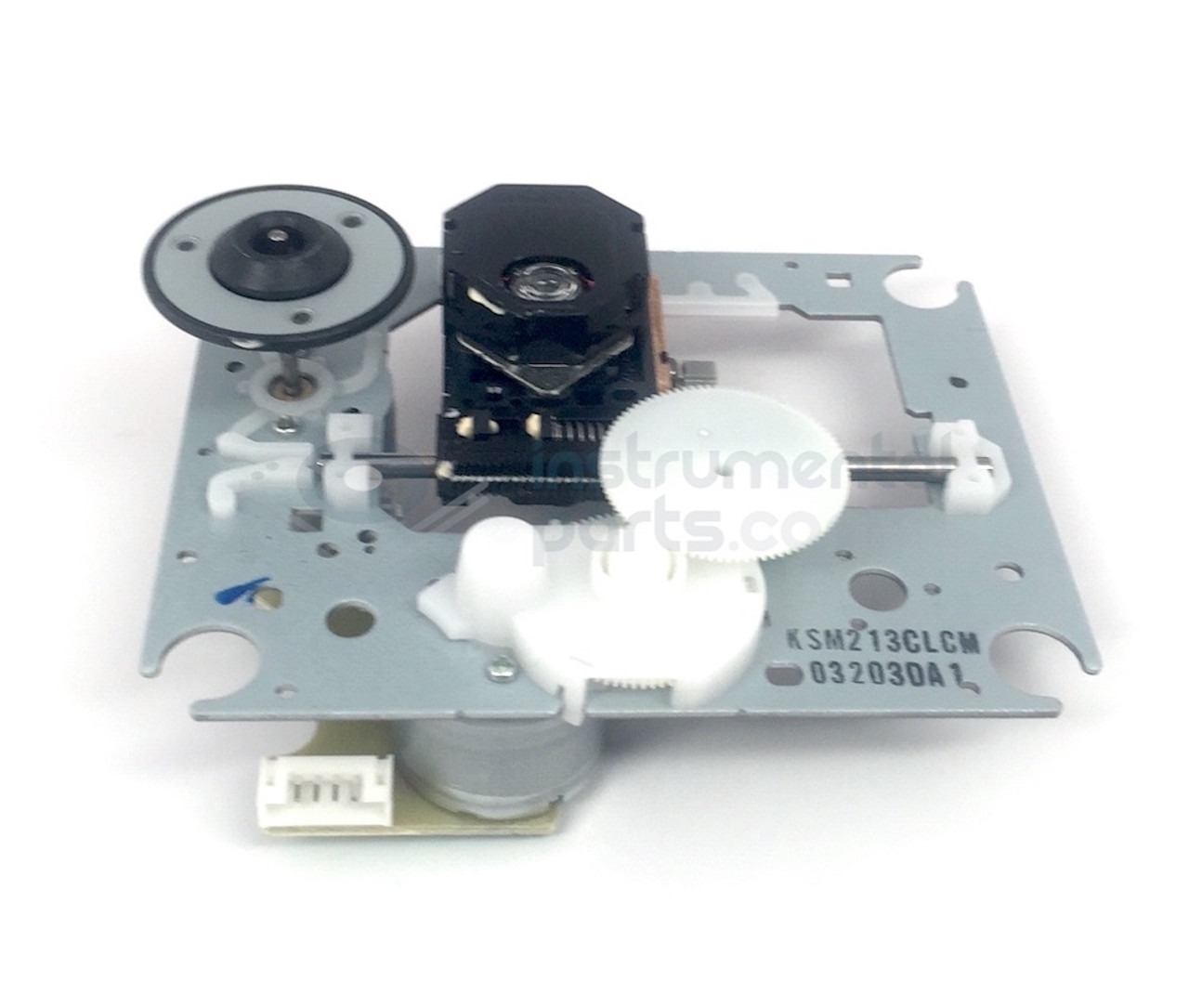

Hello! for those having laser problem can try Sony Laser Head KSS-213C, I am currently using this laser and it read CDR a lot better than the Sanyo laser.
Hello i dont know what is going on witch this lassers. I have bough next 3 lassers. After change shiga works perfect , first one played 1hour, when i power of cd and power on lasser have problem witch read. Seccond one played couple days.. i dont know what is killing them. on shiga pcb i have 4x 5.00v stabs, and 8v. 2.51v reference. Orginal lasser plays 3 months. This time i have new lasser and im not changing smd capacitors on it(when lassers work well i have change 3 smd capacitors for silver mica caps)
I can use just kss 213c laser head? or i must change all mechanics? i can see that slide side is little difrent in kss. And what about lasser optic distance to cd rom? I have measure that in sfp101n it is 19.2mm-20mmHello! for those having laser problem can try Sony Laser Head KSS-213C, I am currently using this laser and it read CDR a lot better than the Sanyo laser.
you have to change whole CD mechanism and modify the CD puck a bit (drill 3 mm hole at the center of the puck for about 4mm deep)
