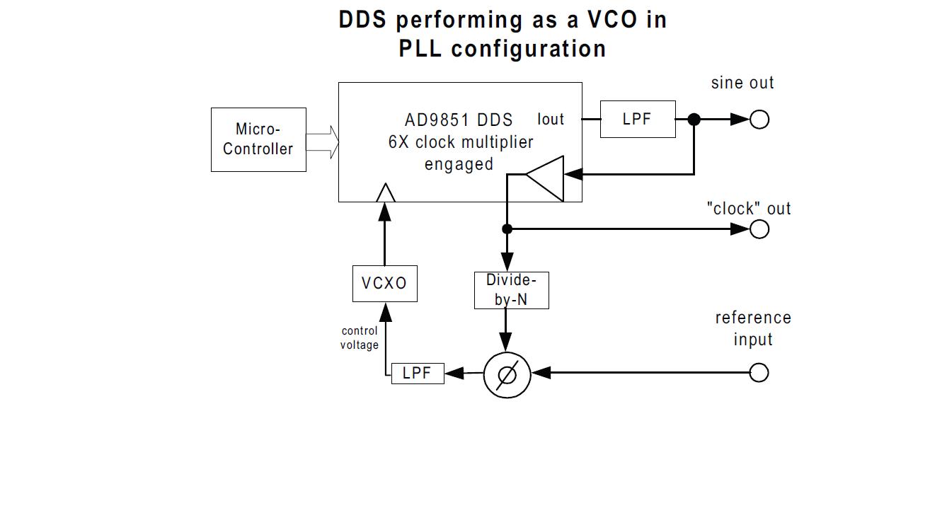

I'm particularly interested in the input frequency multiplication, PLL etc, section right now.
I'm wondering how Shibasoku manged the jitter. The jitter is multiplied by the frequency division of the counter/divider circuit. TI indicated as much as 5.5us in this paper
http://www.google.ca/url?sa=t&rct=j...6pFNOGaz8SBz8ZJhc6rn5MQ&bvm=bv.52434380,d.cGE
AD shows a modern advanced approach in this paper
http://www.google.ca/url?sa=t&rct=j...44DYCw&usg=AFQjCNElRDdDXP5E4cAdwpV1gPCrroVlHQ
This is a lot more expensive though but promises very low jitter.

Hence the need for a low jitter PLL.
