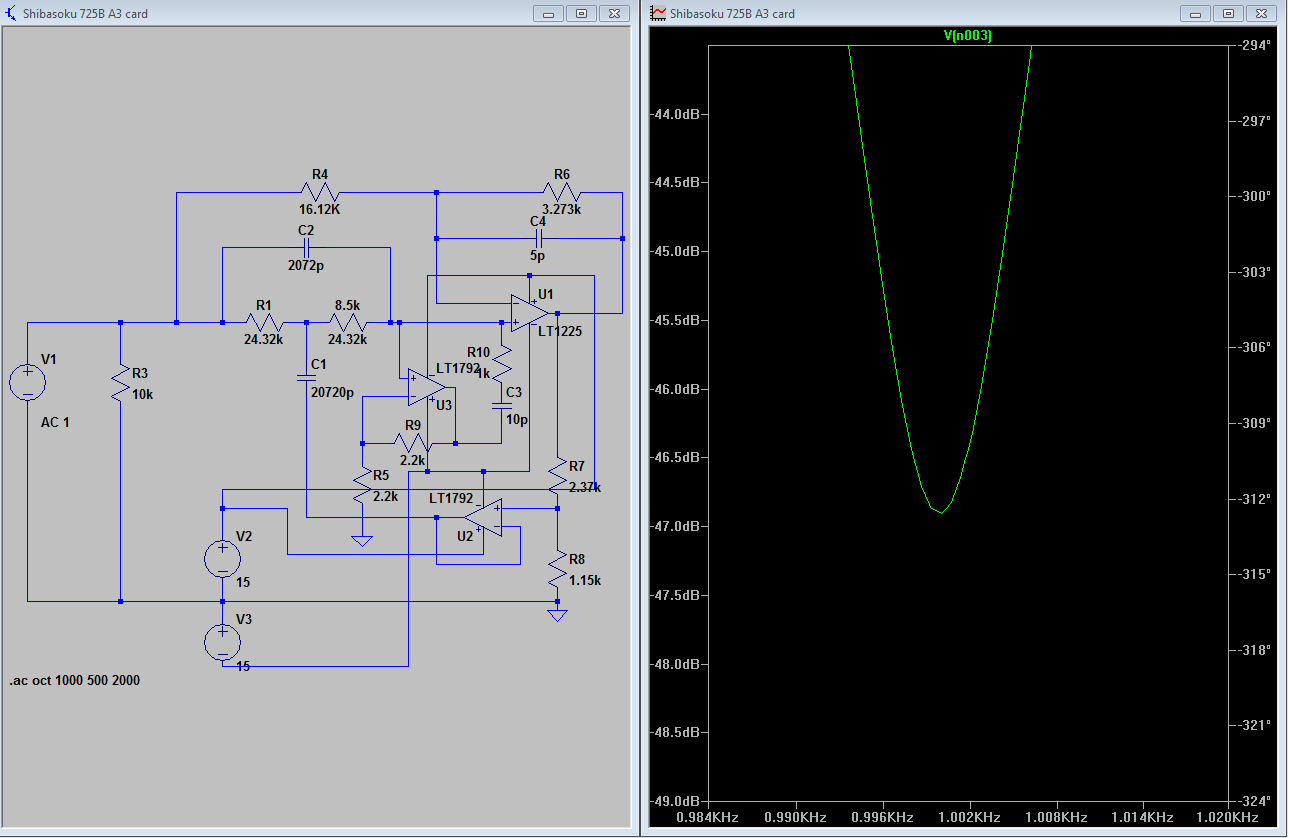

Shibasoku A3 simulation
I tried simulating the A3 notch filter (attached) in LTspice IV but with the values from the manual I only get about a 3 dB notch. I'm clearly missing something. If I change R29 (R6 in the sim) up by a factor of 10 it gets a 40+ dB notch. But all the drawings in the manual and Pchi's drawings indicate that the 3K ohm range is right. What have I missed? I did not include the shield driver since the sim doesn't have relays or stray capacitance. I did include the cap null for the opamp.
If you don't have any stray capacitance take the capacitance neutralizer out. There's nothing to neutralize. HP used this in 339A analyzer to cancel the stray capacitance.
It's odd for a bridged T to have equal caps and equal resistors.
Thanks for the tip. The caps seem to have a ratio of 10:1. I am guessing since its not really specified but that works with values from the board. I revised the simulation. i revised it and tuned it to 1 KHz. it seems to be a really solid 47 dB at 1 KHz as I tweak around the edge with something close to a .2% bandwidth. Pictures and file attached.
