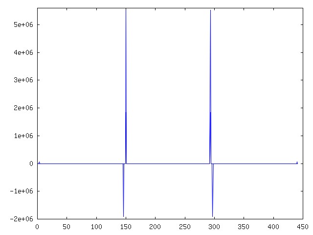

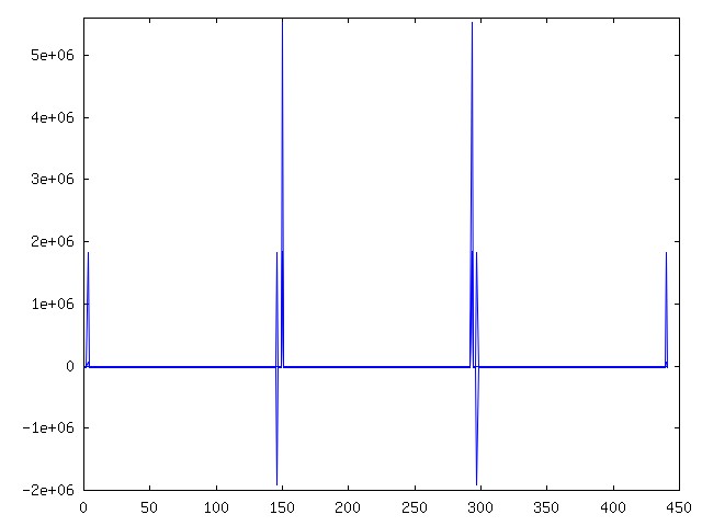

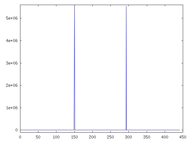

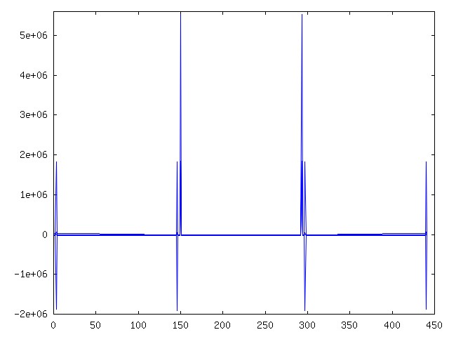

This is the FFT results for fo=15khz nearest fc/3.
This below is a working progress matlab/octave script rename it filename.m
fft_xt is the fft of sine acquisition .
fft_xt1 is the fft of first modulation
fft_xt1+xt2 is the print of fft of first modulation and second modulation on the same graph
fft_xt1+xt2+xt3 is the print of first second and third modulation on the same graph

Your first plot shows the original 15kHz signal, plus the first image at 29.1kHz. Exactly as expected. The second plot shows two signals, and two images, exactly as expected. etc.
Now apply a reconstruction filter, which will remove everything above 22.05kHz. You get the original signals. Why do you find this so difficult to grasp?

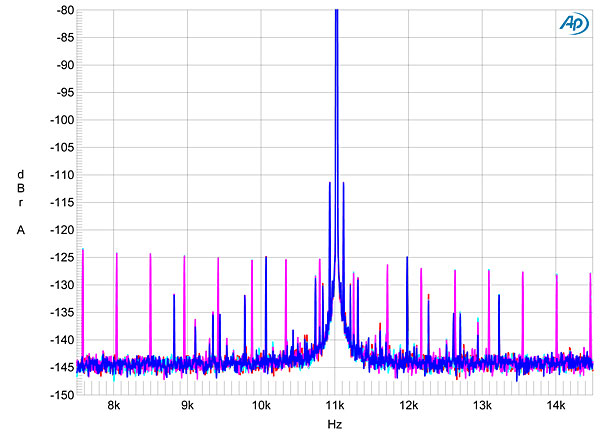

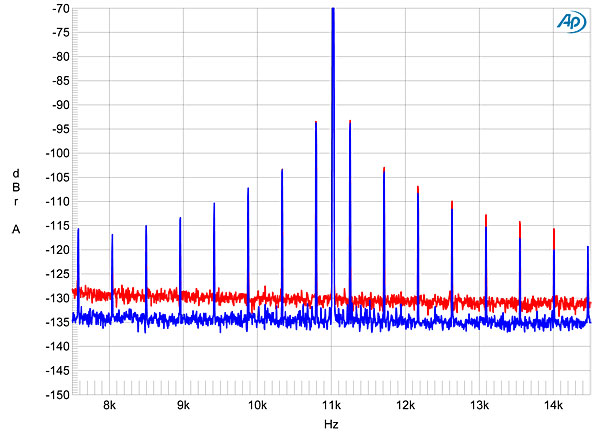

I think if is possible to emulate a real dac is possible
to evalutate was heppen at values nearest fc/4 in
I this place are present 4 modulation and produce noise
bleow
That noise is due to high jitter.
noise

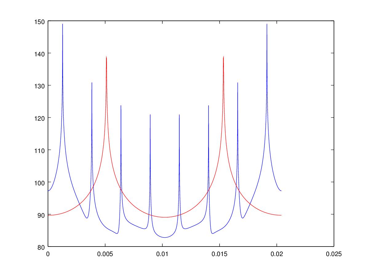

S/N on nos and oversampling is the same about 45dB
But on fft of oversampling there are many sine wave than on nos fft about jitter .
For best interpolation i think the sinc is only one by one for all samples .
Below first is of the nos DAC and second of oversampling DAC.

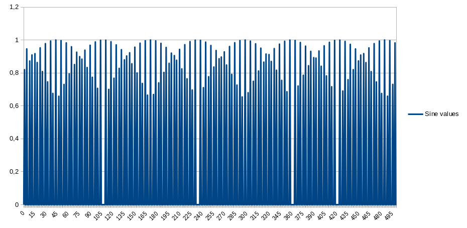

Calculus
For obtain the image you need to generate a sampled
sine by this calculus
fo=12500hz v(kt)=sin(2*3.14*fo*kTc)
k=1,2,3,........,n
Where Tc is a 1/Fc and Fc=44100hz (sample rate freq.)
Set up a level variable between (0;1) for example vf
and create the output values v(kt) filtrated by level
v(kt) if v(kt)>vf or 0 in other case
Print result by Spreadsheet graph, and see results....🙂
I think on NOS dac the noise around 50-100hz is coming out
from this point.🙂
