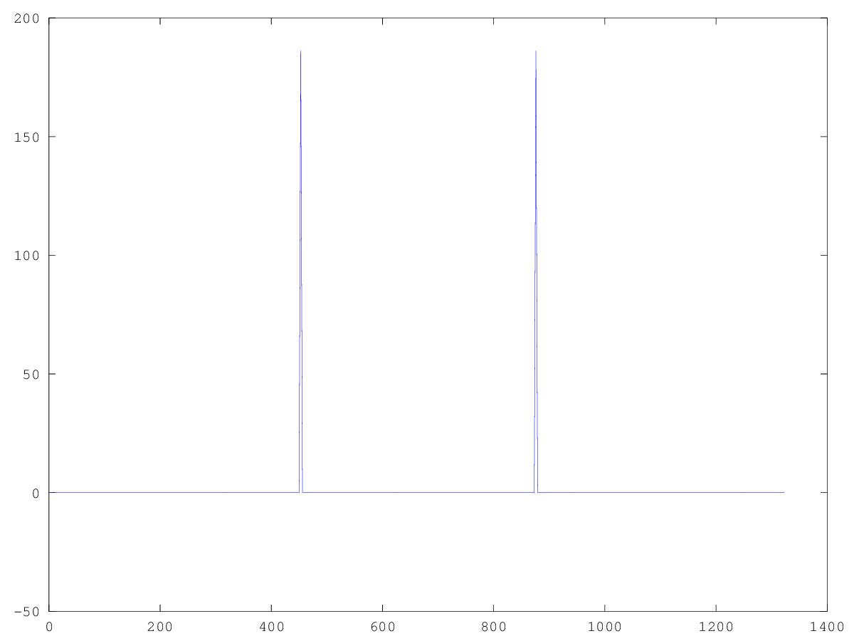

You are plotting discreet time points on the wave and joining the dots with straight lines, THAT DOES NOT WORK, it is not how any sane DAC works!
You have to lowpass filter to get the continuous time reconstruction, not linear interpolate, or spline fit or anything else, LOW PASS FILTER.
plot (k,fft(xt)) {scilab} will show you the two components in the frequency domain, note what happens as your frequency approaches Fs/2 (the middle of the horizontal axis).
That upper spike is the lower sideband of the first image.
Incidentally, k=1:441 makes reading out frequencies in the fft easy.
Regards, Dan.

Low pass filter can't delete the low frequencies inside samples , for example if low pass filter is ideal positioned at 20Khz the sine at 15KHz pass trough and all sine waves below .
fft on my example there is a "line"(sine tone) at low frequencies .
I have just tryed it and i don't found significant effects
In last istance for CD is not a big problem component over fc/9 have a small amplitude but is a digital noise .
If you violate the boundary conditions of the theorem by doing an incorrect reconstruction, you get erroneous results. Your results are erroneous. I'm not sure how many times this needs to be repeated.
You might want to put your spreadsheet away and do the actual experiment with an ordinary ADC/DAC system- when your experiment gives you a different result than your calculation, discard the calculation.

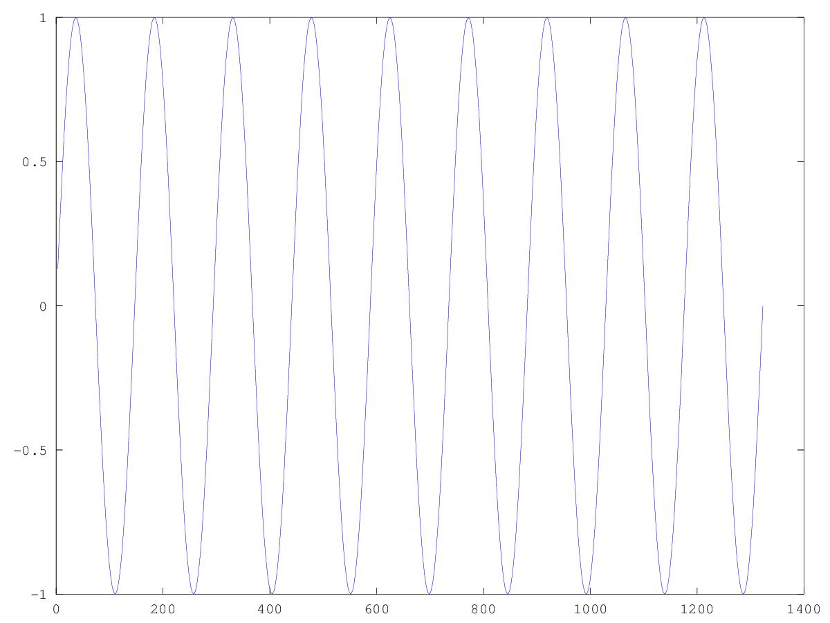

Step 1
Ok i complete understand what do you toking about .
Now i propose you the complete example.
1.Consider a pure sine tone placed at 15KHz this is all
inside fc/2. where fc is sample rate
2.Applying an ideal ADC to the sine uder octave
k=1:441
tc=1/44100
xt=sin(2*3.14159*15000*k*tc)
plot (k,xt)
3. The plot is this

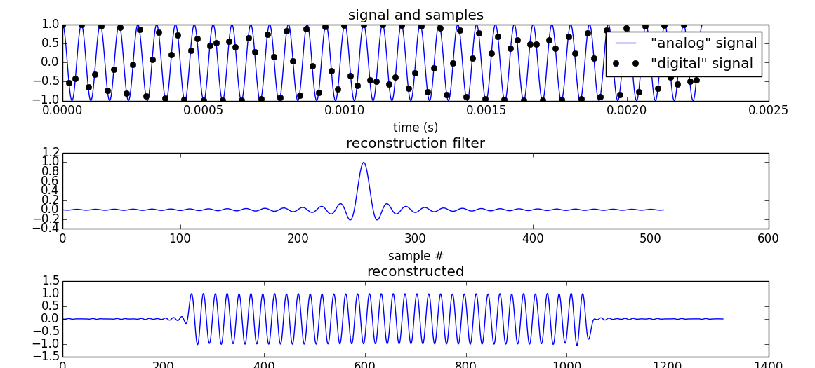

Here ya go.
First I create an "analog" signal (it's just oversampled but that's well enough so it looks pleasing to the eye).
Since it is a pure 15k sine, it is perfectly bandlimited and by sampling it at 44.1k, no information is lost. The samples are the black dots.
It looks like there is a beat frequency, visually.
Note I do not display lines between samples because it makes no sense. Lines should only be displayed when the oversampling is high enough (or the signal slow enough) that linear interpolation doesn't give too much bogus results. Which is obviously not the case here.
The sinc reconstruction brings back the original "analog" signal, as you see. No problem.
Code:
from numpy import *
import matplotlib.pyplot as plt
# create "analog" signal
def make_signal( Fs, NSamples, freq, oversampling ):
	Fs *= oversampling
	NSamples *= oversampling
	t  = arange(NSamples) * (1.0/Fs)
	return t, cos( 2*pi*freq*t )
Fs       = 44100.
NSamples = 100
freq	 = 15000.
plt.figure(1)
plt.subplot(3,1,1)
analog_t, analog_signal = make_signal( Fs,  NSamples, freq, 16 )
plt.plot( analog_t, analog_signal, "b-", label='"analog" signal' )
digital_t, digital_signal = make_signal( Fs,  NSamples, freq, 1 )
plt.plot( digital_t, digital_signal, "ko", label='"digital" signal' )
plt.xlabel("time (s)")
plt.title("signal and samples")
plt.legend()
plt.tight_layout()
plt.subplot(3,1,2)
reconstruct_oversample_ratio = 8
reconstruct_length = 32 * reconstruct_oversample_ratio
impulse = sinc( (1.0/reconstruct_oversample_ratio) * arange( -reconstruct_length, reconstruct_length ) )
plt.plot( impulse )
plt.xlabel("sample #")
plt.title("reconstruction filter")
plt.tight_layout()
plt.subplot(3,1,3)
# recondtruct sampled signal
# first insert zeros
digital_signal_padded = zeros( NSamples * reconstruct_oversample_ratio )
digital_signal_padded[::reconstruct_oversample_ratio] = digital_signal
# then convolve (very dumb method)
reconstructed = convolve( digital_signal_padded, impulse )
plt.plot( reconstructed )
plt.title( "reconstructed" )
plt.show()

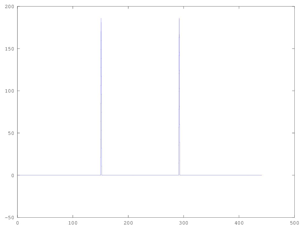

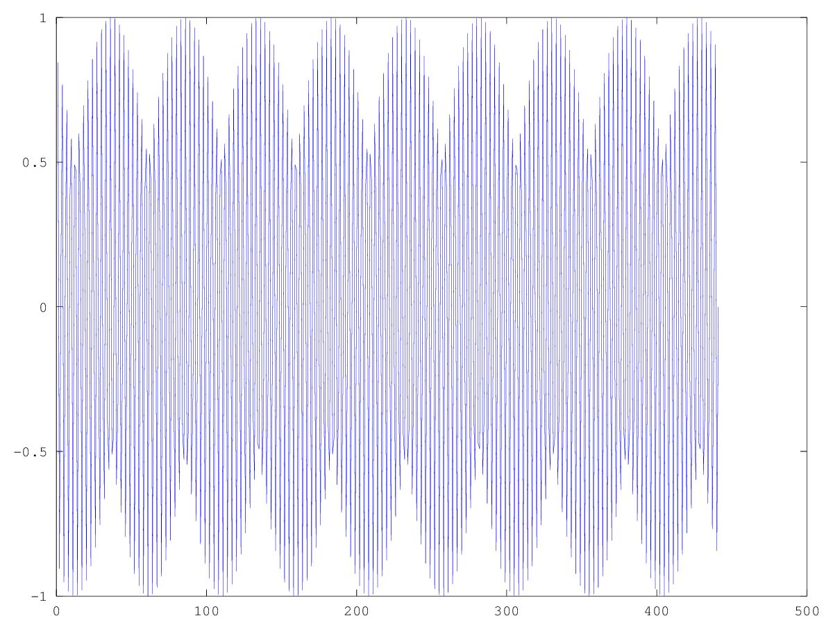

next step
3 step
On fft is not present the modulation results see step 2 because they
on ideal sample rate the images at dx an sx off zero axis
are in opposition of phase .
But i wont to see them now now we need to separate the samples of +fd and -fd where fd is modulation results .
We take a 3k samples on octave
and print out the results on octave
m=3*k
xt=sin(2*3.14159*15000*m*tc)
plot(m,xt)
And results are this
In last
Is possible the two modulations +fd are not exactly in opposition of phase time error on samplerate that means there is a noise. contribution under fc/2 and pass trough the filter
unchanged .
