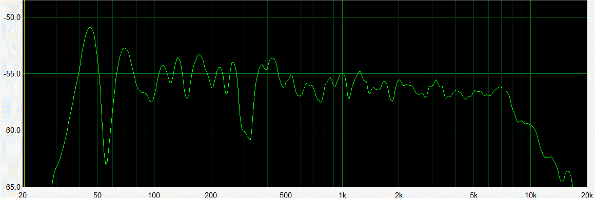

Does this valley have a characteristic that suggests its cause? I'm looking to boost it and notch the central peak but it doesn't seem right. I suspect (guessing from my conflicting data) that the dips either side of the peak are modal.

Maybe I'm misunderstanding what you're trying to achieve with your query, but is this a spatially averaged read?
If woofer location(s), phase, etc haven't been optimized first, it's kinda moot to guess at the cause. There wil be dozens of interactions occuring in the frequency range shown. Unless the room is hemi-anechoic with only one boundary, it's simply too complicated to worry about in the real world.
Dr. Geddes correct me if I'm mistaken: As I understand it, boosting should only be done as a very last step to correct broad deficiencies of a few dB after everything else has been optimized. There really shouldn't be any deep notches left at that point.
-- Mark
Hi Mark
I'd agree that EQ should only be done after the multiple subs have been placed and optimized for gain, phase etc. But there is still a high probability of a valley in the response somewhere. But a valley should almost never be EQ'd up to 0 dB that could end up being too much gain at a single frequency.

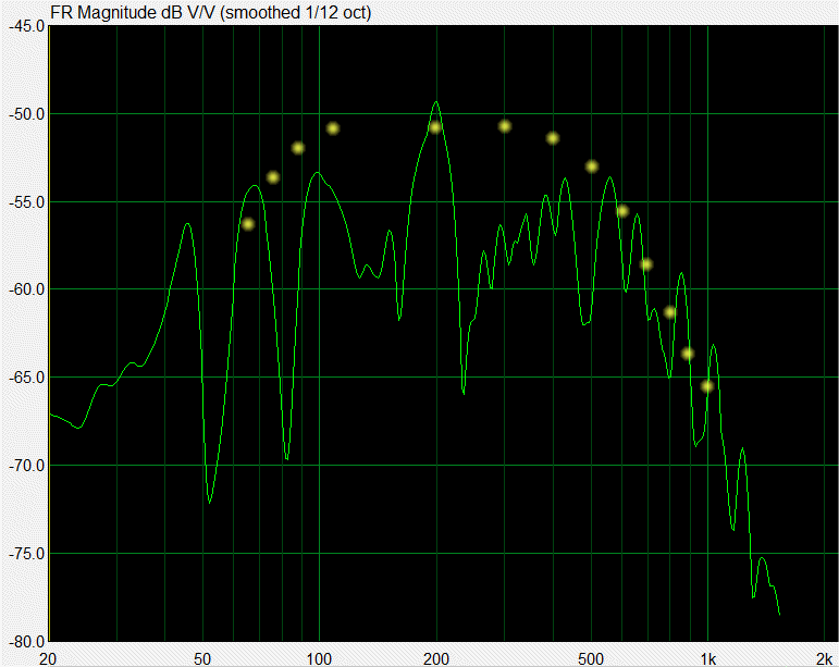

Have some trialling to report on. The previous plot was one main from the listening position. After new sub locations, this plot is the entire system at the listening position.
The significant thing is that the subs are being employed at full level until 300Hz, where they shelve by 12dB until 800Hz. This has improved the midrange dramatically. Localisation is very minor, and barely of concern considering the improvement.
This leads me to feel that there is a grey area for an octave around fs. I'll need another sub to target the sub 100Hz region but I will not need any high Q filtering, especially if I can tweak the dip at 300Hz.
