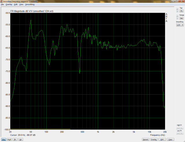

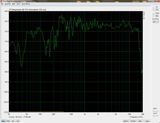

I bought an equaliser and tweaked the bass into line and although it is still quite peaky, my listening impression is that my room is no good. It is 24x12x9 but it opens up into three other rooms and these openings are not symmetrically placed. The walls are lossy and I have moderate bass trapping.
Should setting up multi subs be any harder for me than if I had a dedicated sealed room?

I am now going to turn my speakers a further 10 degrees off axis because I suspect that the listening axis response should resemble the power response.

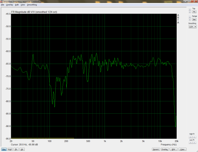

I'm also going to hang some new first reflection absorbers. I'm hoping 2 inch rockwool spaced at 4 inches with a 30 degree incidence will damp a 200Hz cancellation that is already 12dB down from the direct sound.

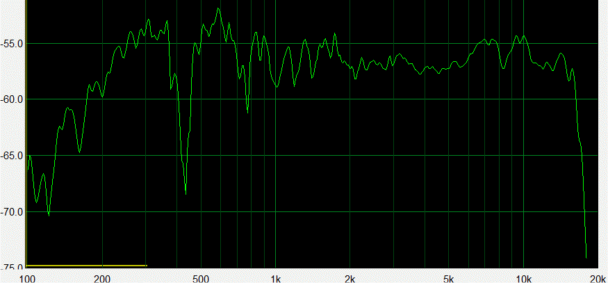

I am currently trying to track down a sharp null at 410Hz on listening axis at 1m, and I have tested adding a temporary 4 inch rockwool absorber at each reflection point and each cabinet boundary. For all I know it may be a room mode. Is there a step by step process I can go through to find it?
Here it is.
