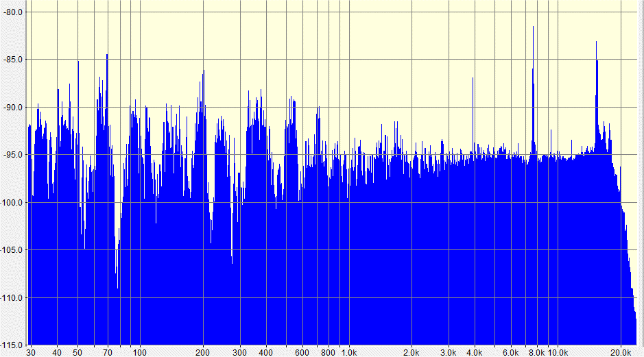

Here is a spatially averaged plot of where I am at in the bass. Some EQ has been used here.

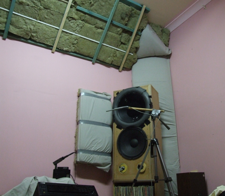

I have recently added a further 25 square feet of bass trapping to the existing 45 square feet (the prime of which is 10 inches of rockwool spaced 10 inches from the corner). The sound is more revealing than ever, and truly good, but not perfect.
Chasing good sound is like the proverbial drug. I'm not sure when or if I'll be satisfied. For now, I'll rest on the data. This plot is not perfect and I suspect it could be better in practice.
The EQ I have is inadequate but useful. It's discrete levels are too far apart as it seems I really am chasing +/- 1dB in some areas. I never thought a single dB either way was as important as I do now. It's just 'everything', when you know what I mean.

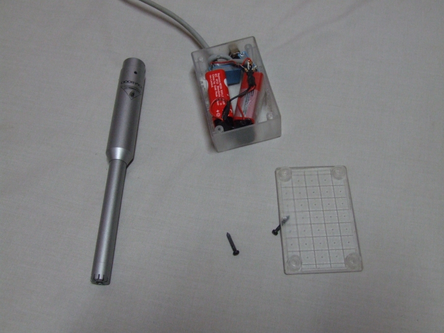

Do you have a picture of that measuring setup?
