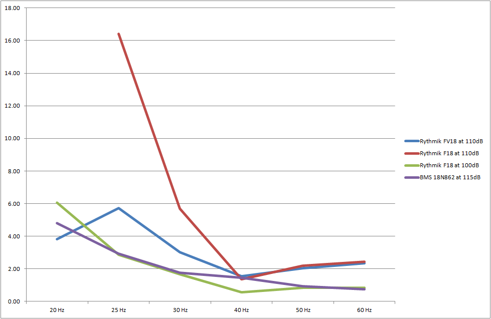

I examined three of the systems you plotted and found your comparison, plotted for 115dB, to be seriously misleading. The Rhythmiks when played within their limitation have no distortion like you posted. If plotted at 100dB, the standings would be quite different.
Loudness discussed below is measured in an open field out of doors at a few feet. Indoors at home, that open field "100dB" might be loud enough to damage your hearing and "115dB" (when indoors) for sure.
Rhythmik FV 18 distortion is quite is low, less than 3% at 20-200 Hz (very low mid-band) up to 110dB. But louder it seems to falter although not dramatically as your plot suggests. So reporting results at 115dB as you plot is... (I'm not sure what is the best word here).
Likewise, the F 18 has almost unmeasurable distortion at 100dB, rising a bit below 30 Hz to maybe 5%.
The BMS in a larger box does produce good sound at 115dB that is not apparently to my viewing to be too much more distorted than the Rhythmiks at their lower loudness and certainly nothing like your plots would lead readers to think. But then the Rhythmics can be pushed to play 115dB although with a modest increase in distortion - but much less than other non-MFB speakers. Great driver, if very very expensive driver (plus the fancy box that data-bass had to build).

I posted THD data directly taken from Data-Bass site - no misleading here. Rythmiks were played within their limitations, read carefully the tests in Data-Bass site. Rythmic FV25HP was tested also at 120 dB!I examined three of the systems you plotted and found your comparison, plotted for 115dB, to be seriously misleading. The Rhythmiks when played within their limitation have no distortion like you posted. If plotted at 100dB, the standings would be quite different.
If plotted at 100 dB, the standings will be the same! Simple logic - all subwoofers have lower THD at lower SPL. So, BMS at 100dB certainly has much, much lower THD than its own THD measured at 115dB!
According to you, how many dB you will measure indoors at home with a loudspeaker which measures 100dB outdoors? 🙄Loudness discussed below is measured in an open field out of doors at a few feet. Indoors at home, that open field "100dB" might be loud enough to damage your hearing and "115dB" (when indoors) for sure.
There is no such magic here on Earth which 100dB speaker outdoors can turn to damaging dB indoors. Read about the "Critical distance (Dc)" in any book for acoustics.
Are you aware of THX standard for surround sound, which demands subwoofer SPL = 115dB at the listening position? And Fletcher-Munson curves at low frequencies?
The best word here is: you are comparing apples and oranges! The lowest tested SPL for BMS was at 115dB, there are no measured THD data for 110dB or 100dB for BMS in the Data-Bass test. Because of that, I compared all subwoofers at 115dB (comparing apples and apples).Rhythmik FV 18 distortion is quite is low, less than 3% at 20-200 Hz (very low mid-band) up to 110dB. But louder it seems to falter although not dramatically as your plot suggests. So reporting results at 115dB as you plot is... (I'm not sure what is the best word here).
My plots do not suggests, they are obvious and hard evidence - graphs are plotted from data directly taken from measured graphics in Data-Bass tests.
Contrary to your words, Rhythmik FV18 distortion at 110dB is higher than 3% at 20, 25 and 30Hz! It is 3.87% at 20Hz, 5.72% at 25Hz and 3.03% at 30Hz. You can see these percentages also, if you position cursor from your mouse directly over the measured graph (at 110 dB) in the Data-Bass test.
Likewise, if you hover mouse cursor over the measured graph in the Data-Bass test, you will see Rythmik F18 distortion at 100dB is very measurable: 6.07% at 20Hz, 2.87% at 25Hz and 1.67% at 30Hz.Likewise, the F 18 has almost unmeasurable distortion at 100dB, rising a bit below 30 Hz to maybe 5%.
Even with such SPL discrepance, BMS at 115 dB has lower (or same) distortion than Rhythmik FV18 at 110dB and Rhythmik F18 at 110dB and 100dB - see the chart below. Or better, see the original measured graphs from Data-Bass.
The BMS box (7.6 cub. ft) is smaller than the Rythmik FV 18 box (9.2 cub. ft), but plays with lower THD at 115dB - exactly as my (i.e. Data-Bass) plots shows. The increase in distortion at 115dB from Rythmiks are not modest: 15,2% at 50Hz for FV18 and 34.2% at 20 Hz for F18 (see the plot from my post #79).The BMS in a larger box does produce good sound at 115dB that is not apparently to my viewing to be too much more distorted than the Rhythmiks at their lower loudness and certainly nothing like your plots would lead readers to think. But then the Rhythmics can be pushed to play 115dB although with a modest increase in distortion - but much less than other non-MFB speakers. Great driver, if very very expensive driver (plus the fancy box that data-bass had to build).
BMS 18N862 truly is great, but it is not "very, very expensive" - total price for the driver, amp and box is maximum $1600 - less than Rythmiks and much less than Velodyne. That "fancy box" is a bog-standard vented box.

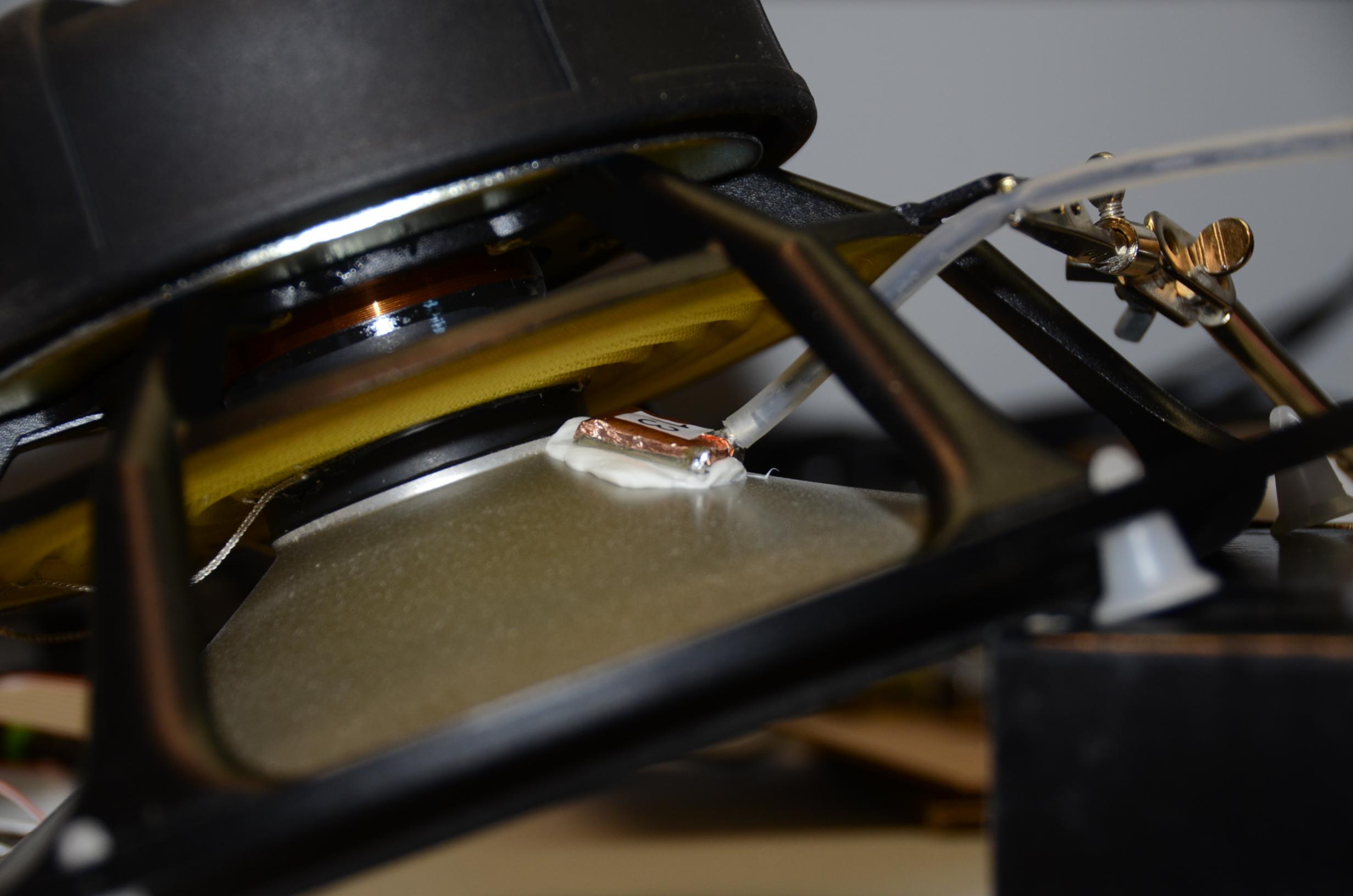

I repaired, and later on, enjoyed listening several 2-way and 3-way vintage Philips MFB speakers. I am not against MFB or any other similar system for improving driver performance, but the results so far are: expensive and not better than a conventional (very) good quality woofer.

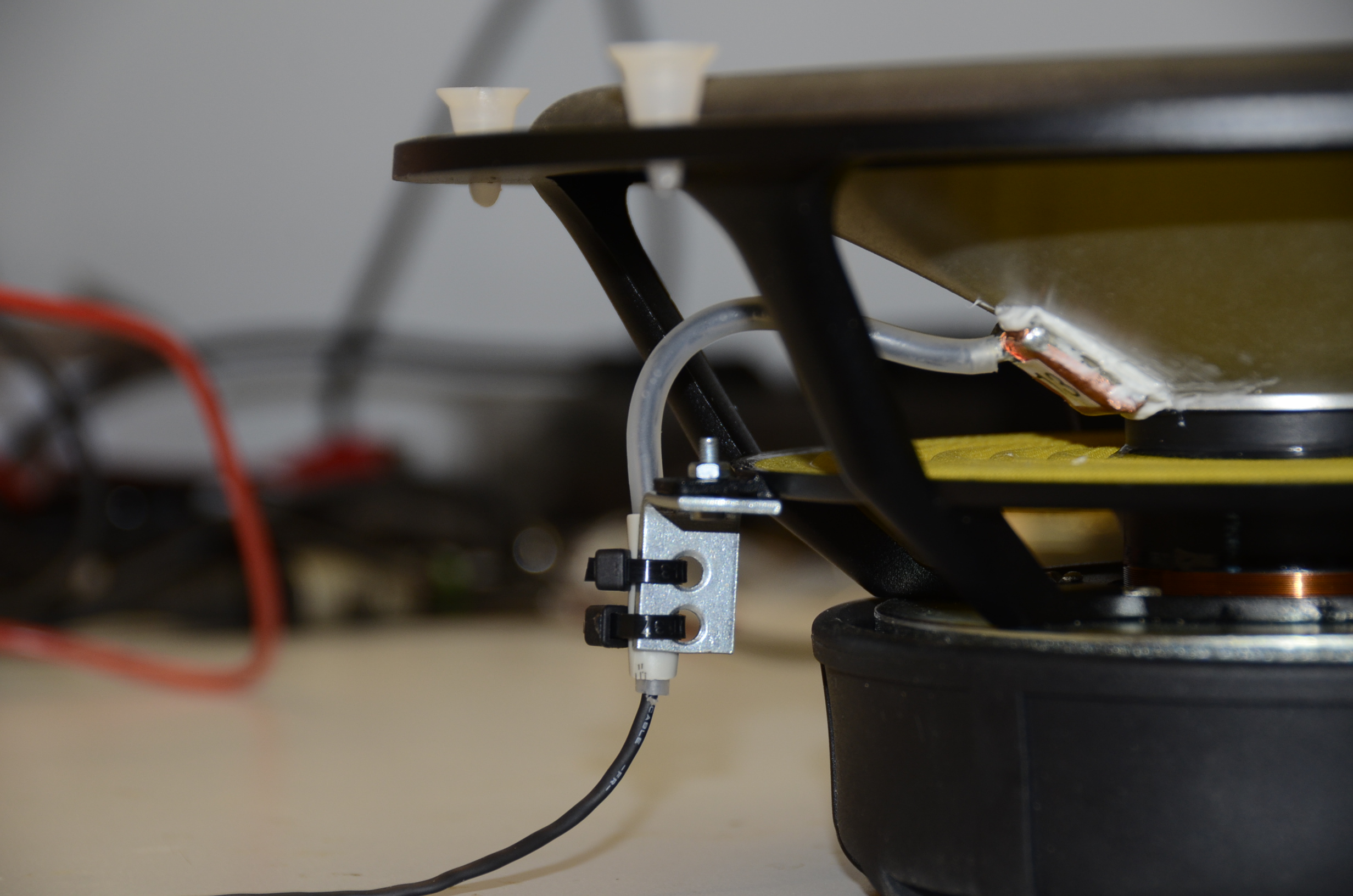

Wow nice pics! I really like how you mounted the cable stress relief on the same spot as the voice coil terminals. Quite clever, previously it was done by hot glueing parts to the spider.
Is that a SEAS Excel W22EX? Certainly looks like the excel series at least.

It's the W26FX001.

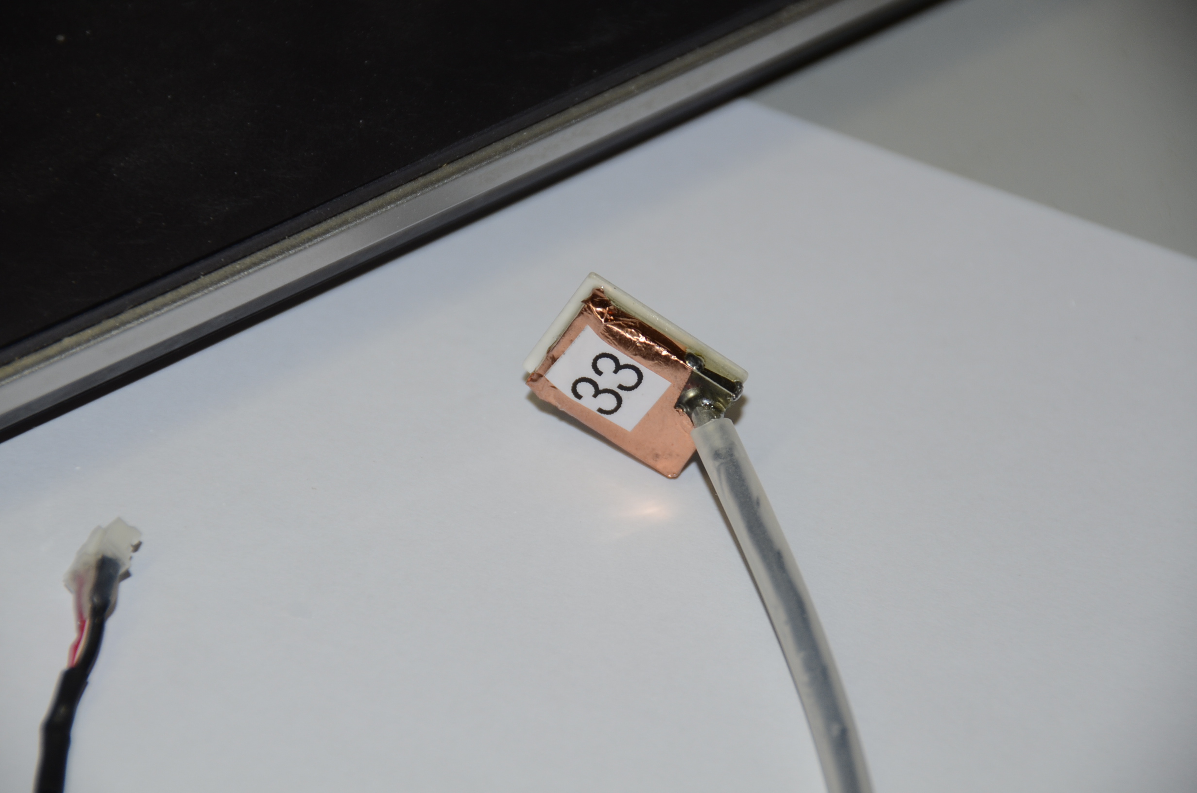

And the technology is quit cheap actually: 4 murata sensors+1 opamp+2 resistors and 2 capacitors for the sensor. Control circuit consists of 2 dual opamps and a 6 dollar dsp chip.
Nice. What is the cost of the controller electronics plus the sensor?We don't mount the sensor in the center anymore:
It looks like the wire soldered to the sensor is too thick, with too thick insulation. I would suggest much thinner tinsel wire without insulation (or with very flexible insulation) - the same used in connecting the voice coil to woofer terminals.
Edit: I didn't see your new post. But, what is the price for the whole MFB system (without the amplifier)?
