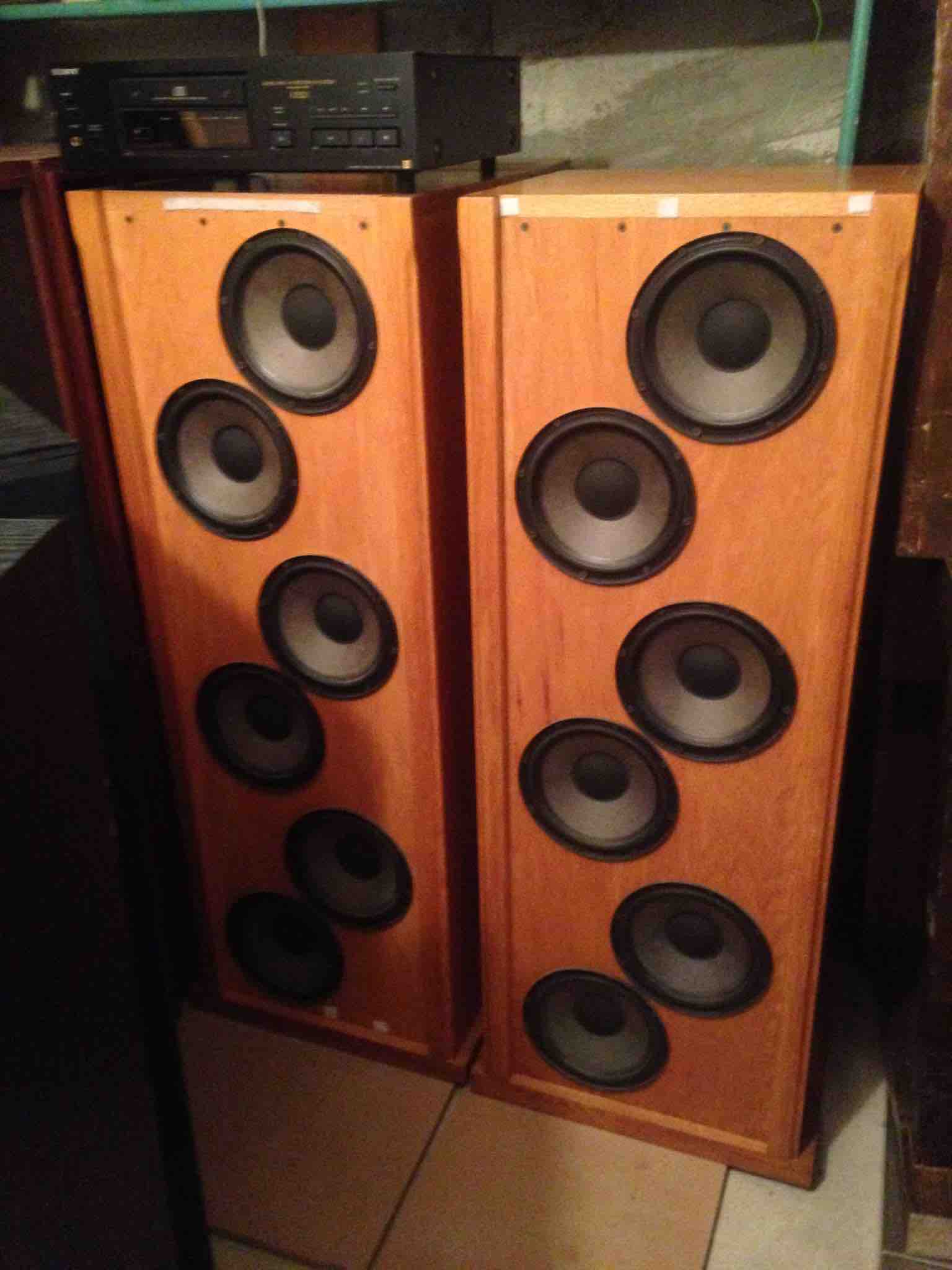

I later built a pair of 6 x 8" all Philips MFB drivers in two "conventional" looking boxes (below with grille cloth removed). It is considered that a good MFB system (in the absence of a signal being applied) ought to break a hammer if the hammer is applied to the cone. 🙂 I haven't tried this though. In any event my preference was to a pair of Philips 12" MFB drivers each in a slightly smaller enclosure. Most striking was hearing what can be described as thundering vibrato of simultaneously occurring lower register organ notes that the multiple 8" drivers couldn't do nearly as well. The MFB subs contain an input parametric equalizer to "mostly" remove the dominant room resonance along. This feeds a multistage low phase shift loop filter. The feedback was sufficient to drive the resonance down to about 10Hz with considerable peaking that warranted some consideration.
