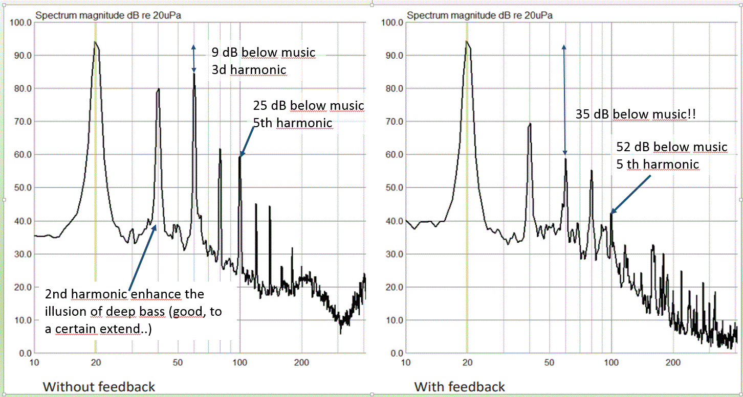

One point which has not been discussed is the fact that all these solutions has only been applied to closed box designs. Only the ACE Bass (current drive) solution takes a vented design into consideration.
The ACE bass is not current drive. It uses current sensing to generate a complex, partly negative, output impedance for the driving amplifier. This quite simple and reliable technology was presented in 1978 and is still in use by ACE/AudioPro, Yamaha for its affordable bass loudspeakers, and PSI.

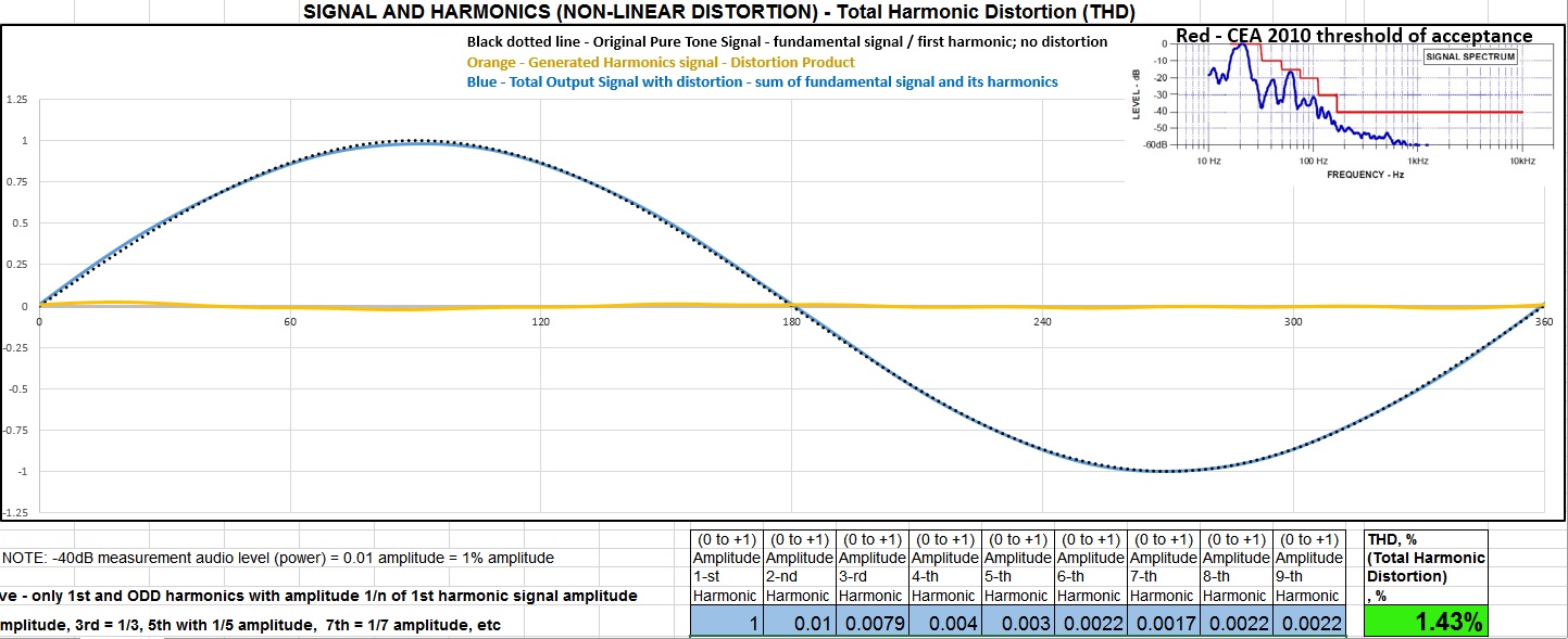

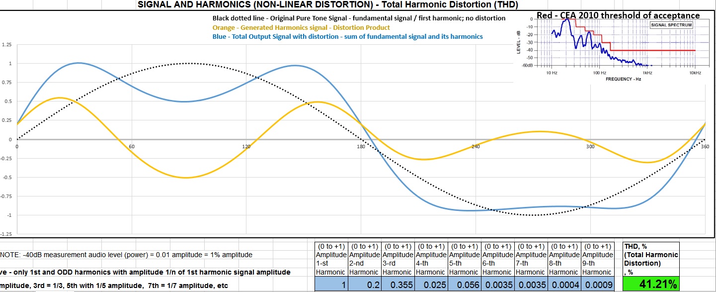

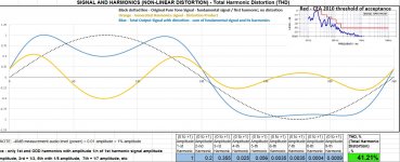

^^^^ Wow! That's really impressive!
Taking THD from 41% down to 6.6% ! ! !
Here is how based on the distortion measurements listed above the cone movement would look like before and after servo correction

On the other hand as somebody mentioned already if you start with a cleaner driver which is not driven past its limits you will not need servo correction as much.

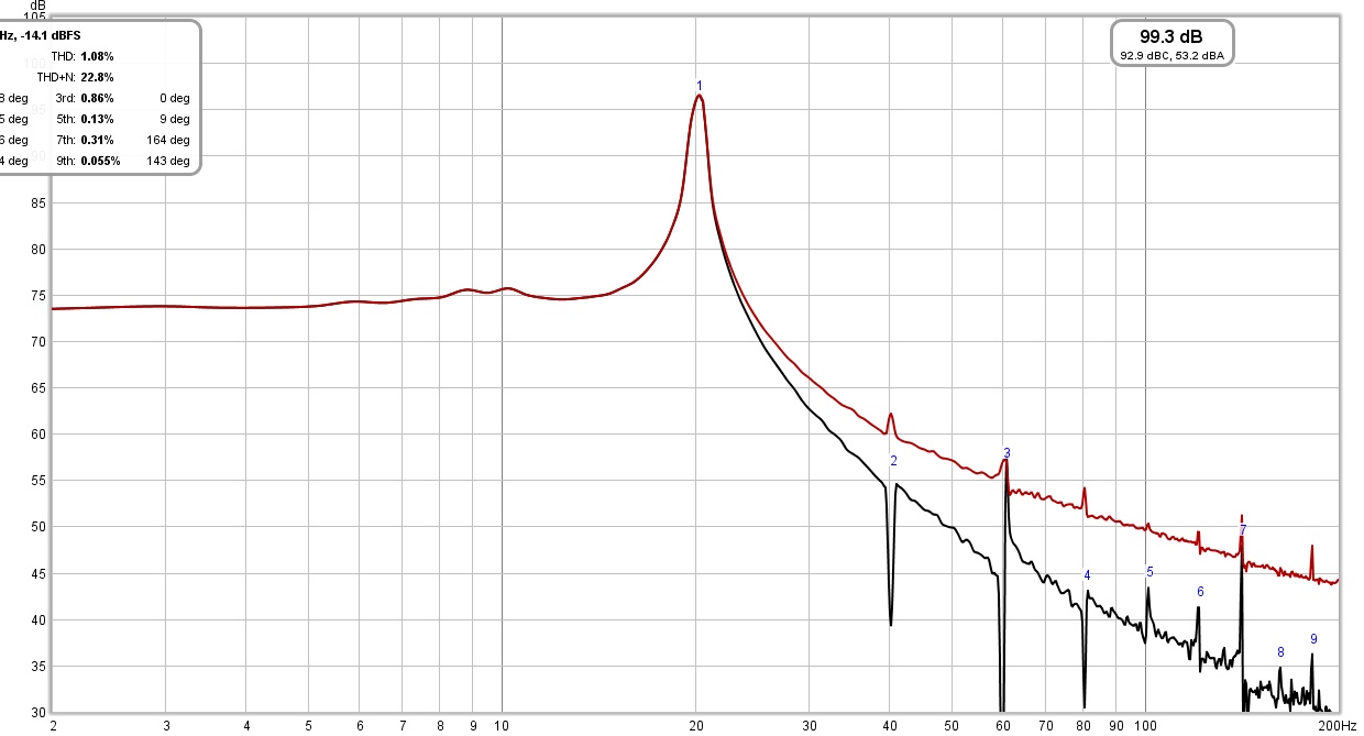

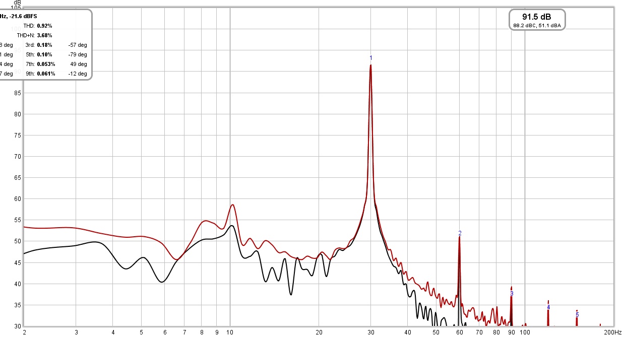

Below is my sealed sub with just regular $45 driver "Dayton Audio 8" DCS205-4".
Driven at 0.8 Xmax;
18Hz distortion measurements
THD = 1.4%

Those figures for THD look like nothing I've ever seen before for any driver of any kind. Could it be due to testing at 18 Hz that is far outside the usual band for an 8-inch driver or other aspects of your test system?
B.

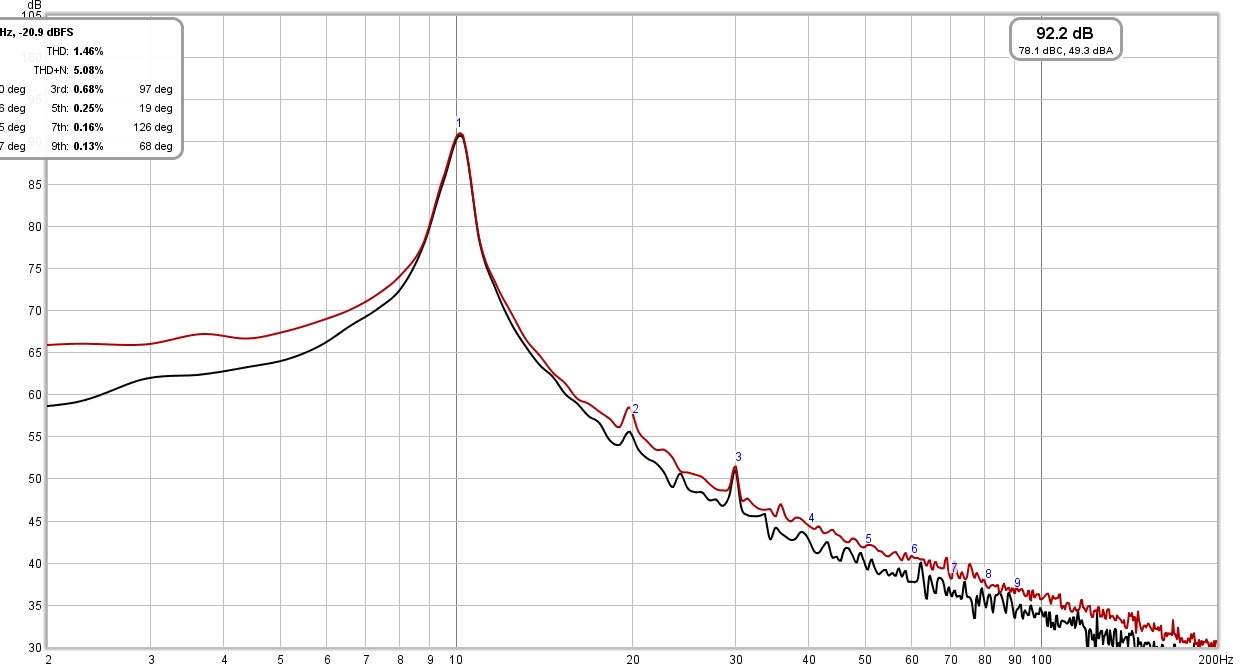

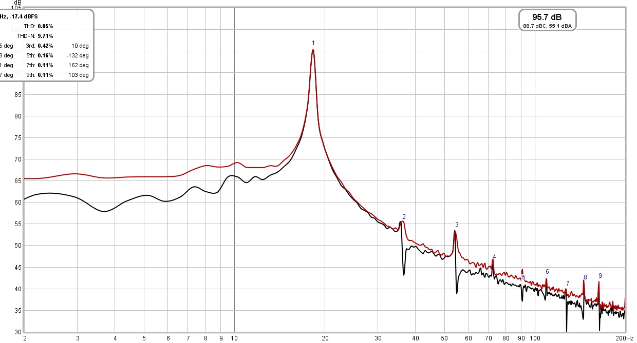

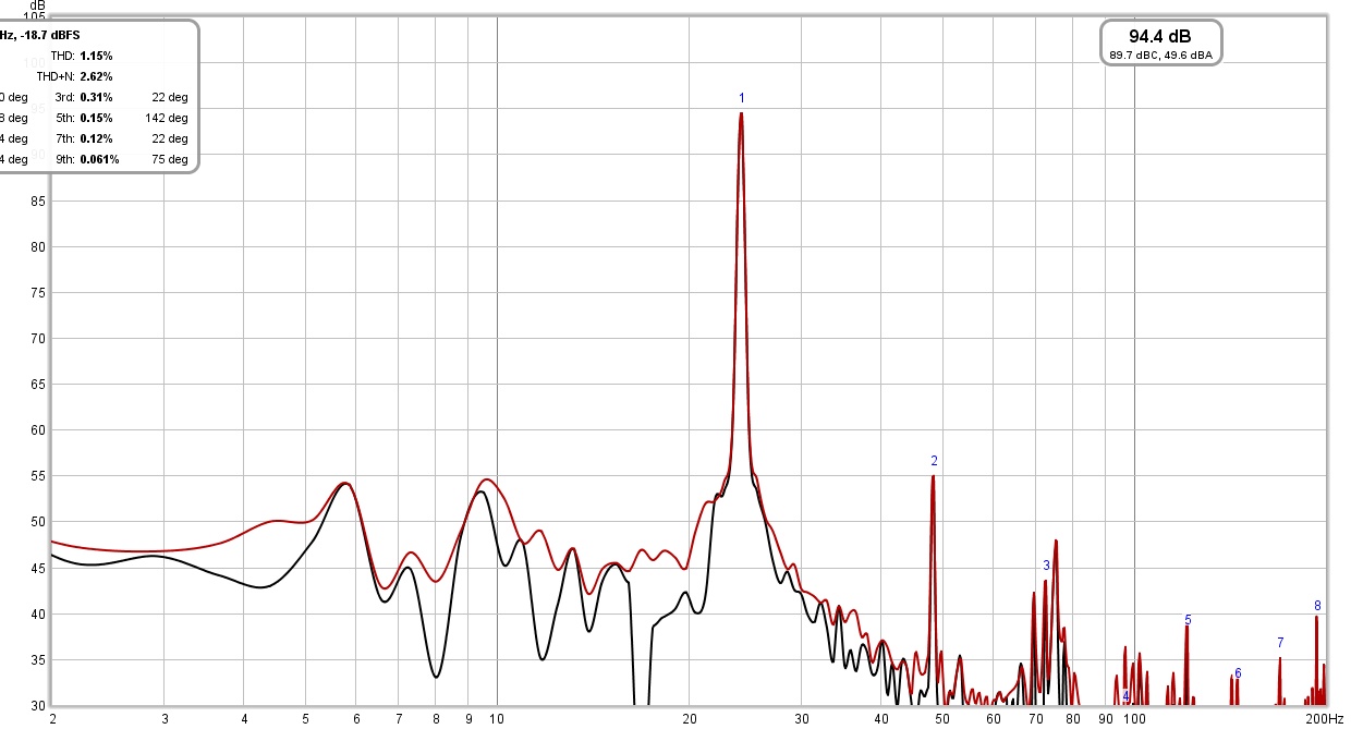

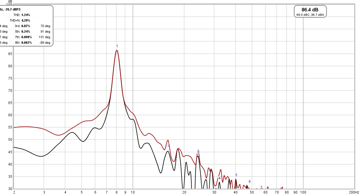

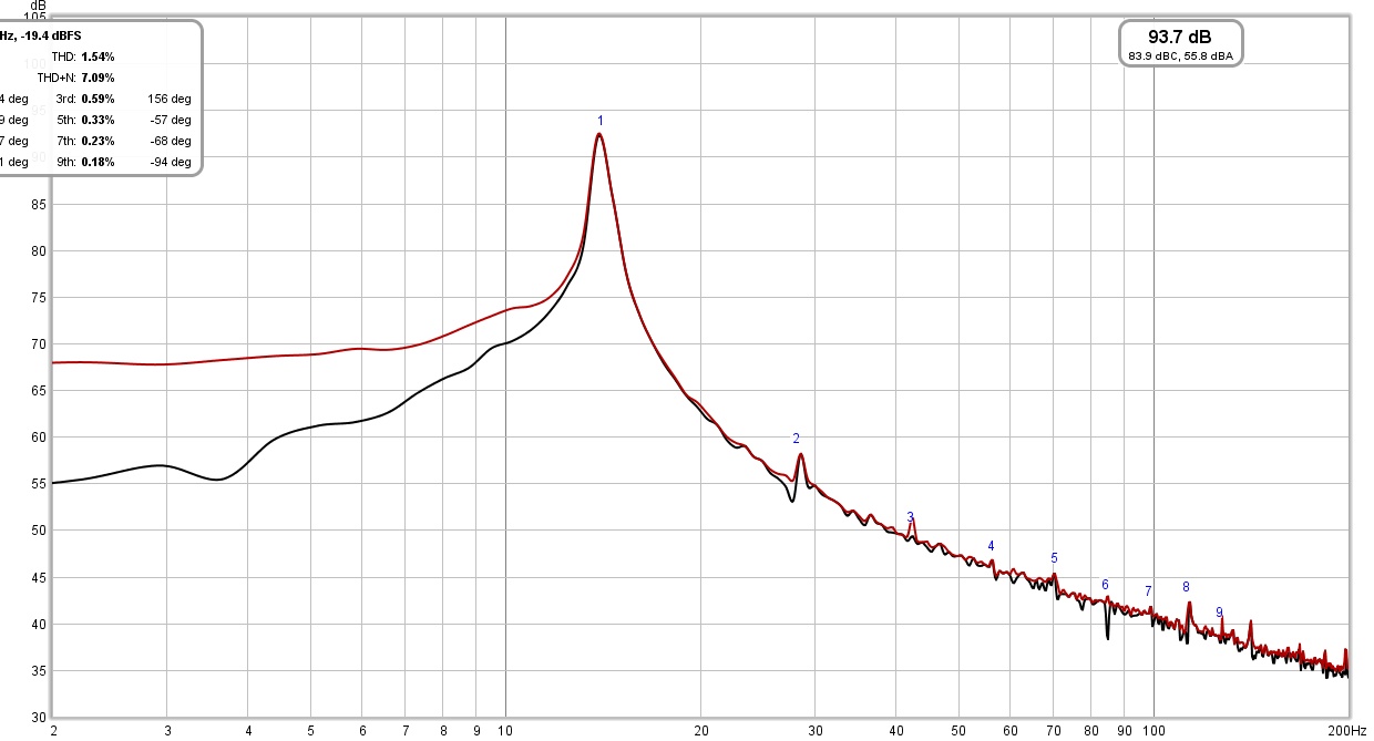

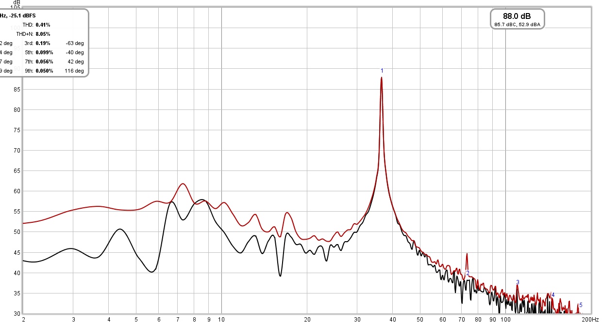

@Ben
Here are my subwoofer full spectrum measurements - from 8Hz to 37Hz (xover is at 40Hz).
Measurements are done with REW and calibrated UMIK.
For 8Hz-37Hz range the THD is around 1%
Really clean sub...
