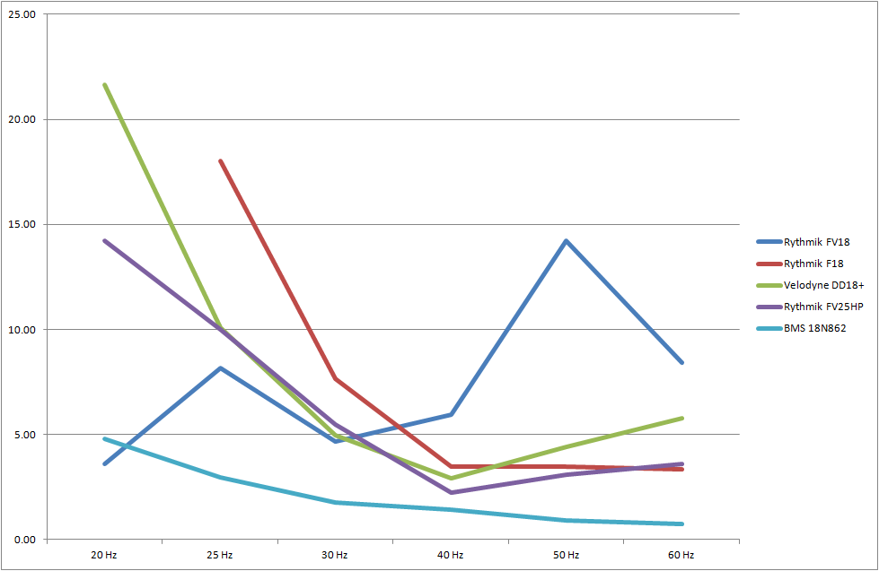

Servo subwoofers vs Ordinary subwoofers
In theory, servo controlled subwoofers should be much better than ordinary subwoofers. But, real life is somewhat different. Data-Bass site ( dB v2 ) tested many subwoofers in great detail, including Servo controlled subwoofers. How they compare to an ordinary, plain vanilla subwoofer? I made a simple chart with the data from Data-Bass tests. Rythmik and Velodine models are well regarded Servo controled subwoofers with 18" drivers (Rythmik FV25HP has two 15" drivers). Ordinary, passive subwoofer is with 18" pro woofer BMS 18N862. All THD measurements were made at SPL=115 dB.
Here are the results (on the left side is THD percentage). Surprise, surprise!

You are missing the point: the most revered Servo controlled subwoofers are much worse than an ordinary pro woofer slapped in a vented box!Well the BMS woofer is setting you back 550 USD for the driver only. Put a servo on the BMS and you get 10dB reduction easy and very low cost..
"Very low cost"?? Let see:
Rythmik FV18 = $1874
Rythmik F18 = $1630
Velodyne DD18+ = $5000
Rythmik FV25HP = $2600
BMS 18N862 + amplifier Crown XLS 2502 + vented box (custom made) = $550 + $650 +$400 = $1600
"Put a servo on the BMS..."? Why on earth? BMS already has much lower distortion than the best servo controlled subwoofers in the world.
