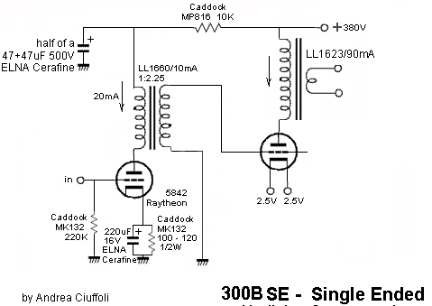

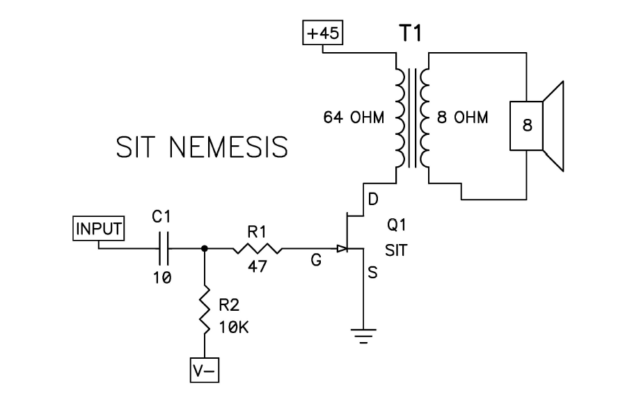

I wouldn’t say that. There are things you can do with toobz u cannot with fets, but also the other way around. Take the SIT-1 for example. I am no expert, but I doubt such a simple circuit would be achievable with toobz.
look familiar ?

For 0.003% difference in THD, I would choose Fairchild any day. 😉
Pity that you did not publish any figures for the Semisouth for apple-to-apple comparison.
Or any active, not-unobtanium Fairchilds.
Cheers ,
Patrick
Onsemi seems to be working really hard at discontinuing our favourite parts but I'll test some of the Onsemi/Fairchild candidates I have on hand.
I don't know why I never saw it in previous searches but apparently Onsemi makes a SiC too! Not inexpensive but the datasheet (SOA, gain) looks nice.
