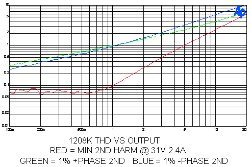

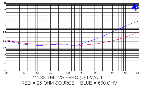

Here's a couple curves I ran on it a few years ago, Common Source without
feedback into 8 ohms. One thing that recommends it is a load-line character
that gets a 2nd harmonic null to .1% at 1w. Bandwidth is 100 KHz with a
600 ohm source, which is also pretty good.

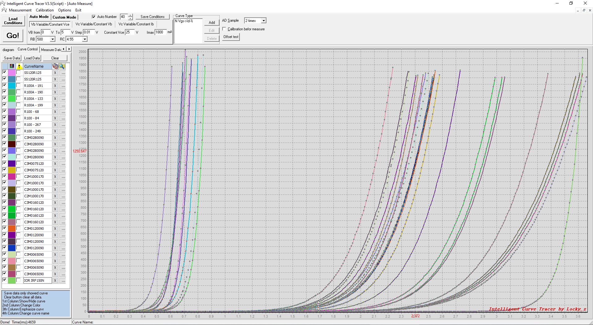

I couldn't get the trace to work on that one but it measures DUT fine. I ended up getting a new one from Locky_Z on eBay actually and even there I struggled a bit (thanks to Dennis for rescuing me!) to get the latest software working.
It's a great toy for sure! I just wish I could find a way to use these Cree parts ...
I have some IXTH6N50D2 as well. I'll measure those next.

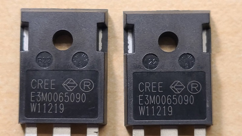

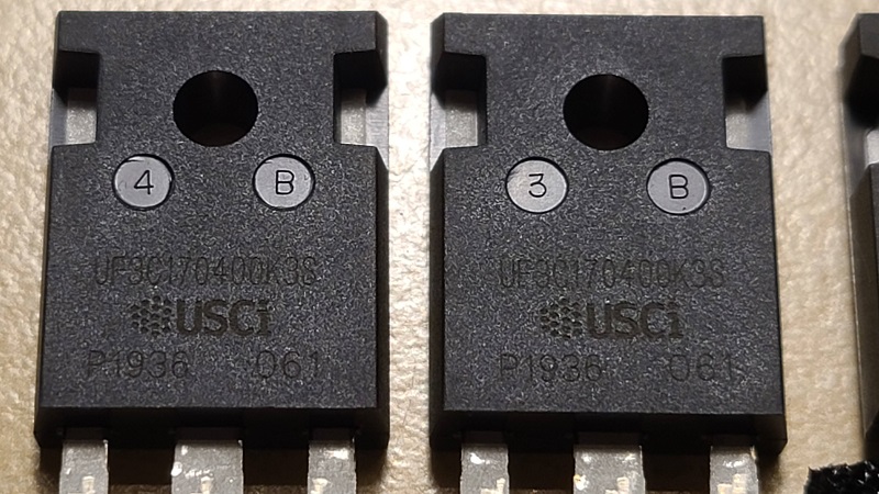

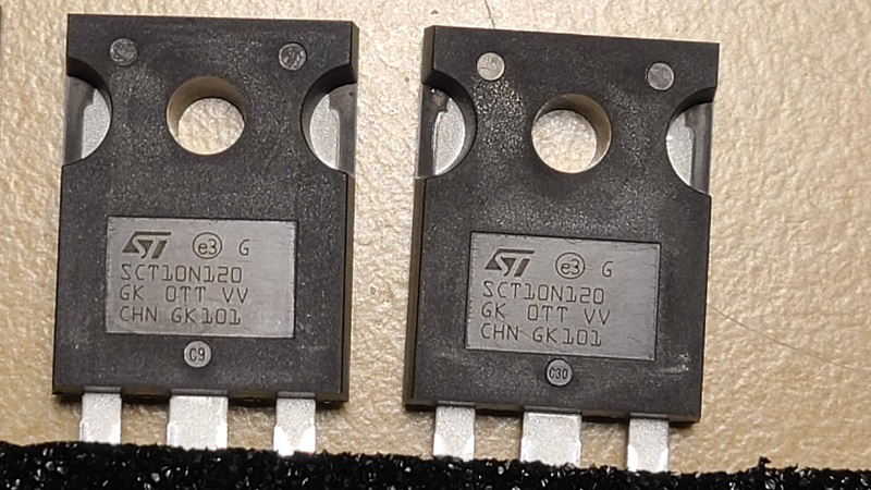

Continuing the exploration from my F2J experiments and thought maybe this thread is more appropriate because I have an F6 Cree as well as F2J Cree running and a 3rd FW derived amp with Cree device instead of SS so it's not just F2J that can use these SS alternatives.
I have a couple of favorites from Cree but some of those are hard to get now so here are the next 3 challengers. 1 from Cree, 1 from United and 1 from ST.
This will be fun!
Not a fan of that Cree 650. They sounded metallic having poorly focused bass compared to IRFP in SE arrangement, 19v+/-, 1.6A with aleph ccs. But I'd love to hear that someone got them to work, perhaps they want/need a particular operating point and input. I eventually put SS R125 in there and never looked back... warm, articulate. Enterprising minds might do better though.
