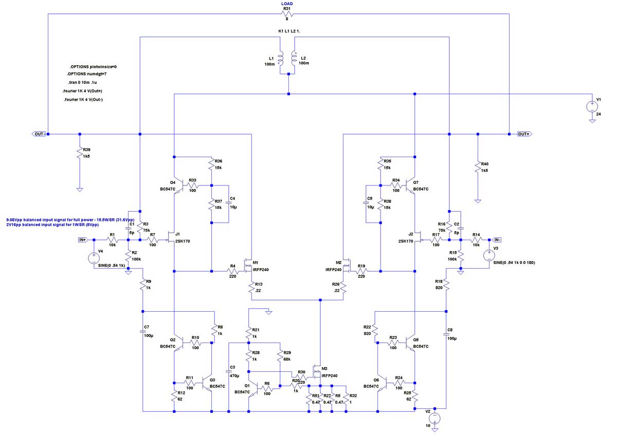

while , few years ago , I was contemplating about these amps I knew that servo is clever thing to have for iteration with CCS loading on top , I didn't realize that for split load choke one doesn't need servo , at least not for having same DC potential on two outputs
(so - it isn't new that I'm dumb , it also isn't new that I know that ..... and what's new is that I realized what's written above
reason is so obvious that I don't need to explain it
however - potential mismatch between two output mosfets (Jfets , whatever) can lead to unequal current through two halves ...... and you know that chokes are not humble but humable , when put in that position
in practice , one need to use matched mosfets ( preferably at 2A , where Iq is set ) and any further tweak regarding L-R Iq is easily achieved with small trimpot in source of input Jfet , on more current hungry side
note number 13 - you both know that , irrelevant which part is used here ( IRFP , SJEP , SJDP , cascoded LU - all of them easily adopted with just FB net change ) , max power is in range of , say , 15W/8R
that figure coming from Iq of 2+2A , and load of 8R , which is , in fact , more like 4+4 - at least concerning each half of amp
so , I'm expecting that this thingie is gonna work , maybe without or just little polishing
now , I need to implement some of things simmed here , to Magura's Donuts - to slightly change lower CCS arrangement , just because he was either lazy to implement some NTC correction circ in , or it was absolutely impossible , taking in account that difference in temp between full temp and Dodo of his amps is some 5(five) C

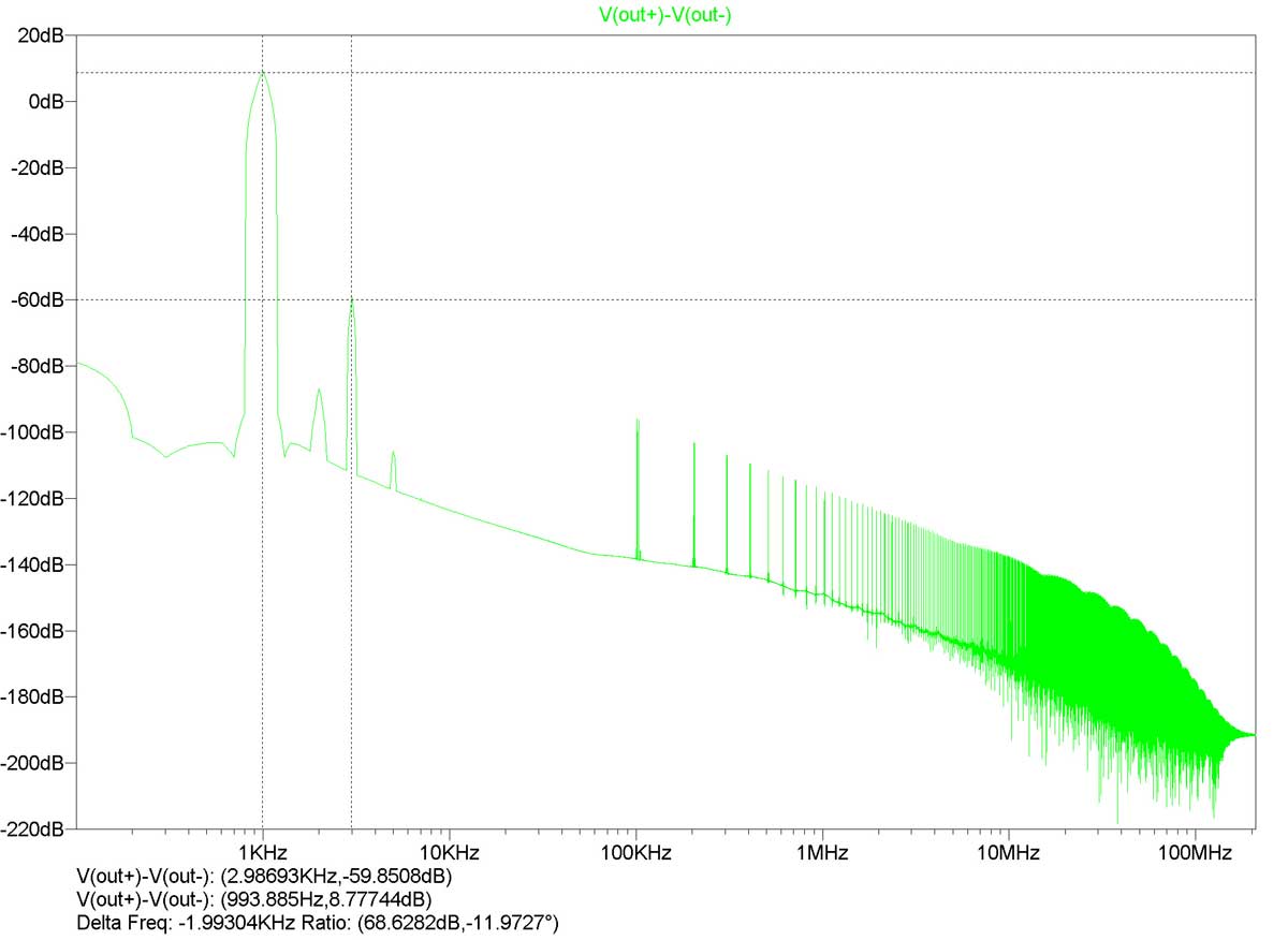

pics are result od LTSpice sim , so usual disclaimer - that's sim ........ and - even more important - sim by Mighty ZM
edit - both pics are for 1W output

so , when ready , just say which critters you wanna in
same goes for wakoo Viking
then I'll fire sim again and look at some details

R085 or R065 are most likely candidates. I found out from Mike that R065 is indeed enhancement mode, but with lower Vt than R100 of about .4V.
Question. How do you go about choosing transformer for this amp. I think you suggested 500VA and 110 secondaries. You know me, I dont know squat about chokes and this is first choke loaded amp.
Project down the road, as I am imbedded in another at the moment🙂, but i would like to order toroid now as part of GB.
please - search in Magura's posts what's L of his (air) chokes
then look for biggest toroid you have at home , measure it's primary inductance ( mains disconnected , please
) and you'll know what to expect
I mean 500VA core is minimum , going up can't hurt
I'll make sim with SJEP for which I have models ; later - all you'll need is to fiddle a little with bias pot
CCS mosfet - I recommend IRFP150 - big honker
