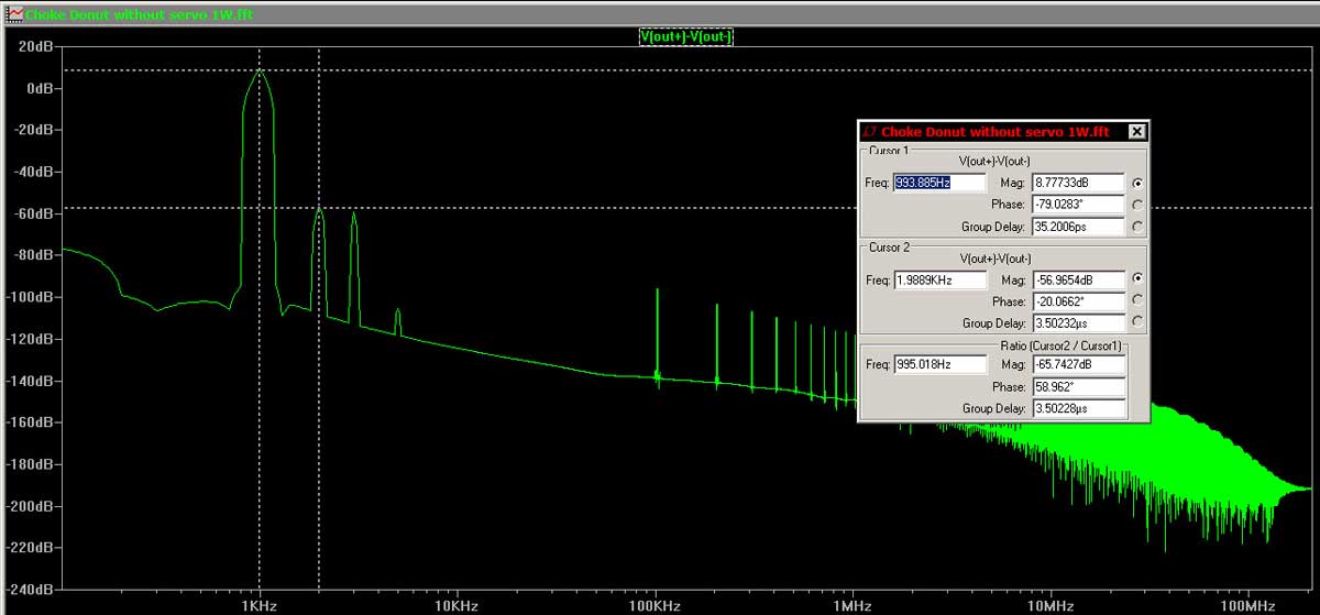

It was. Can some(mighty)one interprete what we are seeing on those sim-curves. Is that your fallos on 1kHz.

falos basic signal at 1K
the 2k 3k 4k 5k 6k 7k 8k etc
less you see them , the better , except basic one
but , what you see , must go down nicely and monotonic
here's the same (sim FFT) , but with minus input Dodo , upped plus input , working as unbal to bal converter
rising second harmonic , logically , comparing to full bal arrangement
