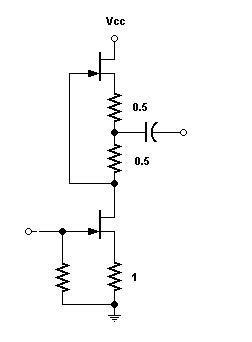

Small parts? We don't need to cloud your mind but, The 550 part I've been thinking would be cool in a X1000 style circuit. A Pass Classic! High current (50-100mA) diff pr. of 550s in folded cascode driving the output stage. 2 stages with the Pass supersymetry! But, I wouldn't ask you to cloud your mind with the http://www.diyaudio.com/forums/pass-labs/99-x100-backengineered-here.html thread
