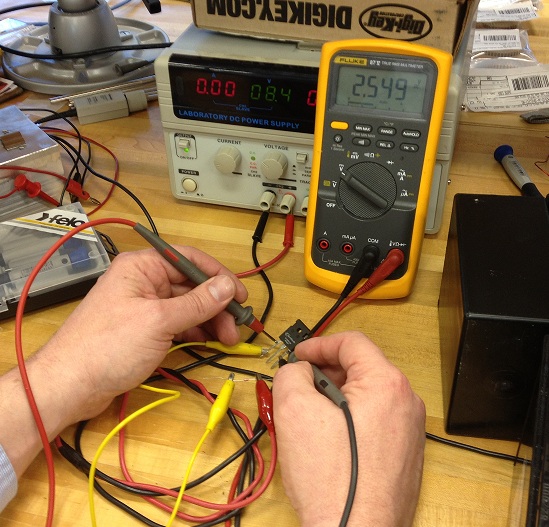

Nevertheless I am very grateful for the article because my DMM measured always nothing and I did not know if I killed one or not... when there was no sound again...
now I can measure with resistors, battery and "billig" DMM following the advice of Semisouthfan these suspect candidates......😀😀
Power supply/battery approach for diode checking
Given the amount of feedback on the DMM approach, I decided to post a picture of me making the same measurement using the power supply approach, this time on a SJEP120R125. In the image you will see my hands probing the gate and source pins of the part and measuring the voltage drop with the Fluke 87. Next to the Fluke is a lab power supply with 8.4 V on the front panel. This simulates nicely a humble 9 V battery which could be used to make the same test. A 2.7 kOhm resistor can be seen suspended by alligator clips between my hands and below the part. The measured forward voltage drop is 2.549 V. I get the same value measured gate to drain for the same power supply voltage and resistor.
The diode checker on this Fluke 87 measured 2.489 V, highlighting what can be seen in the original article, namely, that the forward bias curve of the diode is exponentially rising but still dependent on the exact value of current flowing. The diode checker measured about 7.7 V open circuit voltage.
The bottom line is that diode checkers are not designed for such a high built-in potential. When in doubt, substitute a battery and resistor (a few kiloOhms is perfect) in series with the junction and measure the voltage dropped across the junction.

The short circuit currents all of my DMM's only circa 1 mA, in diode check.
If I compute it correctly, in your very nice setup (which is the peak of the electrical engineering sciences) there is about 2 mA.
Am I right?
Ah, it is only now come in my mind, your Fluke 87 has a 7.7V open circuit voltage, what I supposed earlier.
Am I right?

With respect to the short circuit current, possibly, as it can be an indicator of too low open circuit voltage. Strictly speaking, 1 mA would measure differently by perhaps only a few tens of millivolts. The issue is open-circuit voltage and possibly a threshold condition built into the DMM hardware (speculation). The current available at 2.6 V is much less than 1 mA if the open circuit voltage is around this value. Then the bias current will fall off exponentially and the DMM may shrug it's shoulders (in a manner of speaking) and call it an open circuit.
The short circuit current in my marvel of electrical engineering science is 3.1 mA (8.4 V / 2.7 kOhm). At the measured diode drop of about 2.6 V the bias current was 2.1 mA as you suggest. The difference is that 2.6 V is not a short circuit, but with 8.4 V of open circuit potential, it is not a problem. DMM's commonly have less than about 3 V of open-circuit potential (the designer was expecting 0.7 V or maybe 1 V from an LED). The Fluke 87 is obviously not so limited and while my Fluke 16 worked, the values were more scattered reflecting that it barely had enough open circuit voltage.
