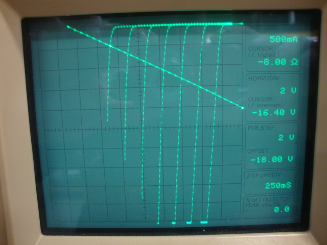

Well buzz, where did that come from? Under what other conditions? It's blurry and there is no legend so I'm gussing what most of it is. Are those Vgs trend lines? Are they -4.8V to -6V w.1V intervals ? I've seen this before I think and even played with the load line possibilties. I think I had a problem similar to you. I have other projects to finsh so I put it away for awhile...
The two images are interesting. "R085" shows the sub- to near-threshold characteristics of the depletion-mode channel design. This gives reason behind the notion that a SemiSouth depletion mode JFET can play the role of a tube and thus benefit from the higher voltage rating of the device. My business partner is an accomplished blues guitar artist and is well acquainted with the musicians love of the tube amplifier. We've been talking about the possibilities. SemiSouth put out a 650 V JFET before the end...
The "depletion jfet" image is interesting too, but if it is from the same R085, don't get too excited. This is what a common-drain (source follower) amplifier imposes on the transistor terminal characteristics. If it came from an R085, the polarity is wrong as this can't happen for positive Vds and positive Id unless Vgd is being stepped. The legend seems to show Vgs is being stepped from a negative bias. Maybe there was just a mix up in connections? Otherwise, if from the same device the two images are mutually exclusive.
Attached is an image taken of the screen of a Tektronix 370B curve tracer measuring one of my R085s with correct polarity when stepping Vgs. (Vds is on the horizontal axis at 2 V per division and is negative, Id is on the vertical axis at 0.5 A per division and also negative, Vgs is stepped in 2 V increments starting from -18 V.) I added an eight Ohm load line using the cursor function of the 370B. You can see the potential for linearity, but this is to be expected from 100% source degeneracy. The negative feedback "straightens" out the non-linearity of the transistor by using the full gain of the device.
The image represents the JFET in reverse conduction, a property of the device under intense study by my research team right now (got no choice, I have to present this research at the PCIM-Europe conference in Nuremberg in May). One caution operating this way in forward conduction by stepping Vgd: You could accidentally overstress the reverse bias on the gate-source diode of the JFET and that is a good way to create a dead JFET.

I'm not sure but, it's time to man up. I honestly thought that graph was BS for some reason but,(it looks to good!). I didn't feel like goin there with buzz or any fellow members. I think I tried to correlate the data sheet with that data and they don't match in the middle somewhere? As I said, I need a curve tracer or gumption to sit down and do it at home myself one data point at a time. We have a broken 4145 at work. I've got exp with that but, I can't fix it, our cal contracter and the Mfg want to much $$$ and I guess the designer guy's don't need it that bad?The "depletion jfet" image is interesting too, but if it is from the same R085, don't get too excited. This is what a common-drain (source follower) amplifier imposes on the transistor terminal characteristics. If it came from an R085, the polarity is wrong as this can't happen for positive Vds and positive Id unless Vgd is being stepped. The legend seems to show Vgs is being stepped from a negative bias. Maybe there was just a mix up in connections? Otherwise, if from the same device the two images are mutually exclusive... 😉
Maybe it's the Absolut Citron Martini's? Got the driveway cleared but, their sayin it's a $500 fine to be on the road still. I don't know? this is a great thread so far, It's worth being snowed in and excersising my brain a little
And (assuming you're talking about the "depletion jfet" graph) it is too good. Any transistor with decent gain will act like that when measured that way (BJT, MOSFET, JFET, whatever). If you speak of the sub-threshold SIT like characteristics in "R085", assume they are not BS and get your curve tracer fixed. 😛I'm not sure but, it's time to man up. I honestly thought that graph was BS for some reason but,(it looks to good!).
