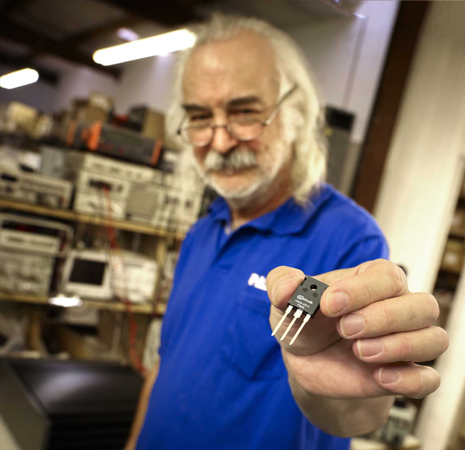

though - you know that , being one of them responsible for bottling 300B+OPT in SSouth dress ......... now , harder part - all you need (or want) is to explain to us , regular Greedy Boyz , how to achieve the same with 2N3055
Ah, yes. The PASS-SIT-1.
Responsible in a, well, distant sort of way. While cleaning out the bilge at SemiSouth, I stumbled on a small handful. We were thinking power switches, not linear gain devices, so at the time my helpers and I didn't know what I was holding and they were lost.
I'll see what I can do about your idea. 🙂
