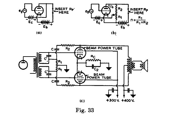

The listing of the four feedback types in Poynt99's post 401 is correct, i.e., they conform with standard texts on the subject. I tip my hat to him for not making us wait on Part III to clear that up.
Two things I might suggest differently:
1. "Schade" feedback is a term I had never heard of until I started reading this forum. When I looked into where the term came from, I was steered to O.H. Schade's 1938 article that Antoinel has done a remarkable job of digesting. So if that paper (which is six years after Harold Black's famous U.S. patent 2,102,671 was filed covering all forms of negative feedback electronic amplifiers) is the source that coined the term, then examination of Figure 33 of Schade's paper (reproduced in this post) shows that his examples all are Shunt-sampled but Series-mixed. Since I called the Shunt-sampled feedback in my F2J (Nelson's design of course) "Schade Feedback" in Part II, and the AC portion of that feedback is Shunt-sampled Shunt-mixed (Schade, as Poynt99 labels it), I will sheepishly stick my neck out, because I feel like I unintentionally provoked this remarkable explosion of posts, and argue that "Schade Feedback," if it should be so called at all, is Shunt-sampled but mixed either way you like it (like a good Martini, which I'm thinking about having after writing this).
2. Any of the four types of feedback, if linear feedback, will reduce distortion pretty much the same as any other. It depends on the amount of feedback (beta*gain). At least that's what the text book says.

To open the discussion up even further, perhaps now is a good time to mention two types of feedback; Local, and Global/Nested.
I think when we speak about Schade and his article, he was dealing with local feedback around the amplification device itself. As such, my findings when examining the differences between Schade fb and the fb obtained using local degeneration (both are local feedback), indicate that the results are quite different. In fact, one clear difference is that degeneration increases Ro, while Schade fb decreases Ro. And as I mentioned before, my tests indicate that Schade feedback does nothing to decrease distortion when comparing with equal output voltage swings into an open load. Degeneration on the other hand does decrease distortion under the same conditions of equal output voltage swing into an open load.
Hello poynt99. Your finding [red in your post] agrees with that of Schade regarding the impact of degeneration; which he mentioned at the bottom of page 363 in his paper. Your mention of the effect by Schade fb and degeneration with load and without it is revealing. The practical value of the no load results is to give a reference or initial conditions to compare with that utilizing usable impedance.

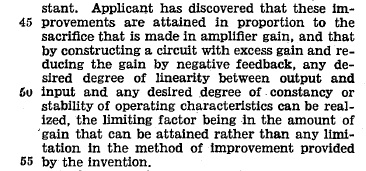

Thanks Dr. Mazzola for highlighting US 2,102,671 which is a reference of 87 pages. Got at PAT2PDF - Free PDF copies of patents: Download and print!.
Harold S. Black has an extensive biography online with a detailed transcript of an interview of his career. Fascinating; this bright scientist also spoke of Bode, Nyquist, Armstrong and his invention of negative feedback. Just search " Biography Harold S. Black". Search likewise for Otto H. Schade. Another interesting scientist with a career, and focus which were different from that of Black. Schade's inverse voltage feedback [e.g. Fig. 33 c in his paper] appeared in the general equivalent schematic of Fig. 1 in Black's patent. Fig. 1 in Black's patent shows negative feedback emanating from the plate of the last vacuum tube [triode] to the grid of the first tube [triode] in the amplifier. Clearly, Fig. 1 of Black's patent will equally apply to negative feedback from the plate to the grid of the same tube which is Schade's inverse-voltage feedback.
Only if the signal is out of phase at the last plate.
And this would be global feedback, not local feedback (quite a different animal), which is what Schade's focus was in his paper.
Antoinel, you must have a deep interest in learning more about negative feedback, as revealed by your deep dives into some challenging literature. I wish all of my students had your motivation.
I'm no patent attorney, but I am inclined to agree with you that the way Black (and his attorney) drew the amplifiers is a brilliant example of what is sometimes called a "blue sky patent." In other words, a patent constructed to cover everything the inventor and his legal advice (with perhaps outstanding help from staff at Bell Labs) could anticipate. I think a reasonable expert would agree that this patent taught a circuit with a single gain device or many gain devices, which would cover local or global negative feedback. It is ironic, given the discussion here on what we have been calling "Schade feedback", namely shunt-sampled shunt-mixed (even though Schade drew shunt-sampled series-mixed), that the shunt-sampled shunt-mixed version of an amplifier with "Schade" feedback is clearly drawn as the first figure in Black's patent.
Anyway, Poynt99's point is well taken that in an arbitrary cascade of gain stages the output and the input (however they are defined) must be out of phase for it to be negative feedback. I think that was obvious to Harold Black.
But what stumps me is why it should be a big deal, this local vs. global thing? A good thing to research some more and include in Part III.

As to the basic relationship between "beta*gain" and distortion reduction irregardless of the type of negative feedback, Harold Black speaks to this in lines 44-55 of page 2 of his patent specification, reproduced below.
As far as I can tell, Harold's assertion is now axiomatic in the electronics engineering educational literature. However, this supposes that the signal who's linearity is being increased is being sampled (directly or indirectly) and compared to the undistorted input by the negative feedback process. If it is not, for example because some other signal is the true "output" as defined by the sampling circuit, then no linearity improvement should be expected. This gets into issues of "observability" etc etc that is covered in the vast literature that now exists and collectively called "modern control theory."
