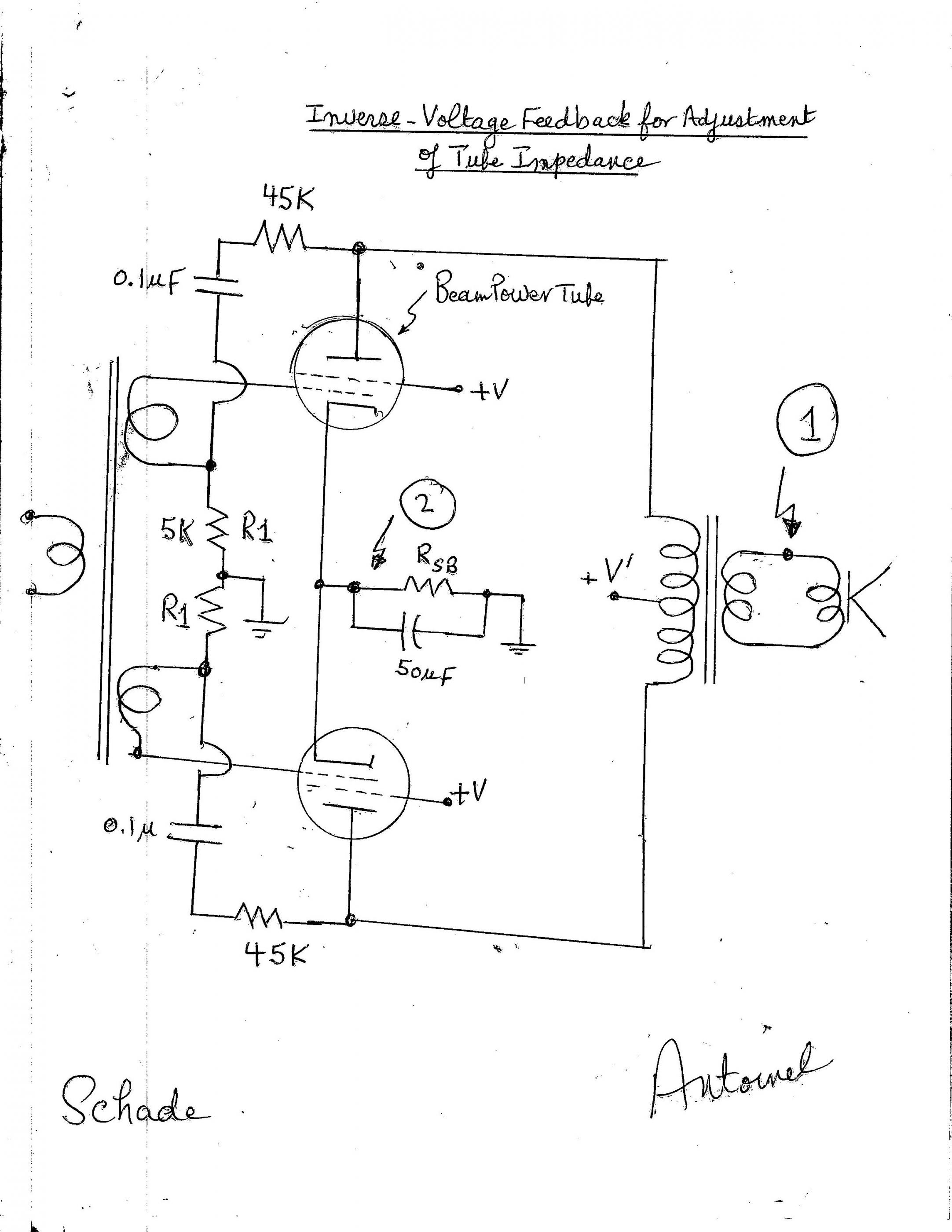

Antoinel,
In today's terms, Schade feedback is called "Parallel Voltage Feedback" (PVF), and is not uncommon. Check out Nelson's Zen amp for a clear example of how it is used with semiconductor amplifiers.
The application of PVF reduces distortion caused by gain changes that result from changes in the load being driven. However, my simulation tests indicate that the difference in distortion between a MOSFET with and without PVF is negligible when the device is driving no load, other than RD.
The distortion-reducing (actually output resistance reducing) mechanism of PVF is quite simple;
1) The SS device output current becomes partially dependent on the output voltage due to the application of PVF.
2) Vin and PVF are average-summed at the input of the device which lowers the device's mu and gm.
3) If Vout is reduced by loading and not by a change in Vin, then this results in a proportionate increase in Vin (due to PVF), and the correct level of Vout is re-established, essentially mimicking a device with lower inherent Ro.
My simple view of Schade Feedback
Schade presented five requirements for an ideal power vacuum tube. They are shown on page 323 in his publication which was entitled "Beam Power Tubes", and provided to us by Zen Mod in a previous post. The 5th requirement of this set is the one most relevant to the subject of feedback. It was : Effective damping of resonant loads. The resonant load is the woofer with specific focus on its impedance below ~100 Hz.
The first 40 pages of Schade's paper articulated the structure-function -performance of triodes, tetrodes and pentodes [tubes] which culminated in the development of his Beam Power Tube [BPT]. BPT was still deficient in its effective damping of resonant loads. He wrote on page 328 this important statement: "It will be shown later that the characteristic [aka requirement #5] of such a tube can be changed into that of a very good low-impedance triode by the use of an inexpensive circuit"
This takes us to the attached schematic which Schade entitled "Circuit with Inverse Voltage for Adjustment of Tube Impedance. It is important to note the objective of Negative Feedback a la Schade which was to lower the internal impedance of BPT so a to derive the benefit or to get the outcome which fulfilled requirement #5.
Schade concluded from his schematic that inverse voltage feedback emanating from nodes #1 [secondary of output transformer], and #2 which is the un-bypassed self-biasing resistor [common cathode] do not reduce the effective plate impedance of BPT; otherwise he would have declared loud an clear.
Inverse or negative voltage feedback from the high impedance node of the tube's plate to its grid via the series 45K and 0.1 uf [10%} met as close as possible the requirement #5.

Zen Mod, and in a later post Dr. Mazzola commented on this particular graph [Figure 35] in Schade's paper. It is actually 2 superimposed graphs of the plate characteristics of 6L6; before and after applying his inverse-voltage feedback.
The plate characteristic of 6L6 before feedback [intrinsic] is shown in Figs. 20 and 21. It is graphically similar to the drain characteristics of SJEP120R100 which appears in the Box entitled What goes up must come down of Dr. Mazzola' paper "What's the Buzz?-Part II. I know this graph represents the performance of a voltage-variable current source [per Pass].
The plate characteristic of 6L6 after using inverse-voltage feedback is shown in Fig. 34 of Schade's paper. It is similar to the plate characteristic of a triode, and graphically that of SIT which was liberally described by Pass and Rothacher. I know this graph represents the performance of a voltage-variable resistor [per Pass]
Schade concluded in this powerful and revealing graph of Fig. 35 that "My special style of inverse-voltage feedback [and no other] created the power amp of Fig 33 (c) which performs like that utilizing power triodes instead of tetrodes".

Sorry, I got the F5 and F6 models mixed up.
The F5 does not have any Schade-style fb. It uses standard "series-shunt" (voltage mixing and voltage sampling) feedback.
The F6 may have Schade fb, depending what is going on with all those coupled inductors shown on the simplified diagram. There is also a voltage fb from the output to the input coils which may also constitute Schade fb.
The CSX1 does not have any feedback at all, other than what might be inherently present within the VFETs themselves.
