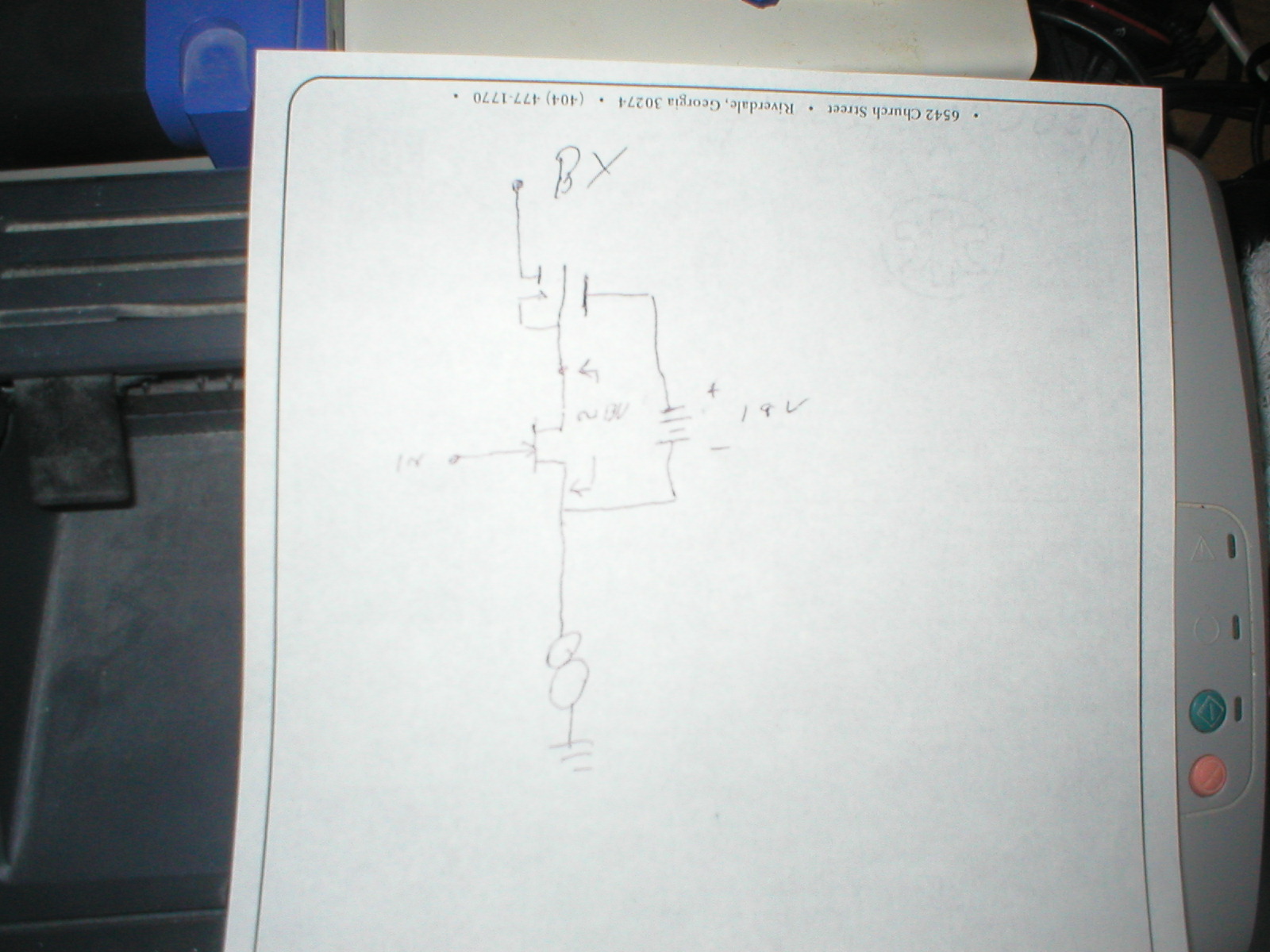

Do these power jfets also have lower distortion when used as a source follower ?
Why I brought this up is using a cascode source follower we could squeeze 200 watts class A from one SJP120r100 true the cascode device will have to be HUGE.
You can get huge cascode devices, or you can parallel some devices with
ballast resistors for current sharing.
Nelson in this type of application would you expect a power Jfet used as a folower to
have significantly lower distortion and used as a follower the input capacitance won't be
a problem to drive ( as you mentioned in your mosfet citation 12 article )
It should also help improve the open loop bandwidth if memory serves me right
Alex
Sent from my C6903 using Tapatalk 2
Alex
I don't expect that there would be any issues. As followers, almost everything
we play with is easily driven from a capacitance standpoint. The rationale
for cascoding the follower is to take dissipation off the part so that you
can bias it at high levels.
Nelson,
I believe you've also noted elsewhere that followers exhibit less distortion if ran under cascode. Is that because of the increased bias current, or lower voltage across the device?
