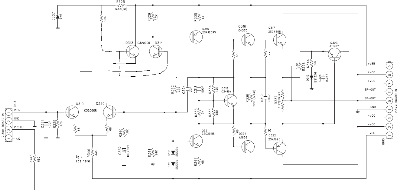

There is an inherent internal resistance or impedance between the plate and the grid; which is a straightforward pathway for an inverse voltage feedback [plate to grid] with a performance value like that from the external one taught by Schade for tetrode.
I wouldn't go so far as to say that it is an internal resistance or impedance between the plate and grid of a triode. Think of it as an interaction of electric fields, and the influences they have on one another.
Remember, the triode has the benefit of a very high input impedance, and that is one benefit that dies a miserable death as soon as we implement Schade fb around a MOSFET using external resistors.
Is this inherent Intra Schade Feedback which gives a triode its characteristic of a voltage variable resistor?
The feedback in a triode results from the influence of the plate's electric field on the grid's electric field. It is this influence (local nfb) that results in the triode's unique characteristic of output curves.

You're both right. Since capacitive reactance is, strictly speaking, an impedance, and because an interaction between the charge on two conductors (plate and grid for example) through a common electric field is how capacitance is defined, then they are the something. It just depends on what level of abstraction you find convenient and that is consistent with the underlying assumptions (i.e., the circuit theory approximation). At audio frequencies either modeling abstraction can be used.
